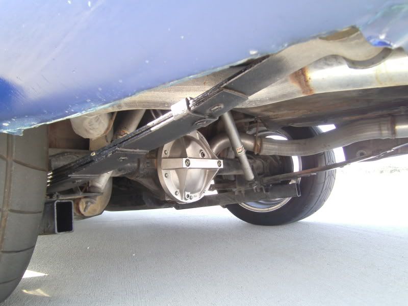

What's the widest rim and tire I could go on my 73camaro without mini tubbing? I have 285 35 18 on a 10" wheel and I know I could fit a 295 for sure but wanted to know if I could get away with a 305?

Do the math based on what you have, that will be the BEST way to determine how much wider you can go. With a 285 how much room do you have to the inboard and outboard side of your wheel well?

315's fit with rolled fender lip
and some "gentle" massaging of the seatbelt hump!!

My 315's fit with no fender rolling or seat belt hump beating. I may be able to go .5" or 1" wider since I relocated my Shocks.
