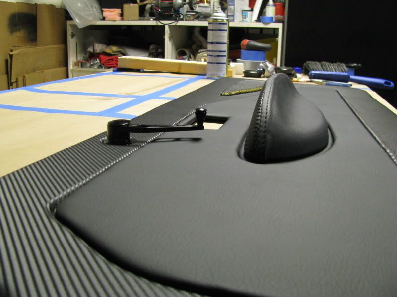

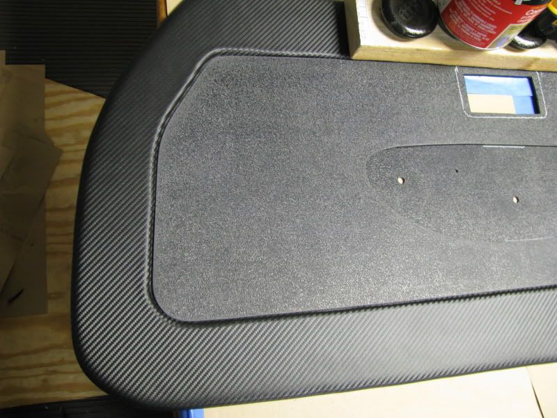

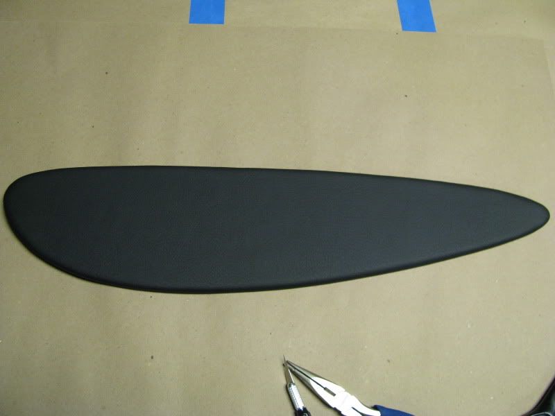

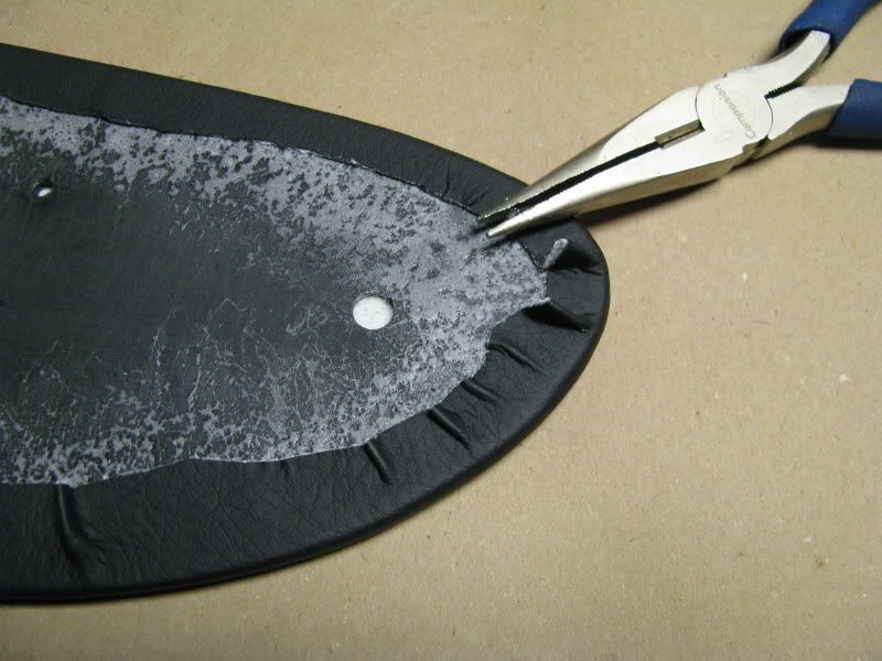

After the front side has been smoothed out of any bubbles or puckers and is nice and flat and you have sprayed the glue for the wrap to the backside of the piece carefully start pulling the material over the edge and smooth out on the back of the panel. Around round edges you will have to pinch the pucker of the extra material to keep the material tight around the edge. After you have gone around the entire perimeter you can go back with sharp scissors and cut off that extra material of those pinched areas so that your panel lays flat. You will see how nice and smooth the flat edges lay.
The finished panel.............
After spending a couple hours putting this build thread together, I realized how many gaps I have in my pictures to support more detailed instruction on how I did this. If you have nay questions at all, just post them up and I will be more than happy to answer them or PM me. I will do my best to answer them all.
Hopefully your project turns out well and you are as happy as I am with the finished product. It's fun to try something like this. The best part is, if you screw it up you can just do it over, you'll be out a couple bucks for new material or foam, but it can all be done over again if need be.

Just one question. I read that you have it totally secured with screws instead of those clips. What piece of the door panel goes on last to cover the screws that mount the door panel to the door? And how does that final piece attach to the door panel?

Last piece installed is the large insert in the middle of the panel and is secured to the main panel with Industrial Velcro
