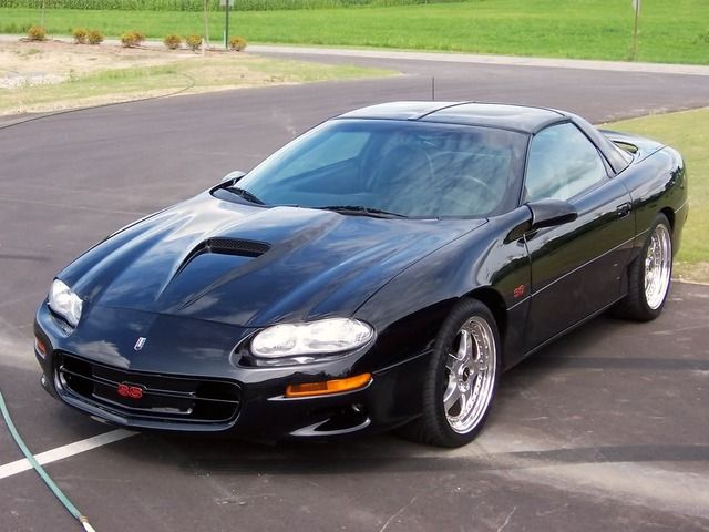

4th gen '01 SS Camaro, 15k on the odometer, black, 6spd, t-tops, leather, etc. Bought the car in '01 with 4k on it, damn near stole it from a dealer in northern Michigan and the affair began....

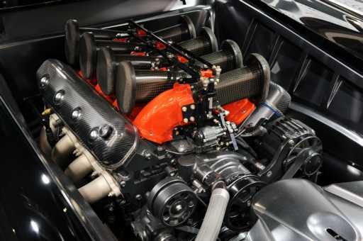

Future intake (at that time....Marcella )

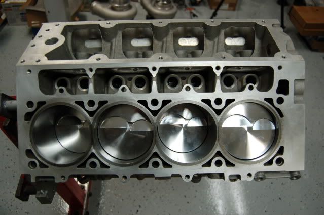

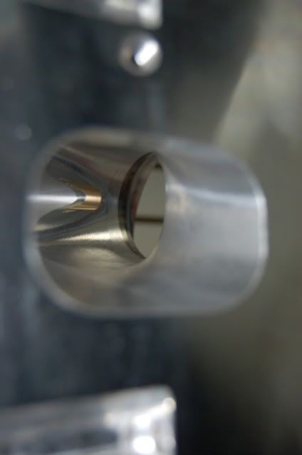

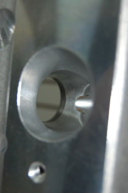

5 months into the Intake build....tbody combo (measuring 120mm ) was not going to work unless this car functioned at idle and WOT.......true to build intent of "street", it wasnt going to work!

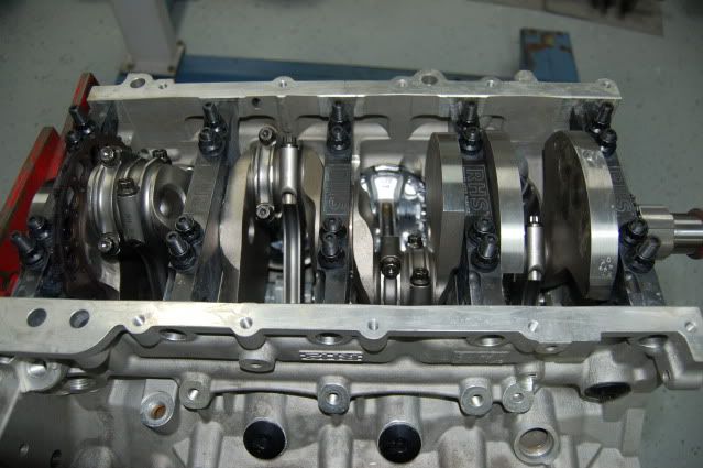

Short block complete topped off with the baddest set of LS heads in existance (thanks Cary)...FYI, Mast C5R heads (1 of 5 sets ever built), Marcella out....who or what could provide the breathing capacity to support these lungs?

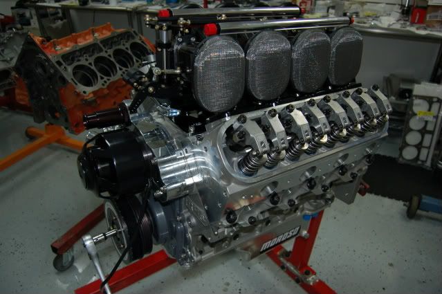

New breathing assist.....Kinsler

So with a combo of TD, JE, Lunati and Callies components topped off with the goodies above, we get this....

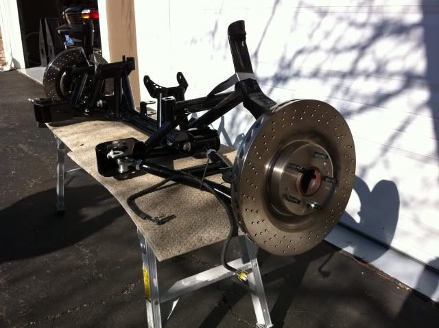

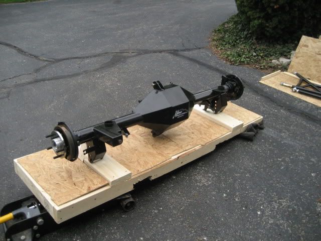

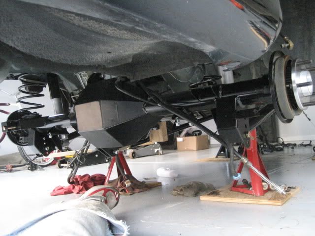

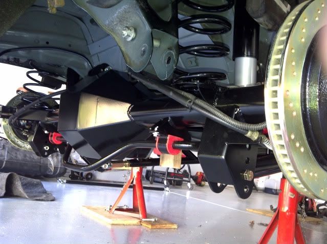

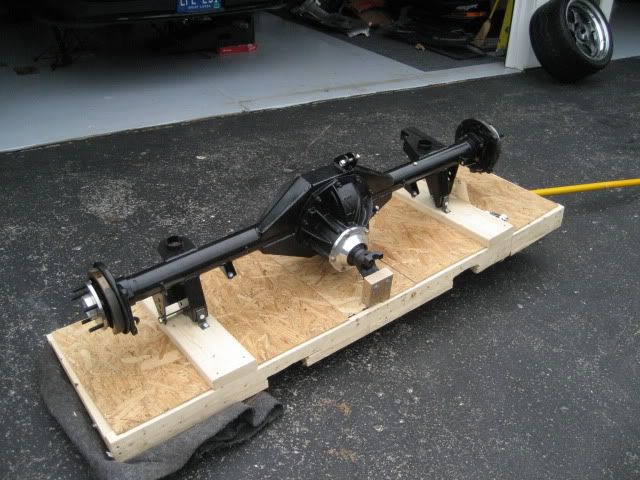

Now the power plant is complete....stock drivetrain will not be sufficient . Wife said, "do it right"......sooooooo. Narrowed (1") Midwest Chassis 9", 3.70 4ch tru trac...
10 bolt out....9" in
Not pictured is the Liberty Gear Viper spec'd T56

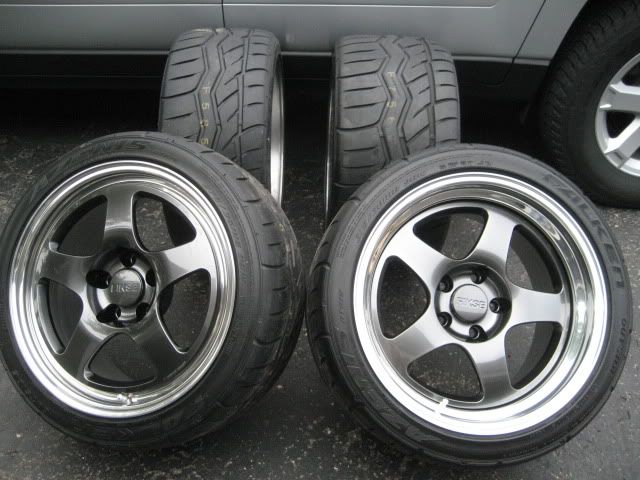

Simmons replaced with Fikse...
18x9.5 and 11

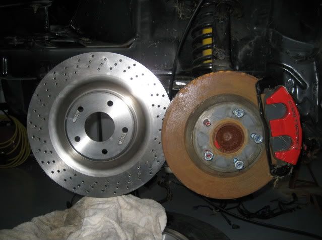

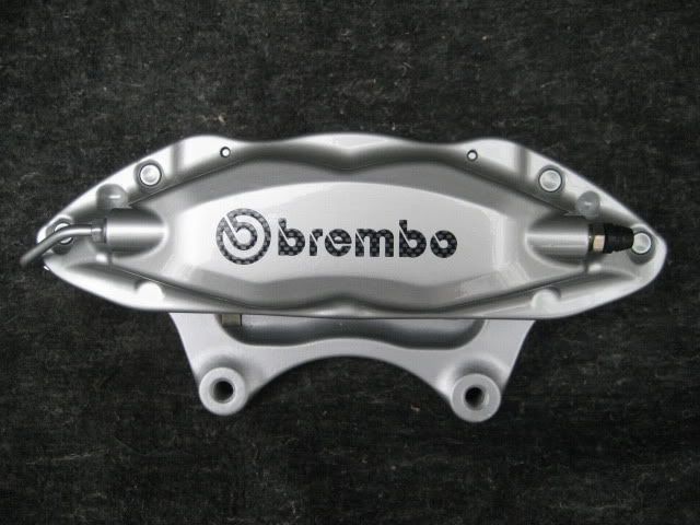

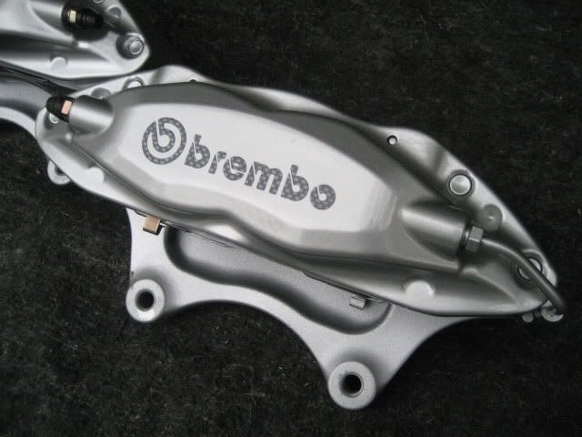

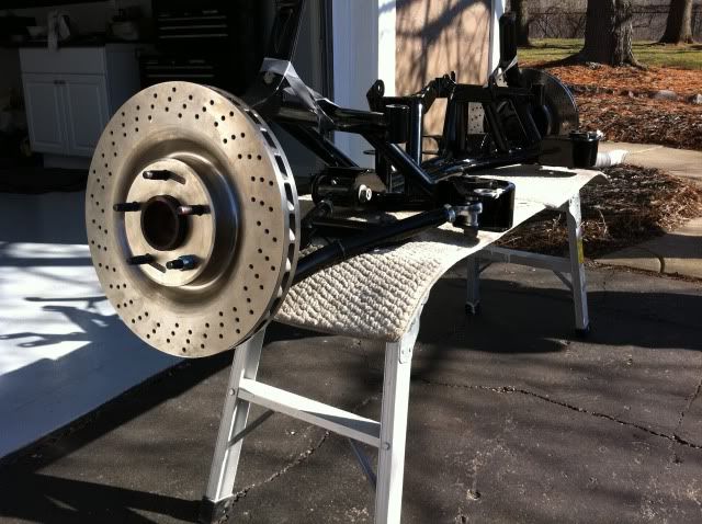

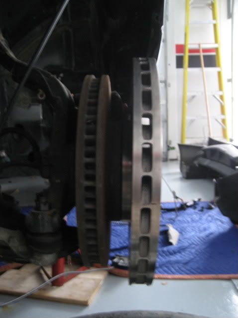

Need to stop, right? 800hp is not going to stop by taking the foot of the pedal. Thanks GM for the CTS-V swap Tweaked of course with CF decals
14" Rotor upgrade...

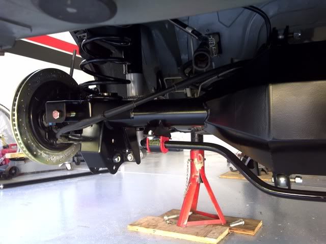

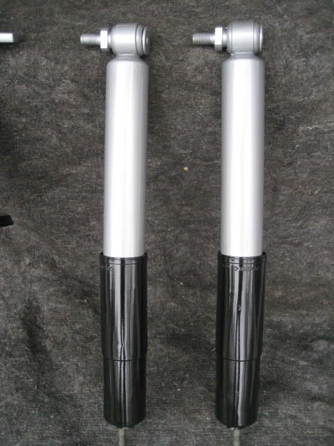

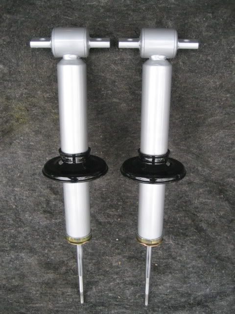

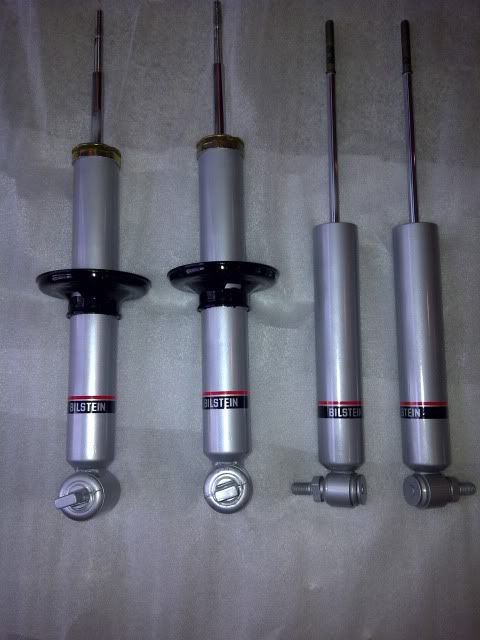

Few more quick suspension highlights. Cleaned up those nasty yellow/blue Bilstein's to fit the "theme".
K-member anyone? Thanks UMI....

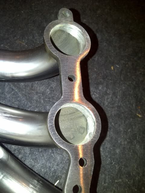

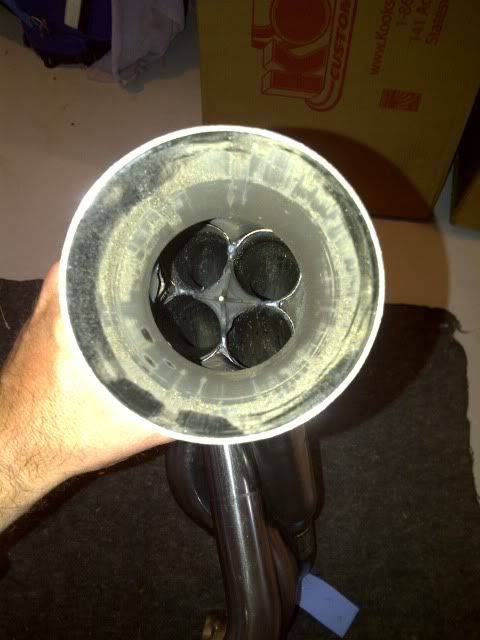

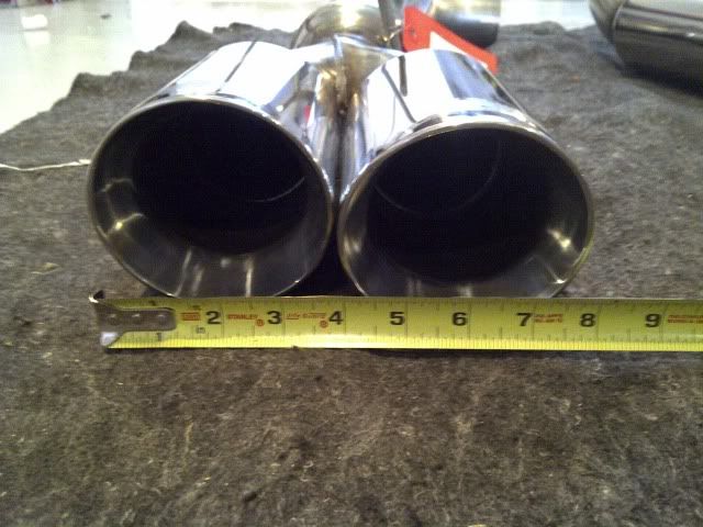

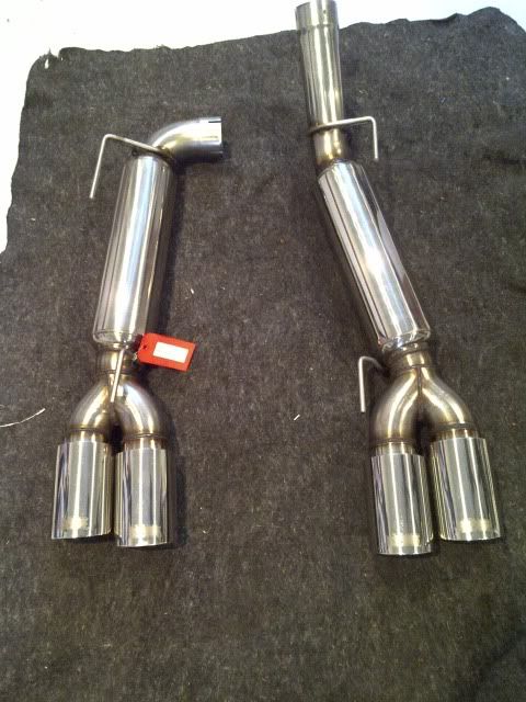

Headers and Exhaust....Kooks 2" with their catted True Dual system! Unbelievable quality....
