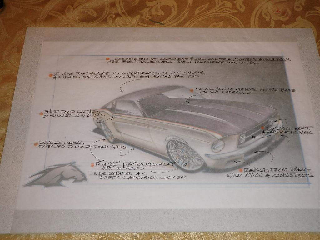

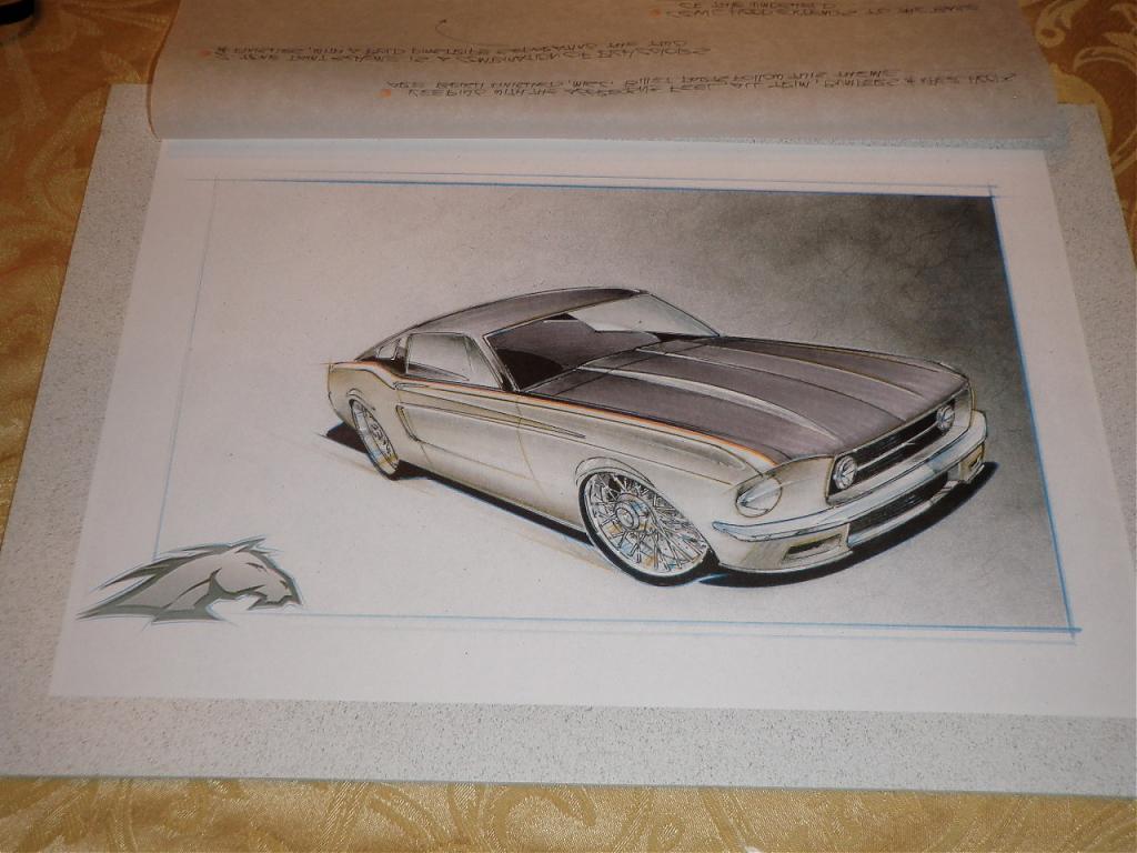

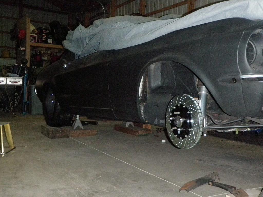

here is my car so far. It's mini tubbed on 275/35/20's and 245/40/18's, air ride air bar, fat man/air ride struts, 14"alcon/roush front, 13" rear, daytons for wheels (i know, people don't like the idea), 306 gt40 crate, tremec 3550, 8" rear. I guess you'd call it a 'slo touring' car. Im ok with that.

Good looking rendering. Can't wait to see how the Daytons turn out.
