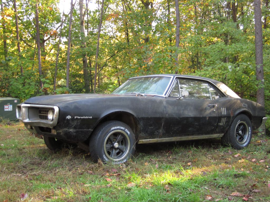

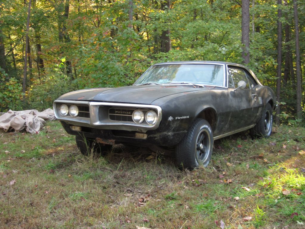

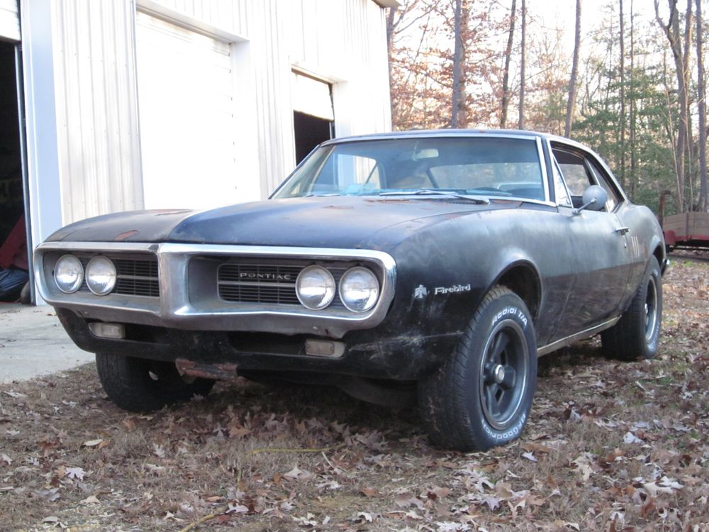

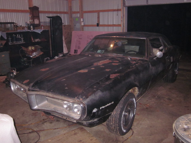

Hi everybody, I'm Mike from Bryans Road, MD. My wife Emily and I recently picked up a 1967 Pontiac Firebird Sprint 6. We are currently planning out how to rebuild it. It is rough, but it is a solid base with a lot of potential. We will be doing all the work ourselves and since we are on a bit of a budget, I have been studying up a lot on the amazing DIY things people have come up with here.
For a theme, we are going to go for a mix of WW2 style bomber (Think flying fortress) or mad max interceptor.
The Firebird currently has a Chevy 350/th350 from a 76 Camaro. 4 wheel manual drum brakes, power steering, Camaro 10 bolt rear, single leaf rear springs. I have been told the springs up front were meant for a big block. 15" Z-28 rims.
I am planning on installing 4 wheel LS1 disc brakes, Hotchkis front and rear springs, Gen III steering box, positraction rear end.
I have been torn about the engine. A Chevy 350 is cheap and easy to work with, but there are so many options. An LS1 on a budget might not be possible, and I have a ton of experience with Pontiac motors, but they are heavy. Since it is a Sprint, I have thought about hunting down a Pontiac OHC 6, or even a GMC 4200 DOHC 6. Both motors have the advantage of saving a good bit of weight, though aftermarket parts are not so easy to come by. I would like to install a 5 speed manual transmission.

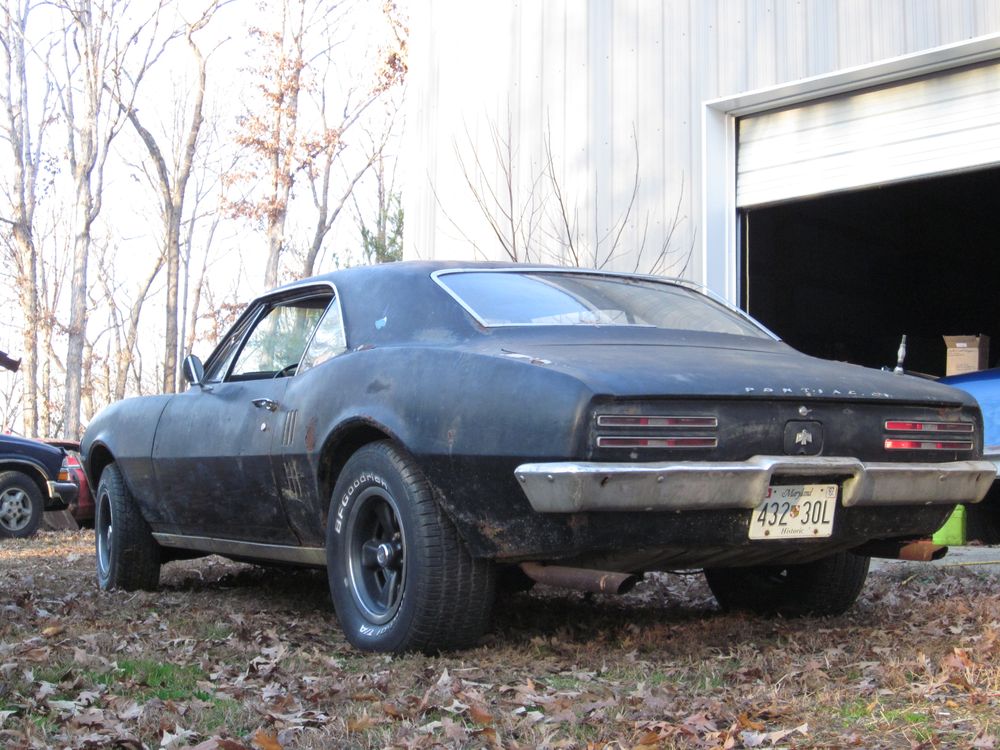

Its very exciting to see so many firebirds on here, and so many great ideas. In keeping with the WW2 I'm thinking of naming the car Bombshell and putting some nose art on it.

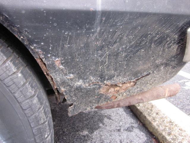

Areas that need to be patched include the floor panels, driver side outer rocker, lower rear and front quarters, and areas around the rear window channel. I also need to replace the driver side door jamb area where the quarter panel meets the rocker. I don't know if they make a patch for that or if I will need to buy an entire quarter.
The biggest issue I found is a crack in both rear frames directly above the rear end. Neither frame is rusted, so I am not sure if the best plan is to weld the cracks, section the frames with new pieces, or get oversized patches to weld over the origionals? I have no idea how a frame cracks the way these both did. I have not found any evidence the car was involved in any kind of accident.
Areas that need to be replaced include the front passenger fender extension, passenger front wheel well, and I might just do an entire floorboard replacement.

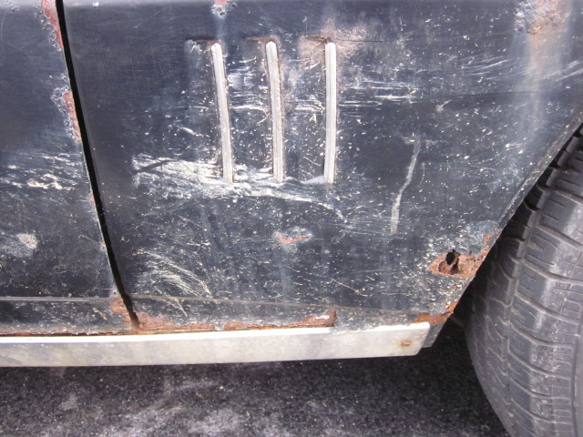

Default Photos - Drivers side door to quarter area.

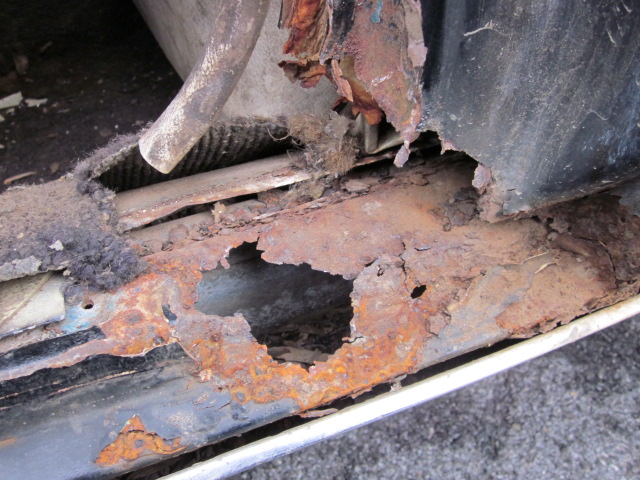

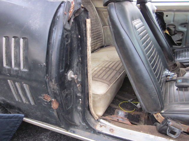

I believe this is going to be the most difficult repair on the firebird. I have no idea how the inner support structure looks, but I have a feeling its probably pretty torn up as well. First I need to remove the outer rocker pannel.
Does anybody know if you can get this section of the quarter pannel without buying the complete quarter? I want to save as much factory metal as possible

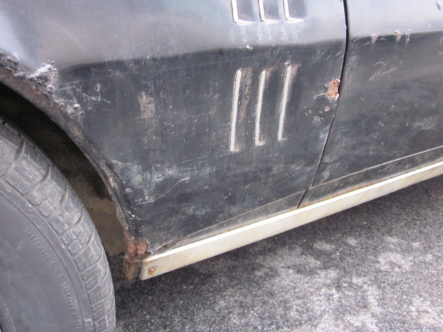

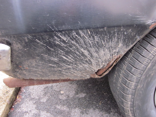

Default Photos - Passenger Side Quarter Rust
This area does not appear as bad as the driver side. I am going to go with patch pannels, and probably outer wheel wells. Of course until I start tearing Bombshell up I won't know for sure. from here it looks like the Outer Rocker is ok as well. If you look at some of these photos real close you can see the original blue peaking out. At first I thought there was a ton of bondo in spots, but now I am seeing its actually 4 or 5 layers of paint. A whole lotta paint. Like a paint cake.
