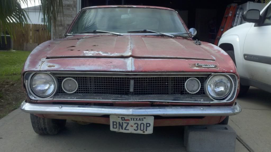

hey everyone my name is Chris im from Sugarland, TX.
Im starting a project its a 67 camaro im a Novice at best when it comes to restoring a car so any advice would be appreciated. Right now im in the process of tearing down the car
My goal at the moment is to tear down the car and get in to media blasting.

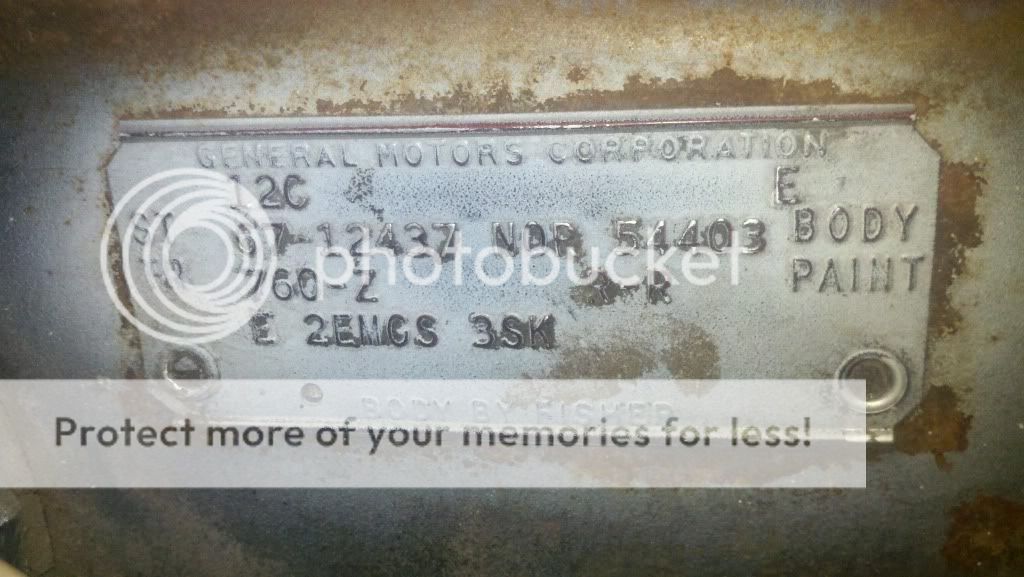

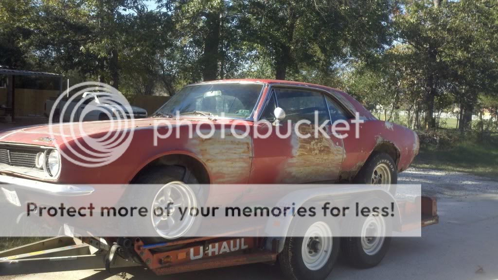

Right now im not sure on motor and trans it has a 350 and a power glide trans. I do know i want an upgraded suspension and want to tub it out. As far as I can tell right now it needs sheet metal(full quater pannels,roof,rear end,front end,door skins,hood.)
can anybody decode this for me

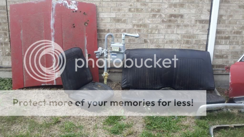

i have two front seats and th400 transmission if you need some parts.

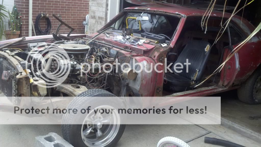

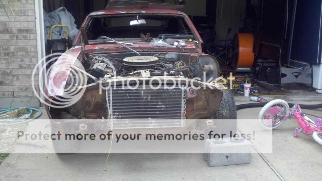

Its been slow with christmas around the corner i have the car nearly stripped down all i need to do is pull motor and trans. The question i had to get it ready for media blast is,should i leave the sub frame on so i can roll it or do i ned to take it off
http://www.camaros.org/
build date: 3rd week Dec 1966
production day: 5th
body style code: standard interior coupe
assembly plant code: Norwood, Ohio factory
interior trim code: black interior with standard A50 Strato Bucket seats (no headrest)
exterior paint code: Bolero red (no stripe)
body related options code: tinted all glass; air conditioning; power glide automatic; front compartment console; manual antenna; Z23 interior decor group and Z21 exterior molding group
I think I got that all right.
Bryan
