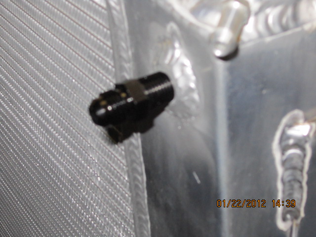

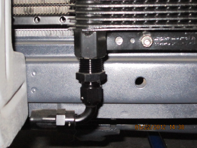

Anyone here familiar with -an fittings. I'm sure they are. Please chime in. On my B&M trans cooler, I can only engage 3 threads of the 1/2" NPT to -6an fitting. That is only hand tight. Will they tighten up more with a wrench and not damage anything? Also, the trans cooler on the radiator is only allowing me to engage 1 thread of the 1/4" to -6an fitting, again only by hand. Will it too tighten up more with a wrench? Or do I need to go to a different size fittings for the trans coolers? The B&M cooler is too large, though, for a 3/8 NPT fitting. Already tried. I don't have an 1/8" npt fitting here to check the cooler on the radiator.

A couple things come to mind -- #1 never try to put two fittings together without some kind of teflon sealant. I prefer the "liquid" paste over the tape...
These fittings will GALL and you might put them together - but coming apart you'll strip out every thread and the part will be unusable.
If you can only engage one thread -- you have a thread mis-match there somewhere...
PIPE THREAD DIAMETER = measure the diameter -- and DEDUCT 1/4" -- so a 1/2 Pipe will measure 3/4" -- minus the 1/4 brings you to "1/2 pipe"...
If the diameter is 3/8" -- then the size is called 1/8 and so on.
The threads in the radiator might be for a double flare fitting... so look inside the "hole" and see if there is just a hole -- or is there a "mound" for a flare fitting to seat against... if so - that's a whole different thread pitch etc.

I thought about the fitting at the radiator being a different thread pitch. So, if it is, would I need an inverted flare fitting there? As for the fitting on the B&M cooler, I'm still left wondering why only three threads will engage.

Just checked the fitting on the radiator. There is a mound inside the hole, so it is a flare fitting. Thanks for pointing that out to me

NPT is National Pipe Thread
Its cut with a taper, that way it pressure fits the connection. 3 threads is about normal it will go in more with a thread sealer paste (don't use Teflon tape please) there is no real lubricating property in tapes
on the 1/4 one it sounds like there are 2 different thread pitches, don't force it, make sure its a 1/4-20 or a AN, a flair or even metric

the 1/4" fitting I have is a 1/4" NPT to -6an fitting. Only one thread will start, so I have not tried to force it. I know this fitting does not fit the trans mount cooler. The question is, what freaking fitting fits it? I am digging through the mail-order places and not finding anything. What is everyone using there?

Depends on what your female is.... and nobody can see that from your pictures - and even then we'd be guessing. If you have a inverted flare then it's going to take an inverted flare fitting -- not a NPT fitting.
Most likely your radiator trans cooler takes a 5/16" HARD LINE... with a 45* double inverted flare... so if you're going to try to convert that to a -6 AN - you're going to have to figure out what it SHOULD take and then try to find a conversion fitting.
