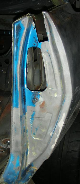

Can some take a photo of their 68 Camaro quarter panel astro vent hole?

This is a 68 driver side, hope this helps. If not let me know and I can take a pic and post a 67 jamb because I have 67 full quarters.

Thanks for the photo it answered alot of questions.
