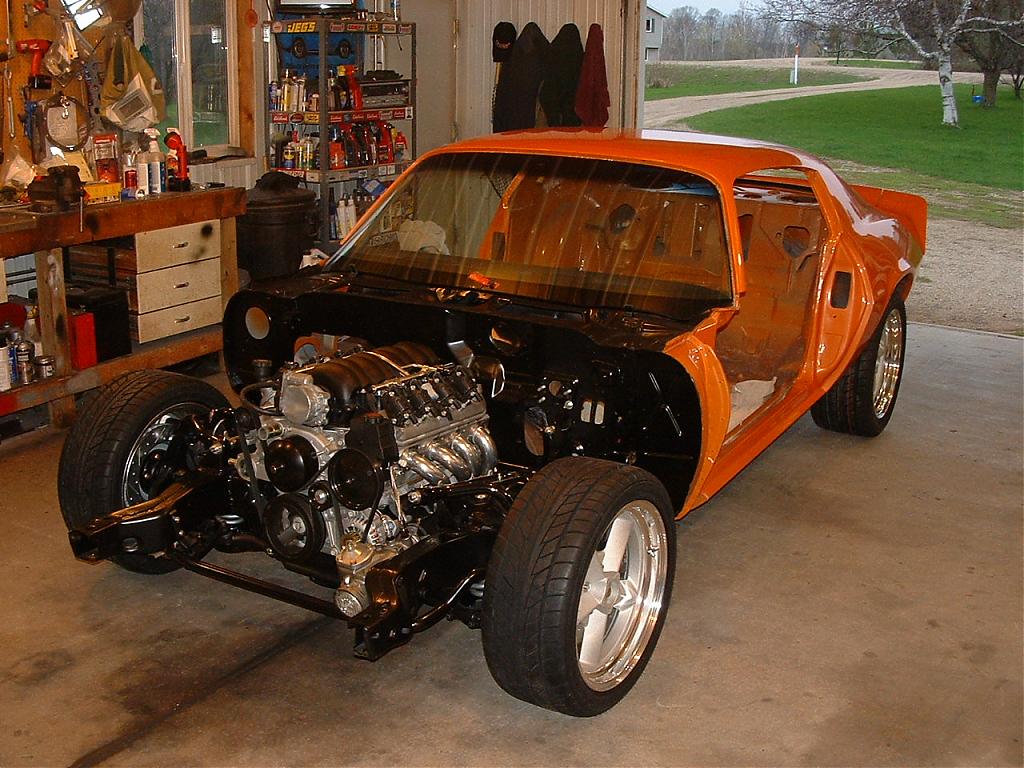

On my 73 Camaro L92/TKO 600 swap I have 1 7/8" dyna techs. Fit is good. My engine is 1" back from stock. They may be a bit low for ground clearance. I shuold have some pics soon with the car on the ground at ride height.
WOW your car looks great! Thanks for the help. do you ave a build thread on that somewhere or more pics you could share? I would love to see how the headers look after you get it on the ground or at least shooting in at the frame.

The car is up on blocks as I put on the sheet metal and bleed the brakes. I will take a couples of shots of the header clearance. I made my engine plates and just redrilled the subframe for the one inch set back.
Pic of the left side header and clutch cross shaft.
No build thread.
