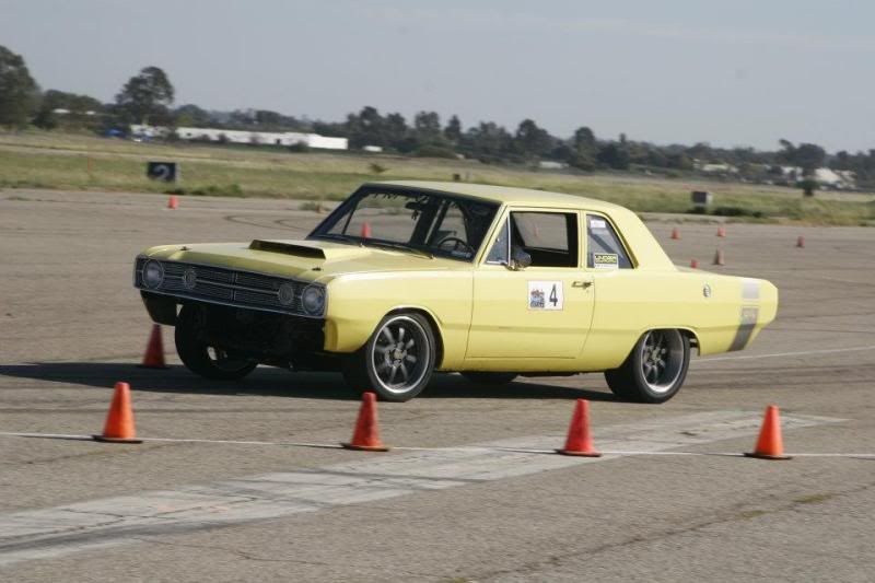

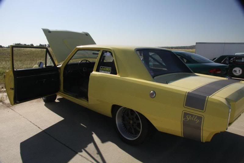

I know how much everyone here loves to see projects and how they are coming along. Well I think that this car is far enough along to let the cat out of the bag.

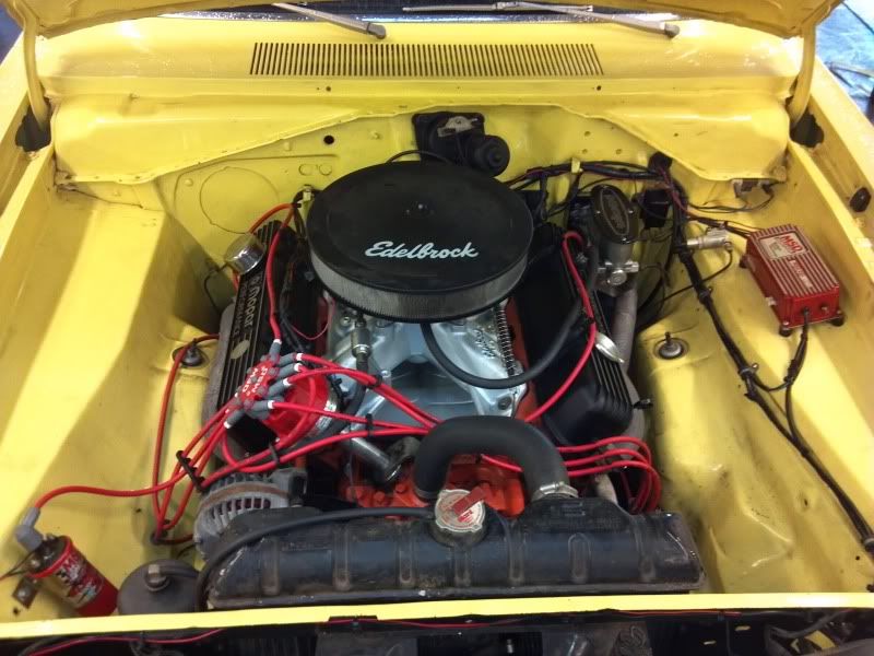

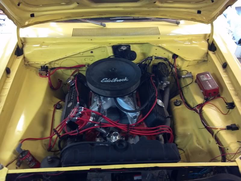

The car is name "Sally the Banana Dart" by the owner, for sentimental reasons and because of the odd yellow of the car. He purchased it last year, with the need of having a Hot Rod of some sort. The first changes we made to the car after purchase were Wilwood front binders, Moser 8.75 rear end with locker) full MSD ignition, and some basic ascetic upgrades to keep him looking cool.

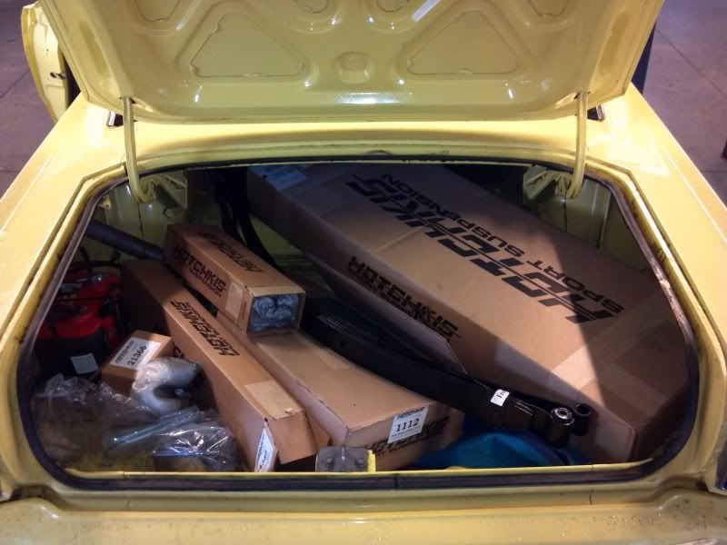

Unfortunately the Winter Mod Bug bit him HARD. Sally came back before Christmas with a trunk full of parts and a driver full of hopes and dreams.

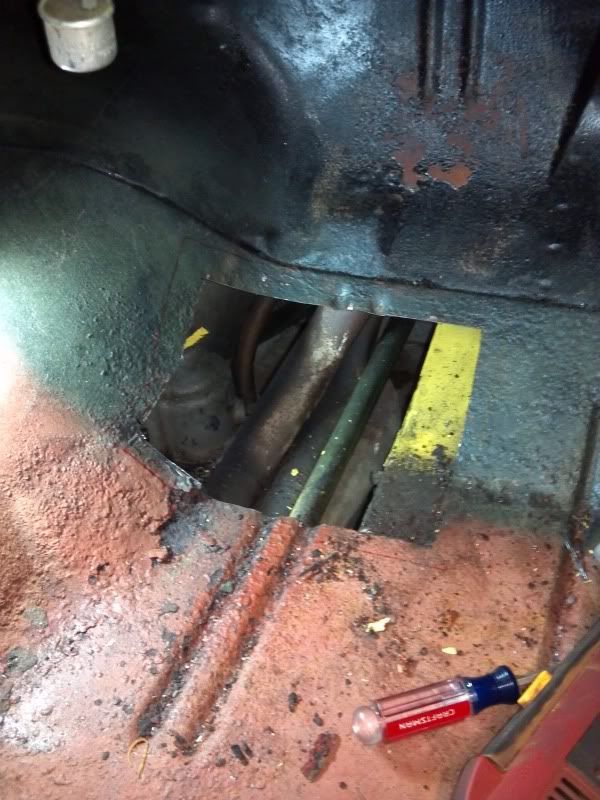

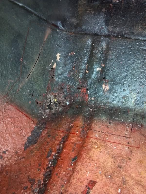

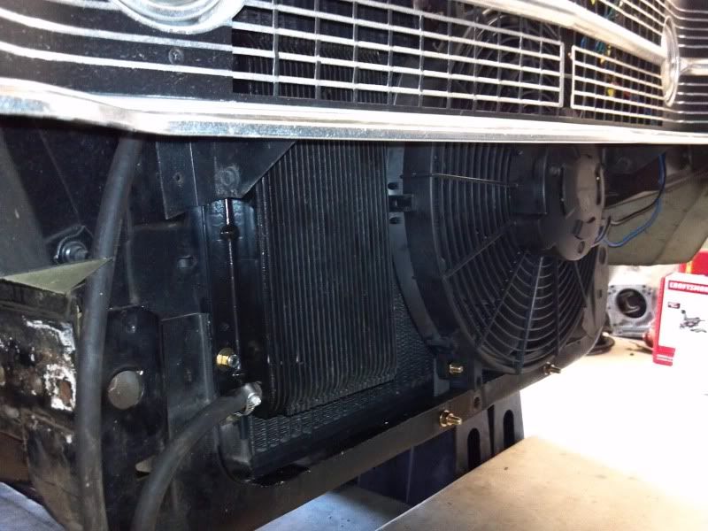

We found some discouraging things along the way.....

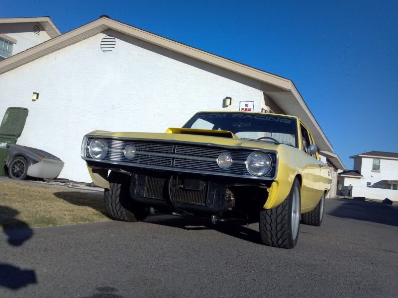

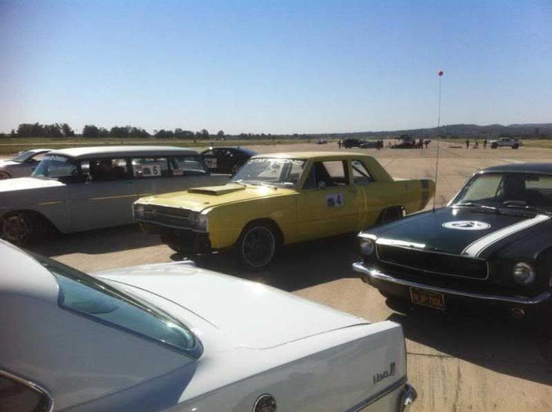

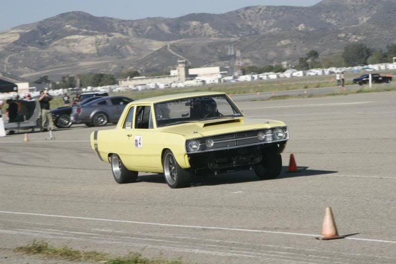

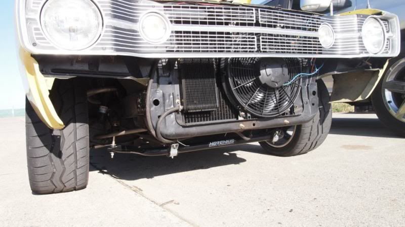

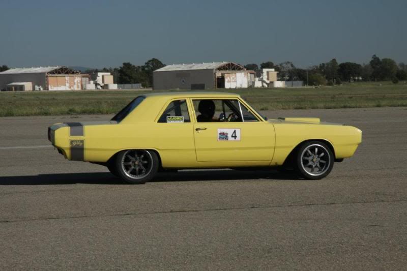

But we got the car fitted with a complete Hotchkis TVS and some loner wheels and tires so the owner could take full advantage of our driver initiation services, never having owned a 450hp Big Block car that weighs 3200lbs. So this last weekend we went out to the autocross for some shake downs to better plan our next modifications and learn some basics.

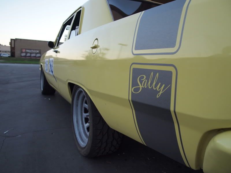

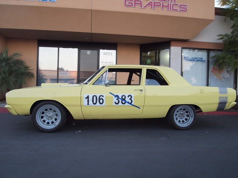

Since then, we've added some graphics to add some "flair" (no requirement on number of pieces).

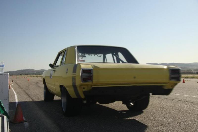

So to bring us up to date, we've lowered the rear another 2 inches, and ordered parts to get her all ready for RTTC3.

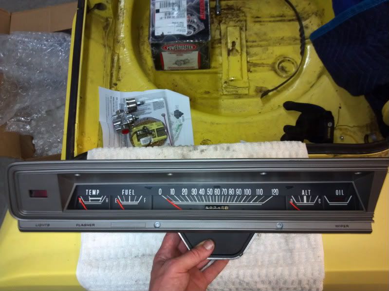

-Gauges

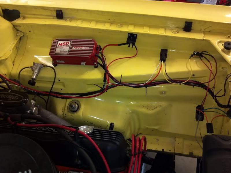

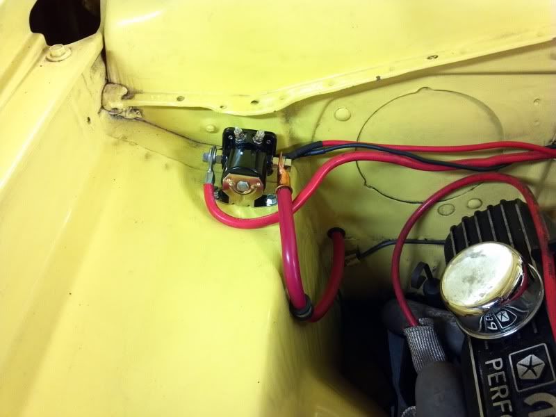

-Updating and re-wiring the entire under-dash area.

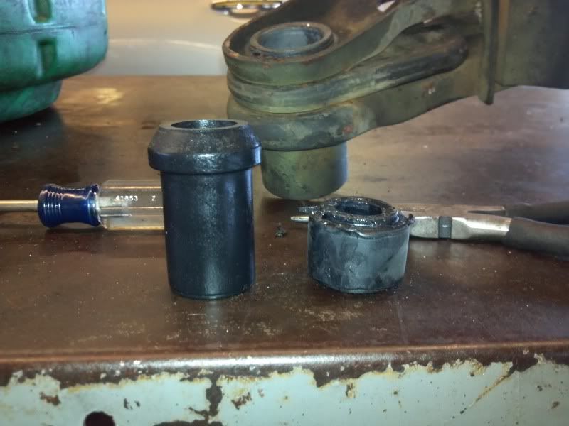

in case you have not experienced it, urethane lower control arm bushings on a Mopar do not properly retain the lower control arm. The pin will float around inside the bushing allowing the arm to move front to rear. If you don't believe it, just put the car in the air and then pry back and forth on the arm near the bushing. This is a problem that everyone seems to ignore and never mention. The factory original rubber bushing retains the arm much better.
Old 02-08-2012, 06:42 AM
DTM Racing DTM Racing is offline
Join Date: Feb 2012
Posts: 76
In the cars that I've done, I've never seen it to be an issue. once the arm is locked in place by the retaining nut, struts and torsion bar, any slop is removed. I've taken them off vehicles with 12,000 miles and still as tight as the day they went in. Is it possible that the "looseness" is actually coming from the pin hole in the K-member? I've had to reweld several of those because they come detached inside the k-member.
