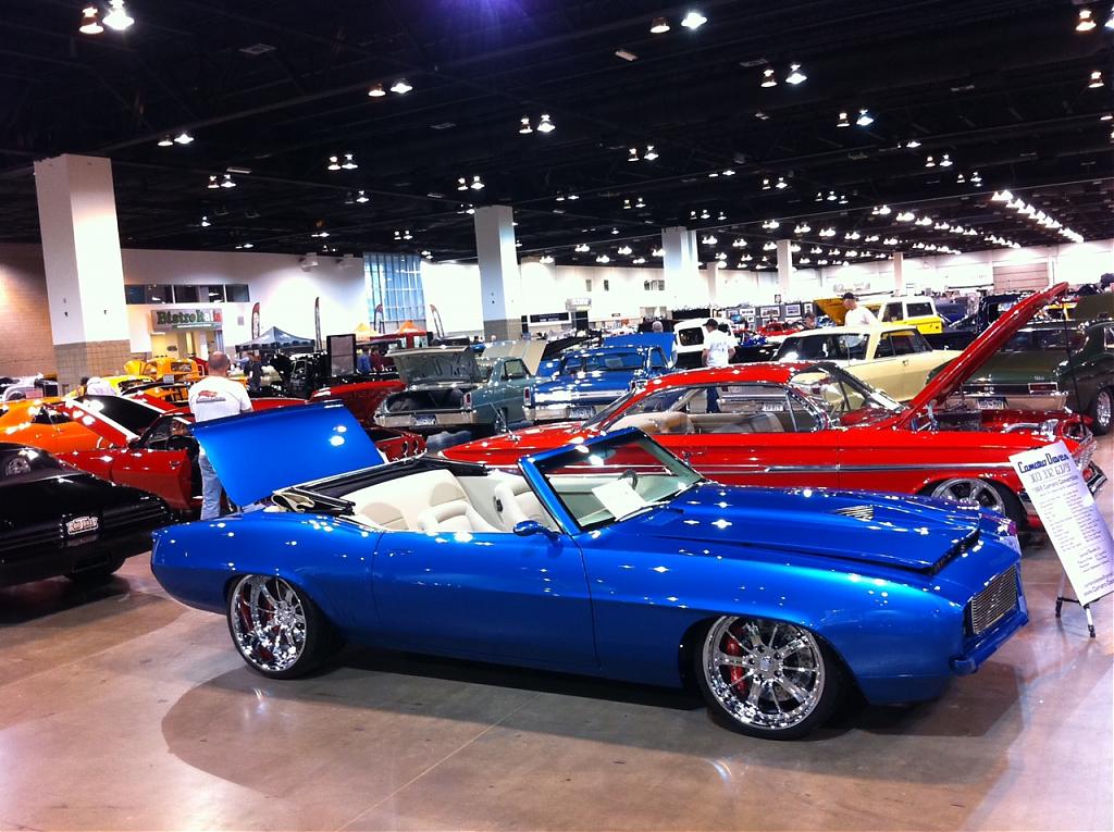

Thank you Kirk for the kind words , it was a pleasure meeting you and talking shop/cars!
here is a pic of my 69 vert Camaro ..... I plan to start posting pictures of the build from start to finish on here asap

What shade of blue is that? It's beautiful

thank you , its 2009 corvette jetstream blue
