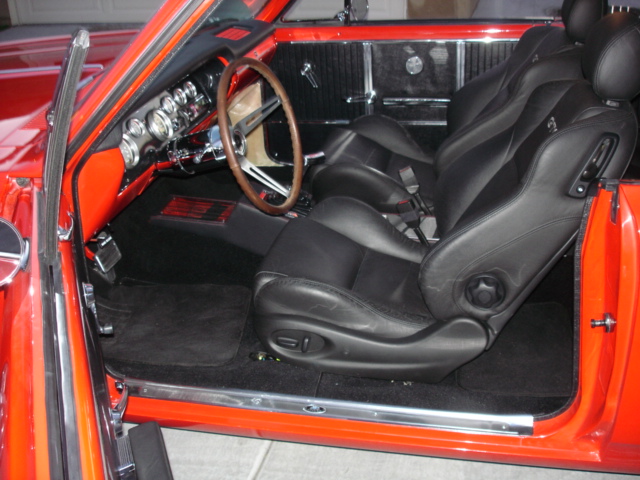

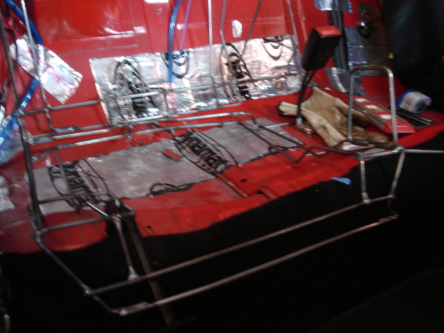

I did my 64 chevelle a while back so Ill try to recall specifics. like you mentioned the fronts are no problem you may just need to cut original mounting points so that they sit flat and use some square tubing if need to shim it / level it.
as for the rears I do recall needing to take off covers and cut the structure to fit your car. I also cut the center piece in two to spread them out . they were a bit narrow for my chevelle. and build a new center section if needed
