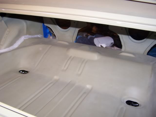

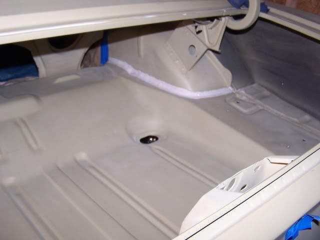

Right now it has green 2 part epoxy on it. I touched up the inside of quarter panels with the under coating/sound deadener that Mike gave me. He got a little over spray on them so I did it before the spatter paint. I also made some holes to mount the DSE battery hold down and a kill switch so I touched up all the edges with Epoxy primer to prevent rust. I had the door open when I sprayed the under coating but its strong stuff my heart is pounding. Mama yelled at me for no mask (she's right but I can''t admit it to her. ) then said I better not kick of in my sleep or she'll roll me down the stairs and out the door to the curb! Aint love grand.
Here are a few pictures from tonight.
Here's the quarter before coating them.
And After
And one of the trunk scuffed and done with the tack rag.
Tomorrow I'll warm the garage to 75 kill the heat and spray the spatter paint then the clear when its ready for it.
