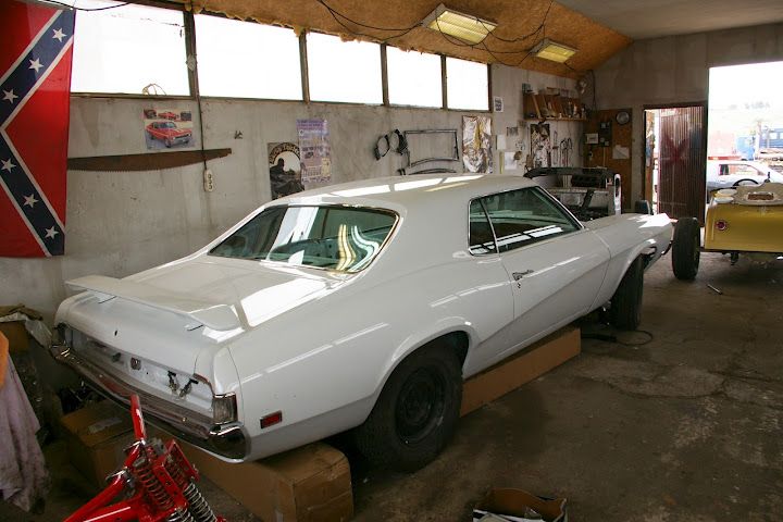

Here is a link to the pics

The car looks pretty nice. You can't stop in and not give us some more details. Are you going to do black Eliminator stripes?
