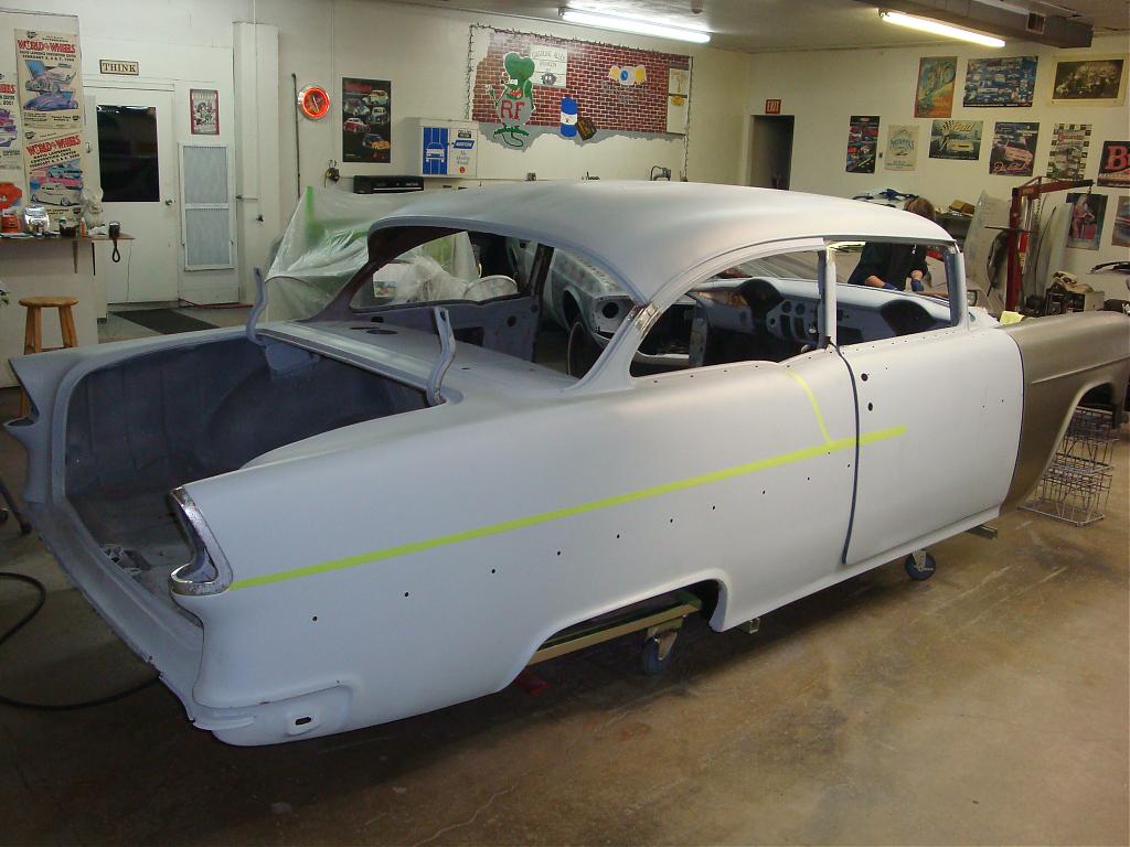

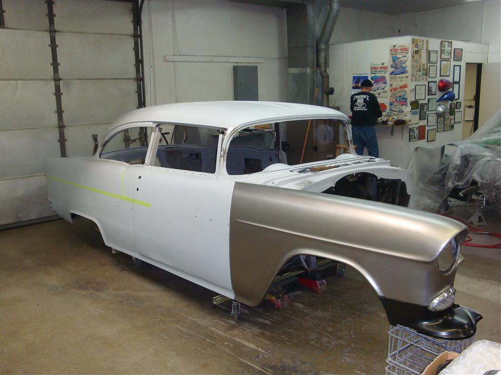

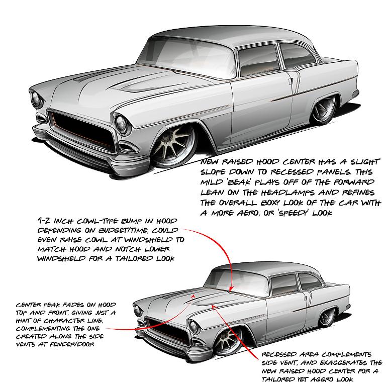

Here are some pics when the roof got the surgery done to it. We wanted to get a wedge design with the front A pillar chopped and then the B pillar leaned forward. Also attached is another great drawing from Brian from PK Studios. He has played a critical role in the build with his awesome drawings.

I think thats a 1st on a 55 to lean the B pillar. Very nice!
