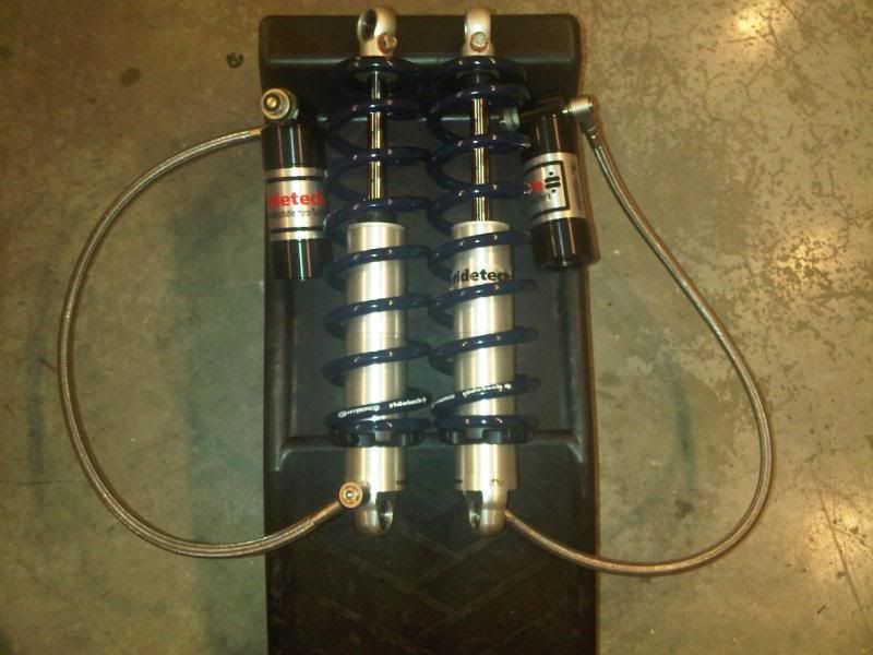

Golden Pilot,
You may have a Ridtech Airbar or you may have a Chassisworks gBar. Frank sells both versions.
If your suspension looks like the one below I may be able to help you. If so, give me a call at the number below. Ext 247.

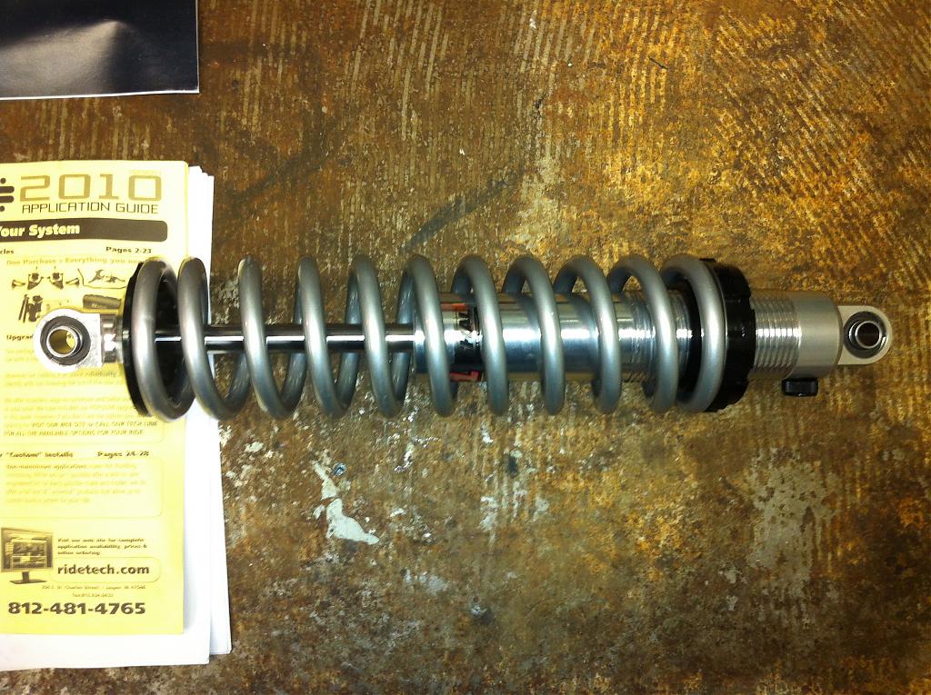

Thanks guys I did call Ridetech about a month ago but they said they don't deal with QA1 shocks and couldn't help me. It's the Ridetech airbar that I have. The top bushing which is 1/2" fits the bolt but slides back and forth so it needs spacers or a wider bushing and the bottom bushing which is 1/2" needs to be I believe 5/8 to fit the bottom bolt and possibly spacers but I'm not sure.

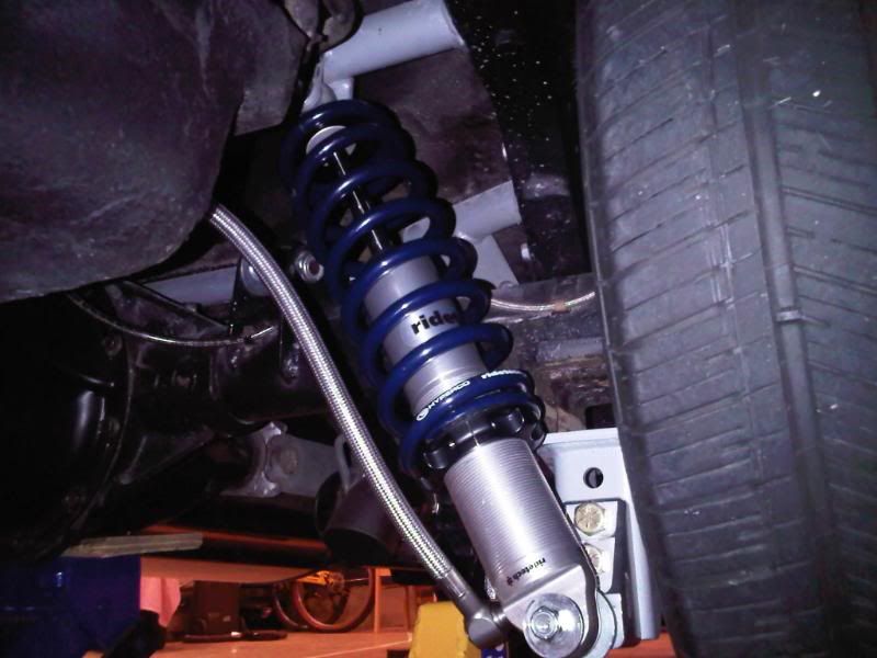

The lower stud in the image is 5/8".
Here's the lowdown on an AirBar:
Upper Mount: 1/2" double shear mount; 1.25" wide
Lower Mount: 5/8" single shear mount; 1.25" wide (1.375" wide without washers)
NOTE: Minimum diameter for single shear mount is 5/8" on loaded applications!
It appears as though the QA1 shocks you have use a 1/2" ID bearing X 1.0" wide.
Our coil overs and Shockwaves use a bearing with a standard 1.0" OD and a 5/8" ID. We then use spacers /adapters to match the mounting hardware and match the almost industry standard 1.25" mounting width.
To do this correctly you need to purchase bearings and spacers from us.
Bearing (if your shocks use a 1" bearing bore):
http://www.ridetech.com/store/index....roducts.search
Spacers:
