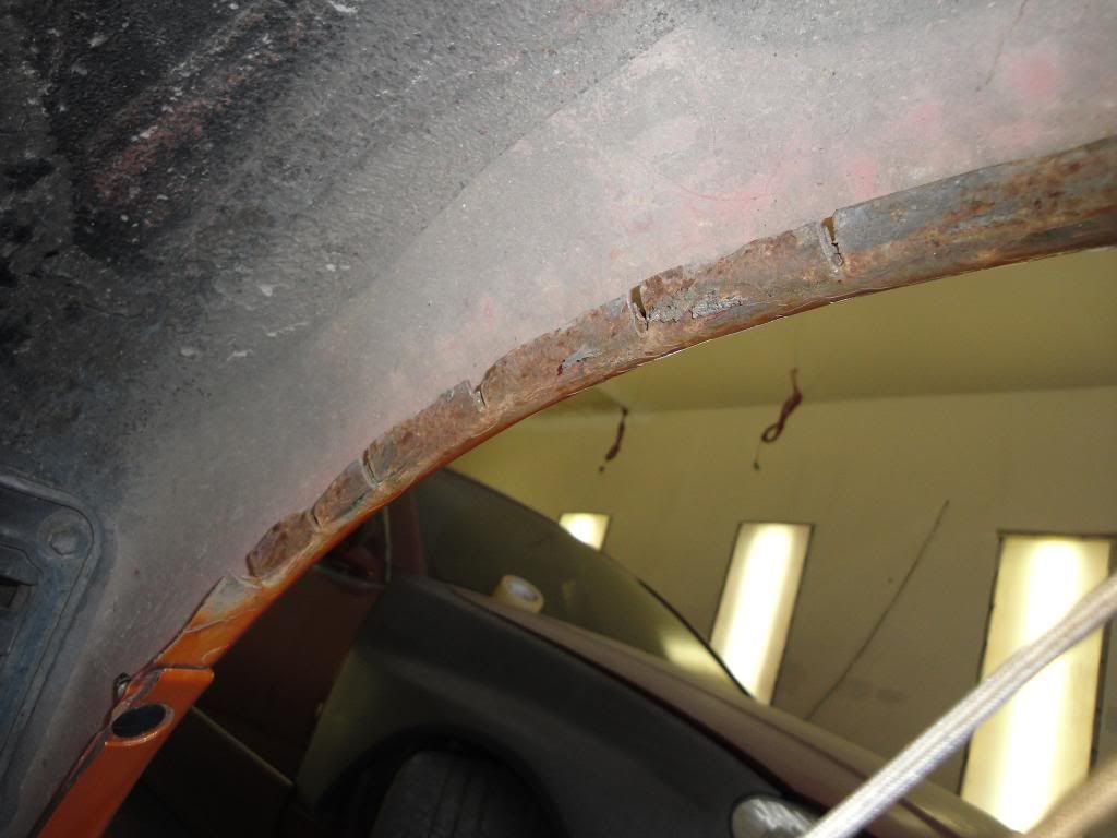

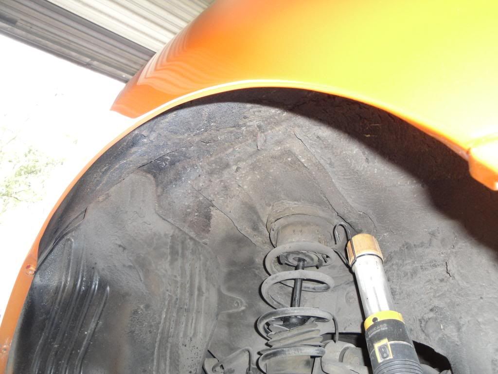

Whatever you do, do not cut slits. All you're going to do is make a mess .Trust me, I've done a quite a few fender rolls and have seen it all. As long as the rear end is bolted in with axles,Eastwood roller will fold that lip,no matter how strong you think it is.I've had to push out quarters almost 1.5 inches with a roller to clear the tires on some cars
Here are couple pics of a hack job I had to deal with
And here is a pic after all that mess was cleaned up

did you weld up the relieve slits back up? or just cut the lips?
you cant tell from that pic.

I cut all of that hacked mess off, feathered the paint ,primed and spot painted the lip. Obviously that is not F-body,I work on a lot of MKIV Supras, the lip can be cut completely flush without the risk of separating even with few subs in the trunk.
