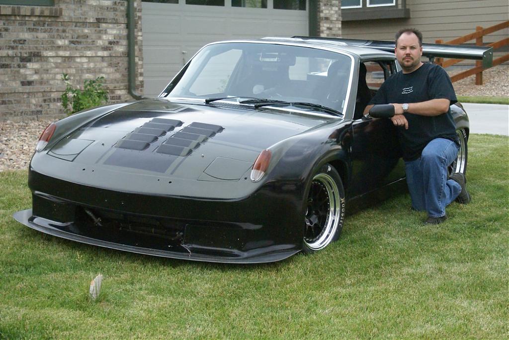

Tom - that wagon is SWEET. very cool project. And I agree with Steve, thanks for the great links! I am stoked right now, getting really lucky:
E = sheetmetal color is black = what I would want
765 = black bucket seats = stoked, exactly what I had hoped for
H-H = now this is really awesome as I love Willow Green. It is all black now but I intended to copy the paint scheme on my 914 onto this car as I love black with dark or camo green like I have attached here!! I can use Willow Green on the top half with a satin finish, following the upper body line like I did on the 914 (and the standard split line on a 66-67), and then use satin black on the bottom with black interior and have an essentially all stock, factory original paint scheme on the car. My Friday just got a whole lot brighter!
Will use the tires and wheels off the 914, all that. I am kneeling to show how low that car is - around 3.5" ground clearance - and I intend to get the same ground height and stance with the Nova, it will be a bit taller overall of course.
