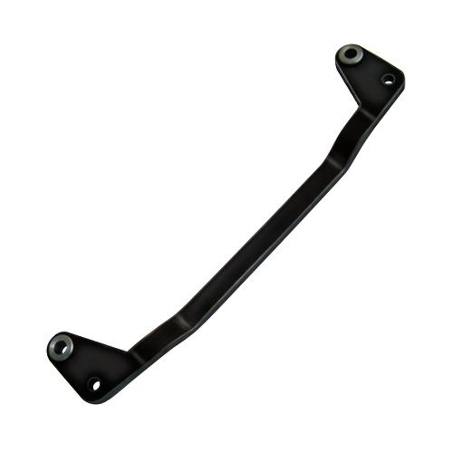

unfortunately i cant use the truturn system(this was my first preferance
but the governing body for car modifications here in Australia will not allow
an adaption of sorts to the original drag link
therefore i can use the ridetech upper and lower strongarm with out using the guldstrand mod(correct me if i am wrong) i can also use there tall spindles is that correct? whilst using the stock draglink,

I think he means with the center drag link bracket from the Tru turn? They would see that for sure? This bracket.
