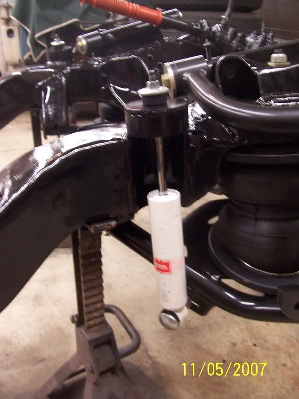

Shock relocation is the easy part. I am going to sink it into the frame and the top mount will be welded to the front stringers of the cage. (For turning radius purposes)
Sorta like this but with out the upper mount.
OR am I heading in a wrong direction?
