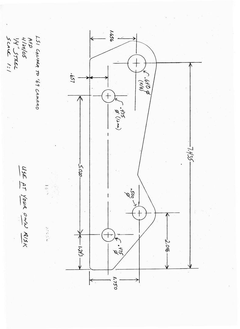

Hey guys got all the parts to do this swap but I was wondering if someone has already done this and could save me a little time and send me some measurments for the bracket I need to mount from the spindle to caliper.
Any help would be greatly appreciated

[IMG][/IMG]

That says thats for the LS1 front brakes...

Default braket
from what i understand they are the smae but i may be mistaken

I'm not sure. The LS1 differs from the C4.
