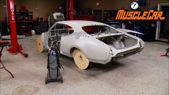

it looks odd but maybe this will help? 50.00 or so in plywood and a jigsaw...
Those are sweet! ...and you can stack them up and store them anywhere when you're done.

Why not make something like these?
