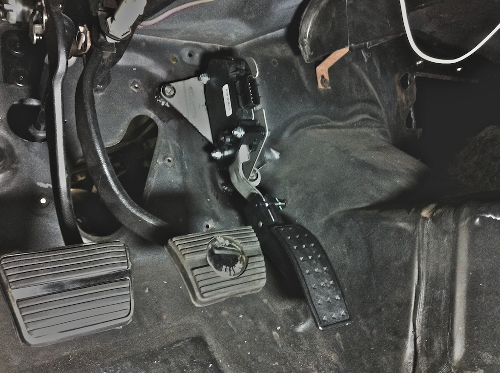

Does Anybody make a prefab Bracket that bolts a C6 Corvette DBW Pedal on a 1st gen camaro.
Thaks,Phillip

I know a company used to make them but you still had to do a fair amount of cutting and welding.
Frankly, it's almost easier to just make your own out of plate metal. I made out out of 1/8" plate into a box and welded it to the floor.
Let me see if I can find a pic.

Found it.
Simple box with nuts welded on the back side. One side is open to have access to the nuts if they need to come out.

Thanks Max for the pics I looked up ironworks website but they have them for a different style pedal.

My bracket does not fit that pedal. There are to many variables to try and get the pedal in an optimum position. There are some many variables that affect pedal position that vary from car to car. Amount of insulation, Pedal options, shoe size, steering column firewall mount, Etc.
I have been working on an all in one design, but have not come up with a total package that fits everything. Our bracket is designed to be a good base line that you can cut and do what you need for your exact application. Just a good base line.

That Pedal looks to be a Monte Carlo SS Pedal...Thanks verybody for the info... going to box up a Bracket and see what I come up with...I'll post up some pics soon on my build page
