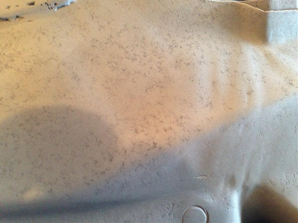

I tried hitting the same area with a 3M Scotch and 80 grit sanding pads. It looked a little better but wasn't totally gone so I hit it again with the sandblaster. The picture is attached. There's still discolored pitting so I'm not sure where to go from here. I'm not afraid of a little elbow grease so I can keep sanding. I just don't want to take too much metal off.

You will always have the shadow of the pitting, you just need to get rid of the black oxide. glad I could help.
