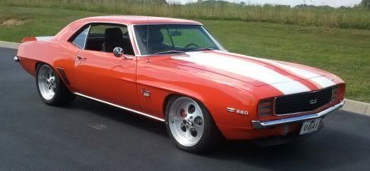

1....I have the chicane kit on my car with the tru-turn kit, ridetech tripple adjustable shocks and spindles, and spc upper and lower arms. with the chicane top mount and the chicane lower mounts bolted AND welded to the bottom of my spc arms, my lowers are parallel to the road using a 5" stroke shock with a 12" spring.
with this set-up, my sub rides 3.25" off of the road. my front wheels are 18x9.5's with 275/30 tires. the fender comes within .5" of the top of the wheel. the speedtech tq arm is set up with the same 5" stroke shock and comes within the same .5" of the top of the rear 18x11's with 335/30's.

That's the ride height and tuck I'm looking for. Very nice car. I assume you used a 5.75 bs for the 9.5s to get the tires inside the fender better?

thanks.
my fronts are a 6" back. I didn't want fender lip rubbing problems. we also modded the top, outside of the inner fender to gain more bump clearence.
