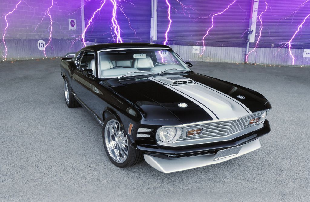

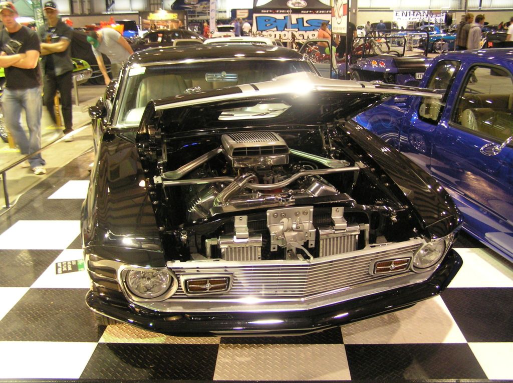

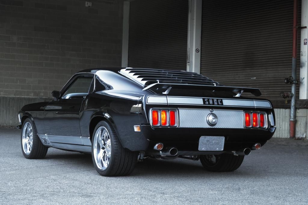

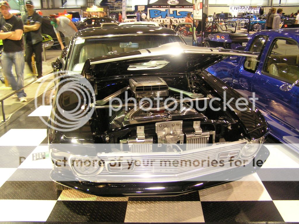

so i thought i show you my ten year built of my restomod 70 mach1
at its first car show
picture of it from street machine mag

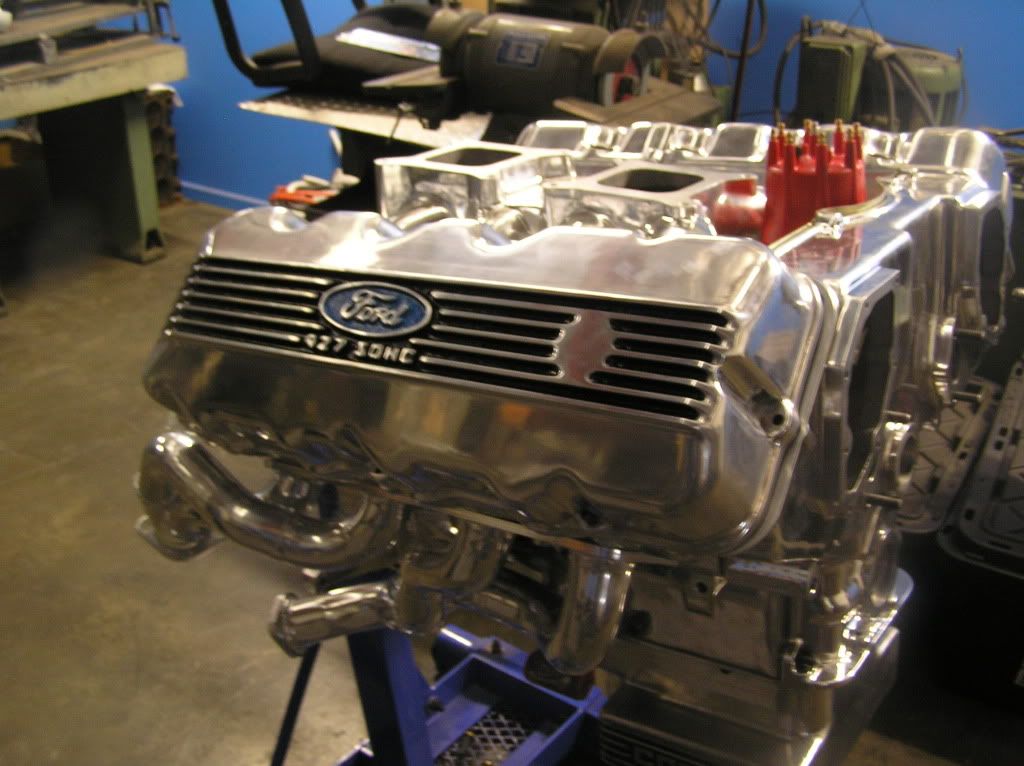

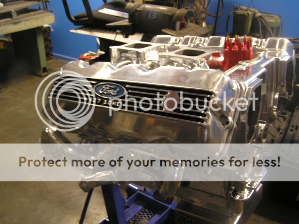

the 427 cammer in mock up stage

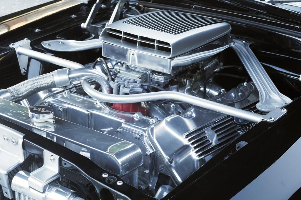

Now I'm loving that powerplant Do you have some more specs on the engine and the car.

hi guys

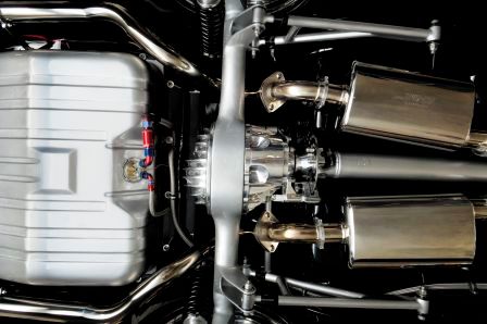

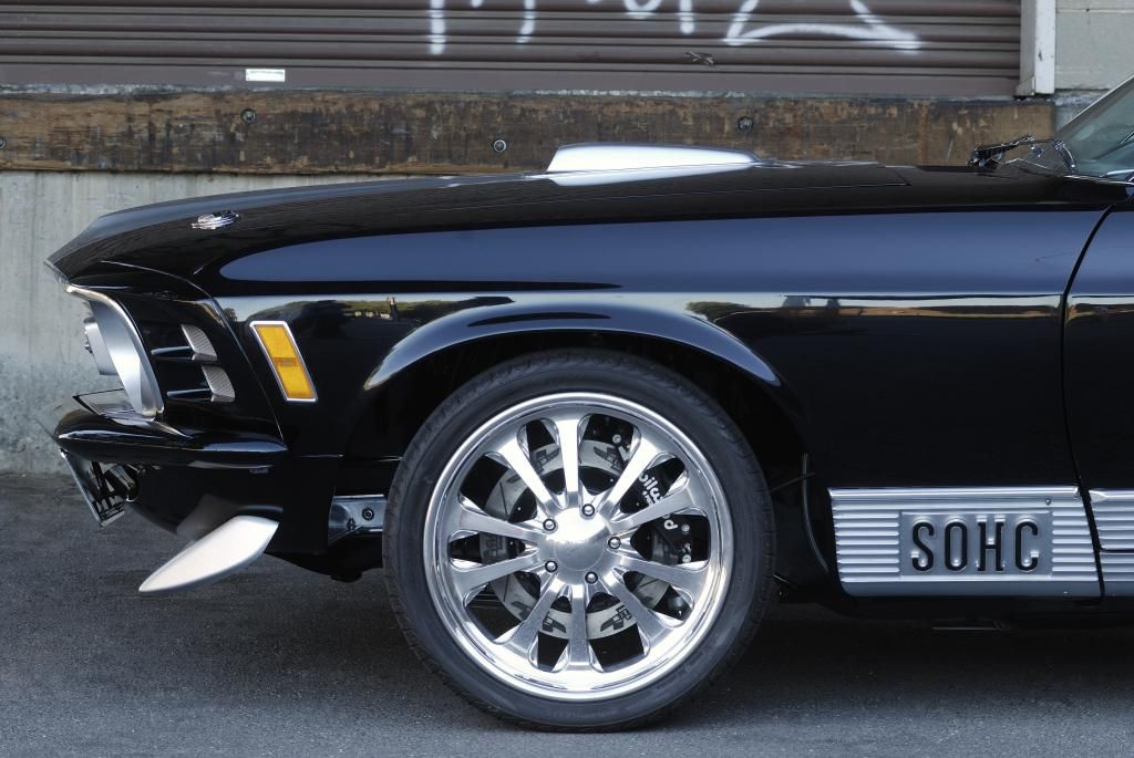

the specs on the car

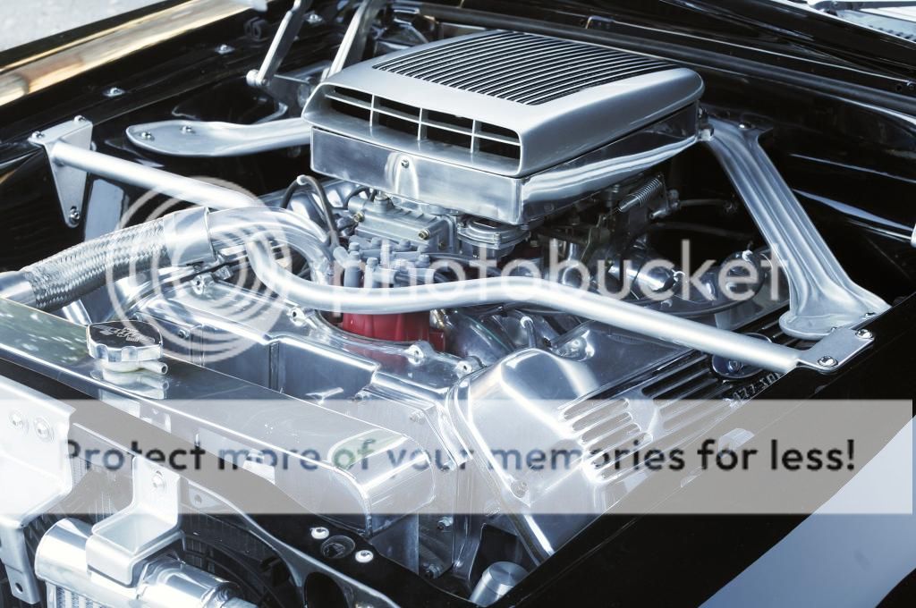

the motor of course is a 427 sohc stroked to 482
genesis ali block
forge steel crank
h beam rods
diamond pistons 10.1
paul monroe cammer kit
stock cams for the street
dual 780 quick fuel holleys
c6 trans with low gear 1 and 2
9 inch with ali centre
35 spline axles
3.7 detriot locker
wilwood 6 spot and 4 spot front and back
custom made rear suspension made by me back in 2000
when you could not buy aftermarket
total control front modifield with coil overs
full chasis connectors to look factory
mini tubbed to take 335 by 18 tyres
fully seam weld and plated

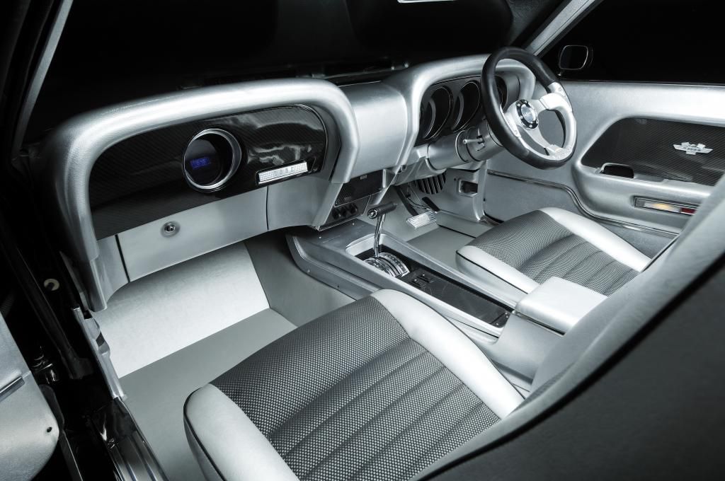

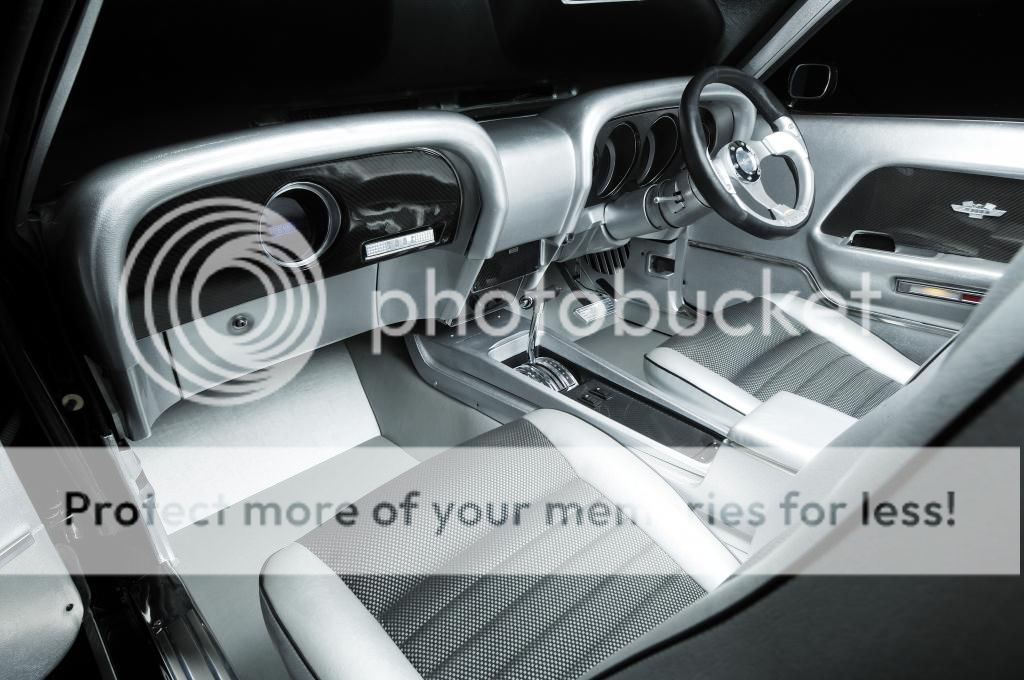

custom silver and carbon fibre interior
electric windows
central locking
push start
plus a lot more mods
there are over 100 custom maded cnc machine billet parts on this car
cheers
