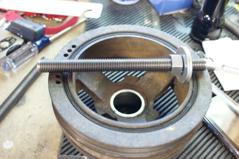

Go to Fastenal & get a piece of threaded rod & make an installation tool. I think it is 14mm x 1 thread (have them check with old bolt). Get some bronze washers, some segments of pipe for spacers & a couple of nuts & you are good to go. I did that & tonight can take a picture & show you if you like.
Basically something like this:
Scot
