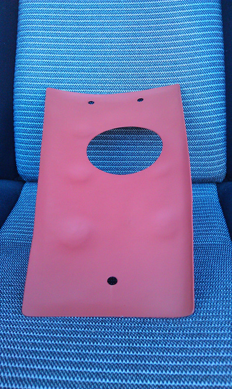

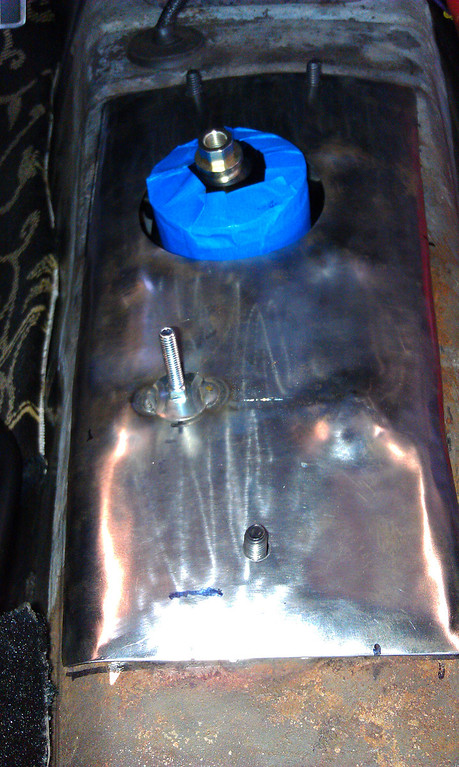

Looking at your pics your tunnel looks like in may have more taper than the Gen 1's. I'd guess it will need some clearance. Not necessarily a bad thing as you can design a removable top plate for access to the shifter.....which was very handy in my situation when I "upgraded" to leaking shifters. Without my cover plate I would have been forced to remove the tranny. It was a LOT easier to remove the console.
I stretched the tunnel as much as I could with jacks and blocks but still could get enough vertical clearance. So I "custom" hammered a plate from a piece of 16 ga.
Not perfect by any means but it blends nicely with the factory stamped floor.
Your tunnel plate has a six pack! Nice!
Nice job there Seig. I like the removable plate idea, I may use that?
If you can commit.
If you have any questions don't hesitate to ask.
