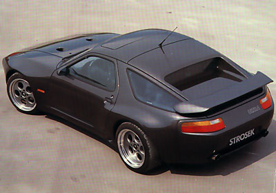

I have heard they are really Nice to drive, and that Porsche quality is really good. Some of the best!
They have a bit "special" look, the Strosek editions/bodykit are really good looking I think. But they did not come before the facelift i think. I have seen older Stroseks also though. They have reeally wide rear tires

That looks bada** man. It really does drive nice! When its driving.... lol
