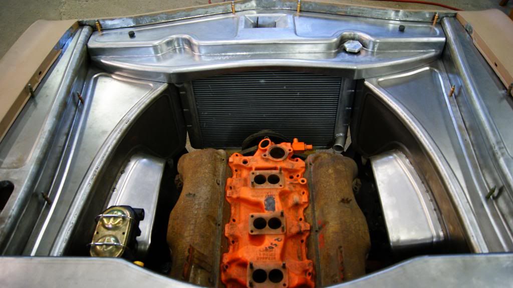

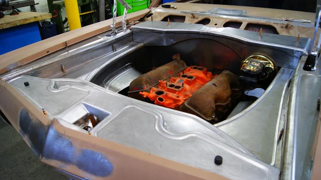

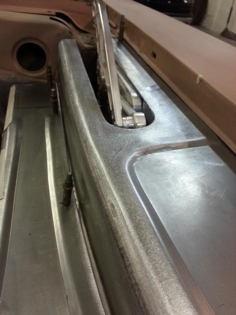

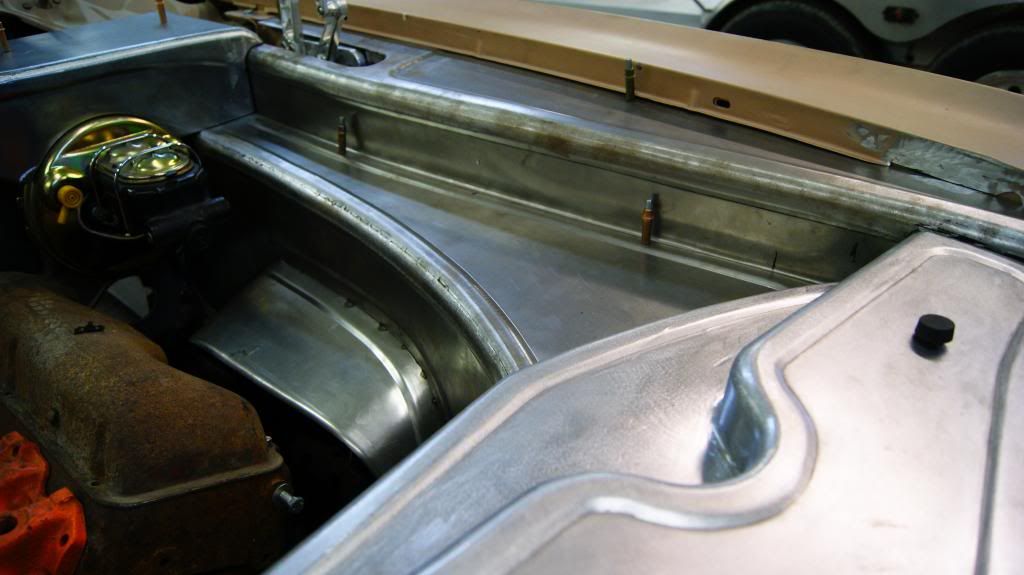

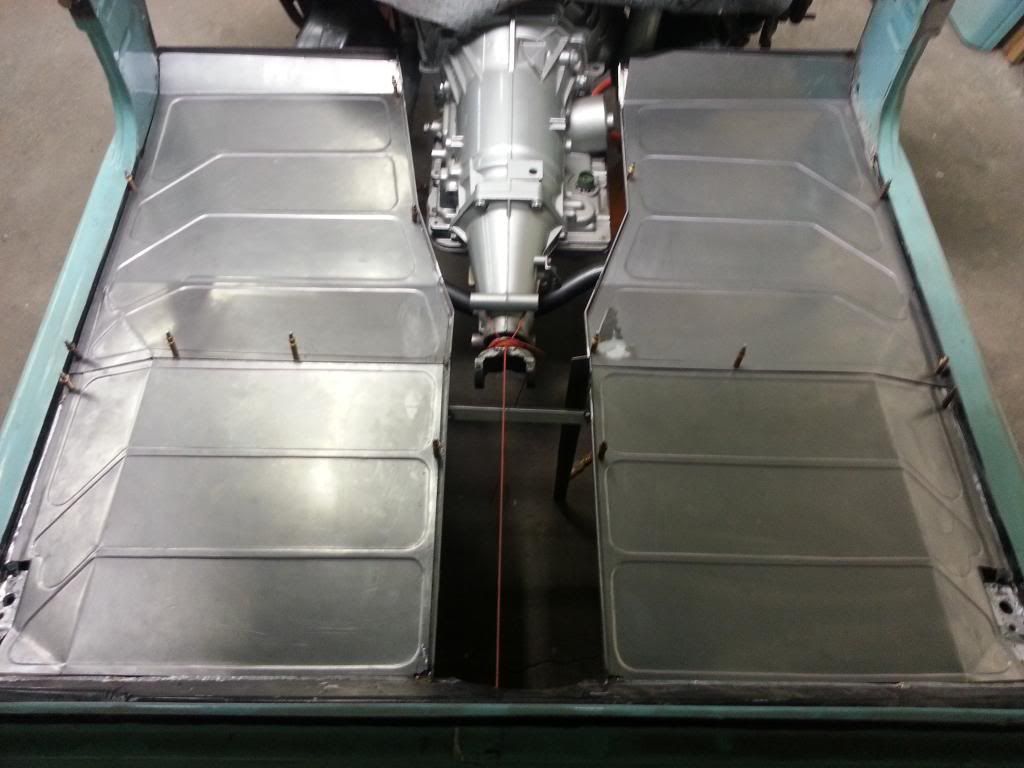

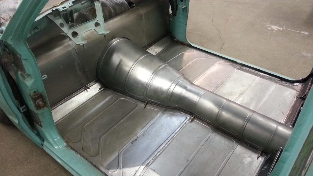

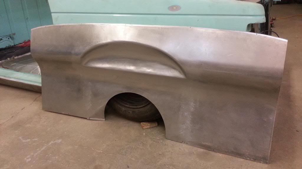

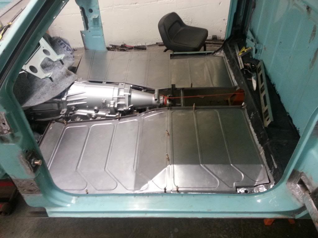

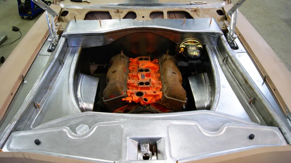

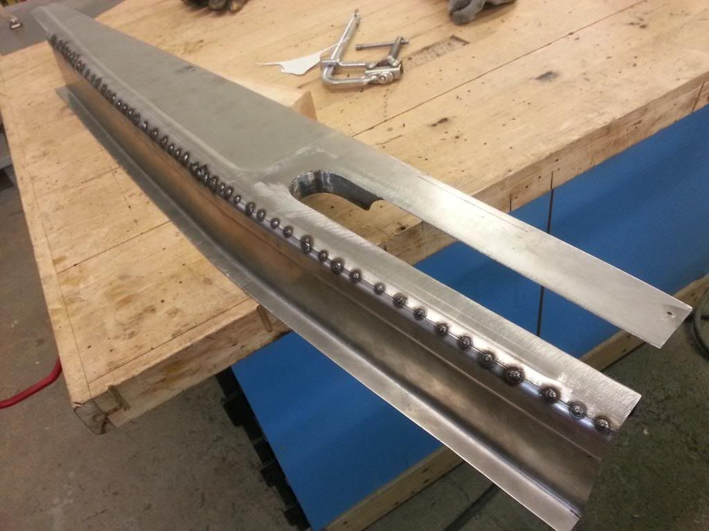

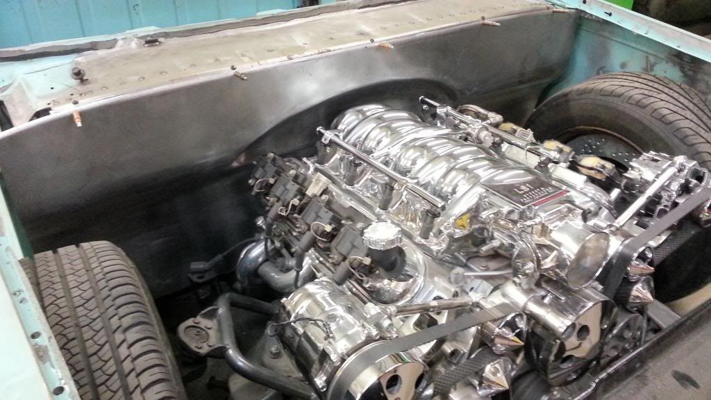

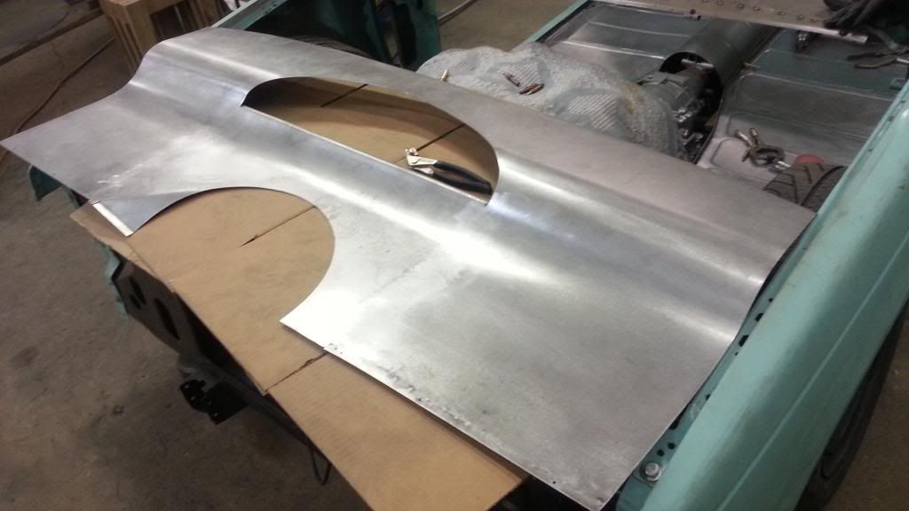

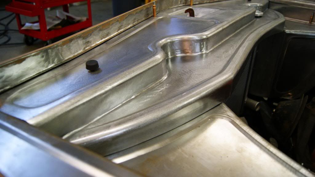

Hey everyone. Just wanted to share a build we are doing on this 65 Biscayne. We built a sheet metal engine bay which included smoothing out the firewall, inner wheel wells, radiator and core support cover and wheel well splash panels. Bumpers are narrowed, smoothed and tucked up against the body. We fabricated pockets for 65 Chevelle hood insert onto the Biscayne hood. We built a custom grill from scratch. And some other misc metal work.

Metal work looks great, love those big post cars!
Care to share what kind of tools you're using?

Nice to see a 'W' motor in there.
Dan
Nothing special besides a Mittler brothers bead roller. Everything is just basic hand and air tools.
