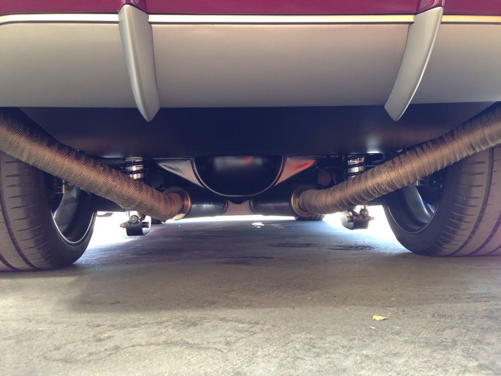

I did the same. Couldn't get the pipes over the axles with my set up.
Here is the Lokar Camaro
I have more examples on my PC that I will post up for you.

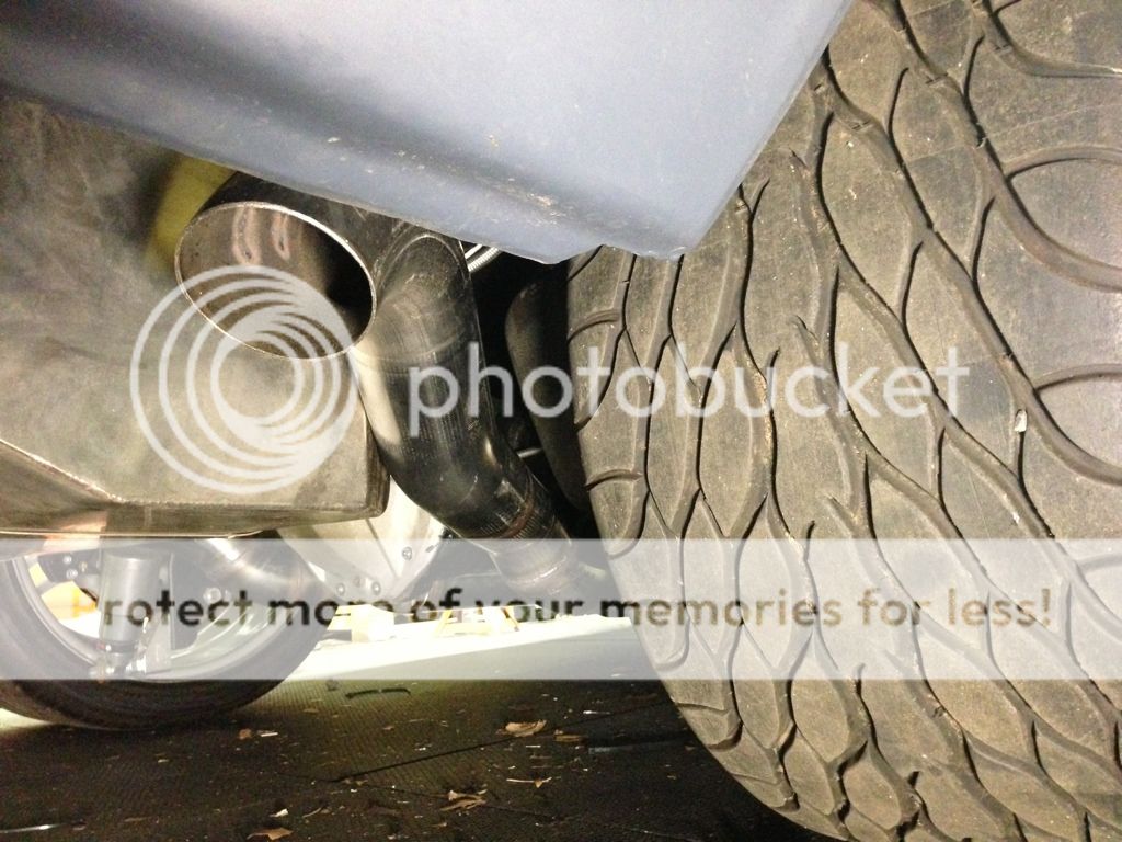

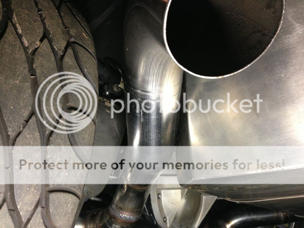

Not the greatest shot but its all I have atm. Me and my brother made them work from the magnaflow kit that I bought. They where 3" rear exits for a leaf-spring car. I have about an 1" from the shock and 1/2-5/8" from the tank. I know it looks like its touching on the tank side due to the camera angle. I don't think we could have went over.

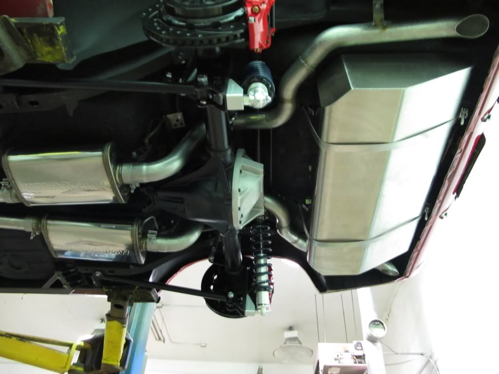

I also went under the axle.

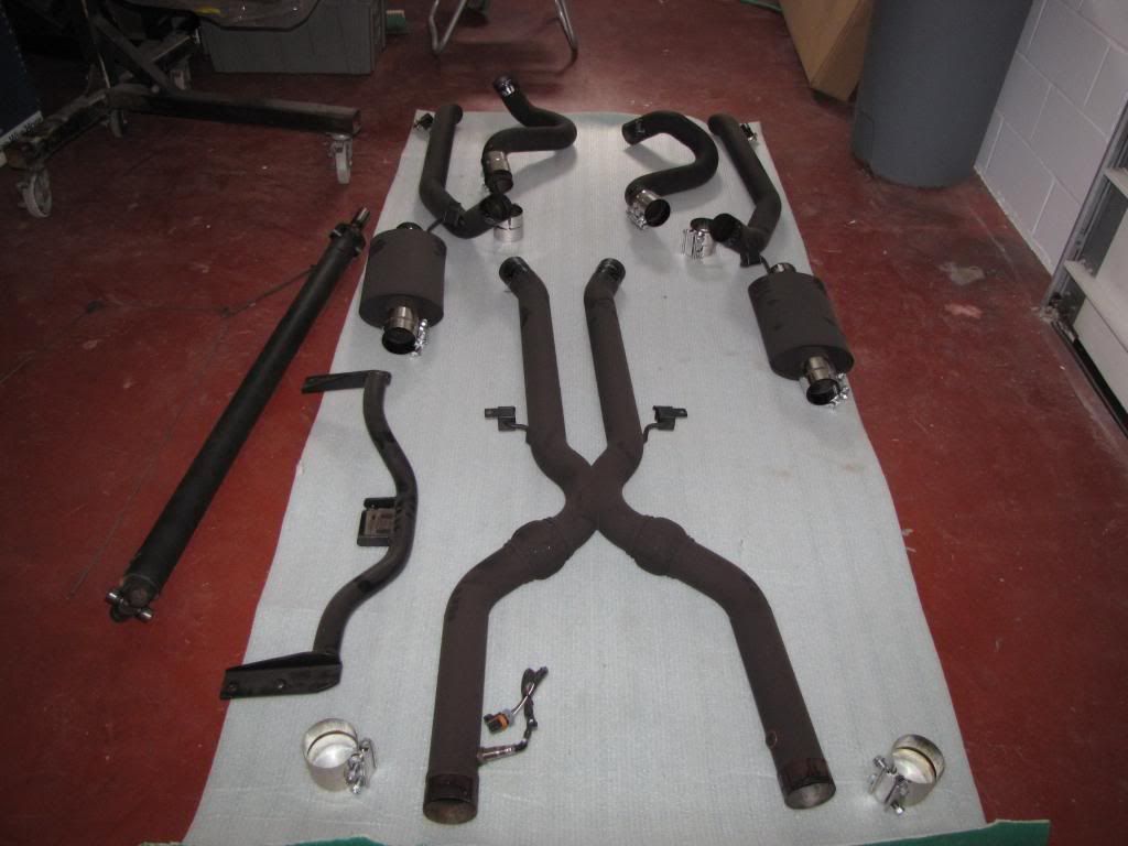

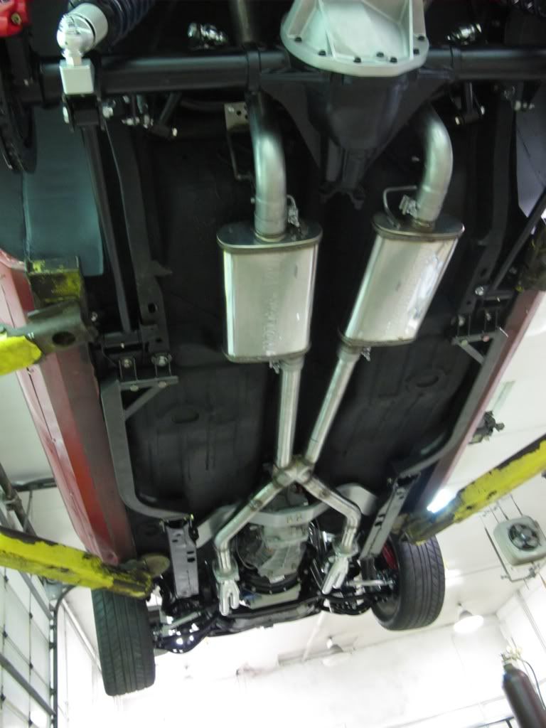

I went up and over the axle with 3" I also have the sway bar too.
I can have the complete exhaust system unbolted and on the floor in about 15 mins.
[IMG][/IMG]
Above Average Motorsports
1972 Nova, Ride Tech, Forgelines, Wilwood, Bowler Transmission, Lingenfelter, RAFT.

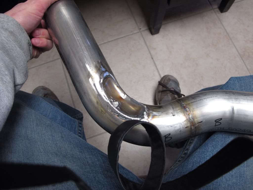

I used Ridetech's rear sway bar and rear tail pipes that I bought through Prodigy who got them from stainless works. I'd go direct to stainless works because the above mention vendor has well known issues. We had to mod them to fit the sway bar
