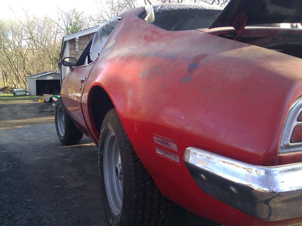

One of the ad photos

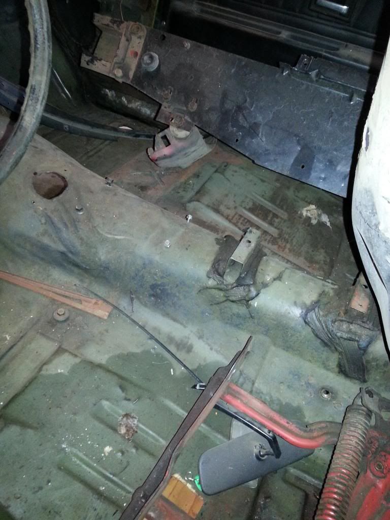

And those floorboards are original!

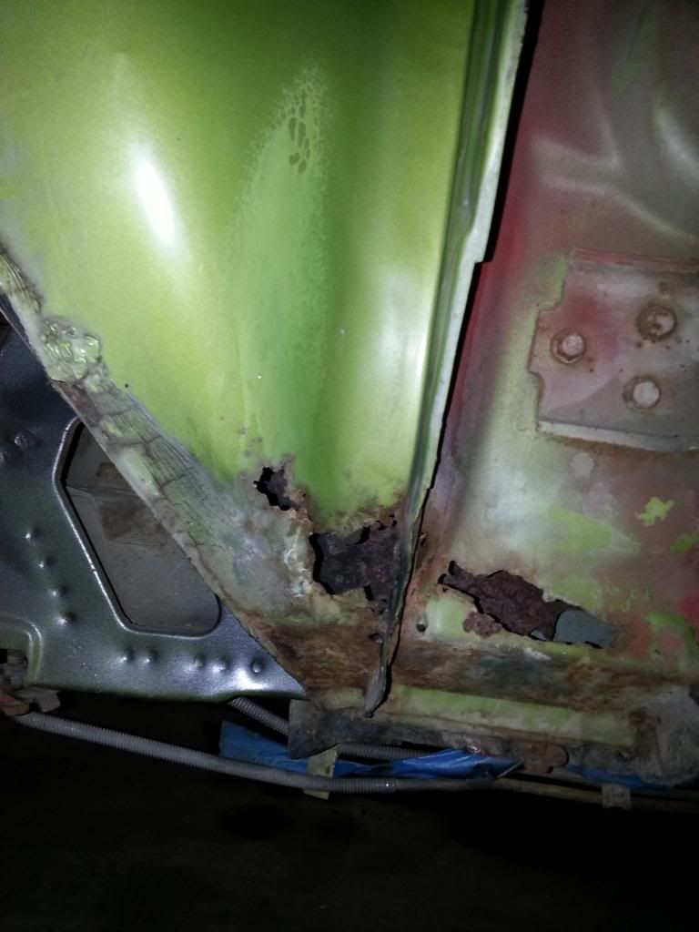

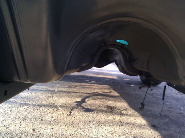

The only rust discovered so far...
D/S toe box...

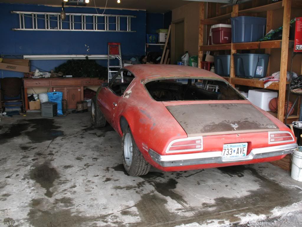

Here it is at home for the first time, back in April, in the front garage...
Notice the salt on the floor, we got snow into May this year!

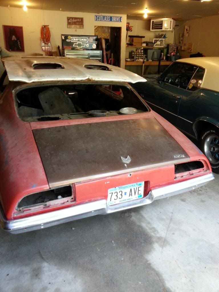

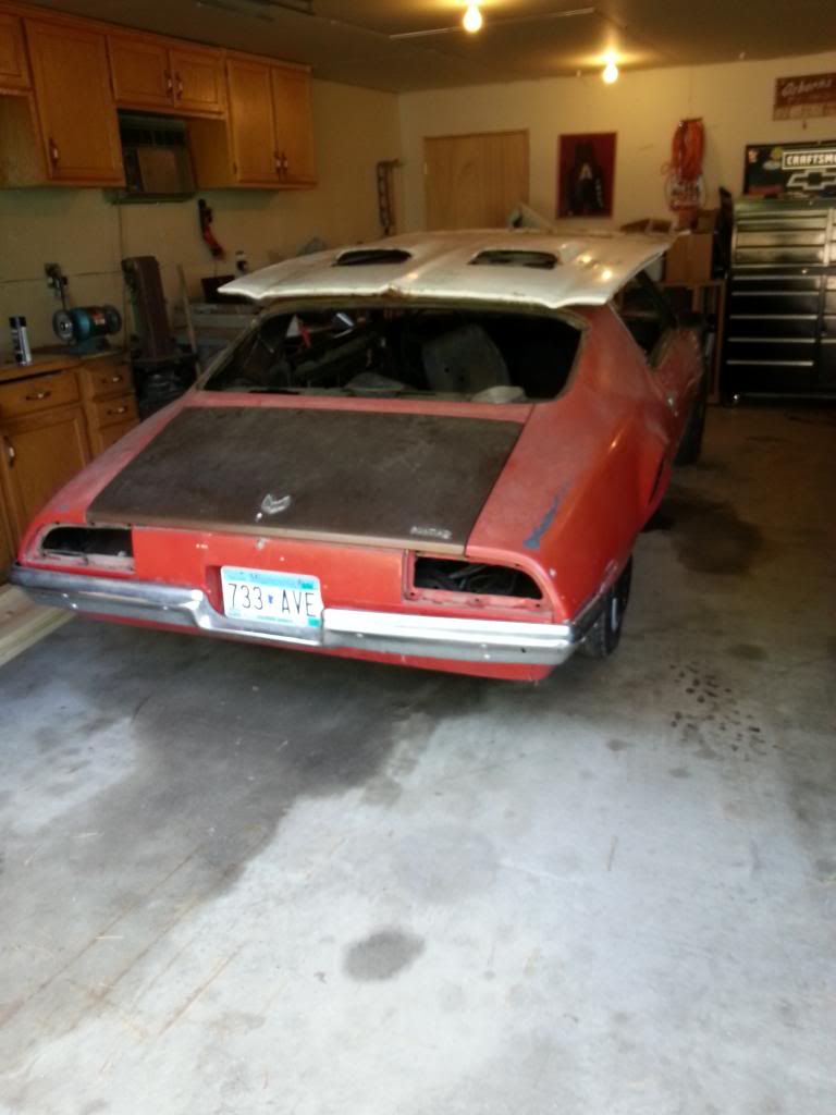

And yesterday it finally made its way to the back garage, or "Skunkworks!"

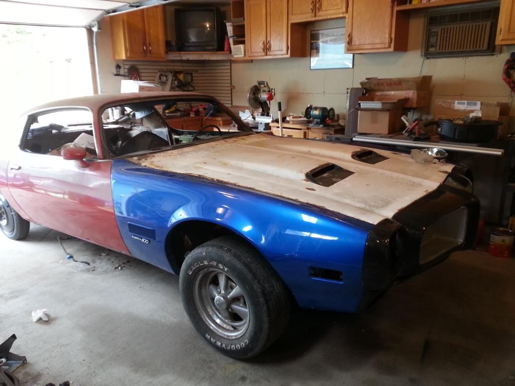

You'll also notice I've found a 1976 Formula hood for it!

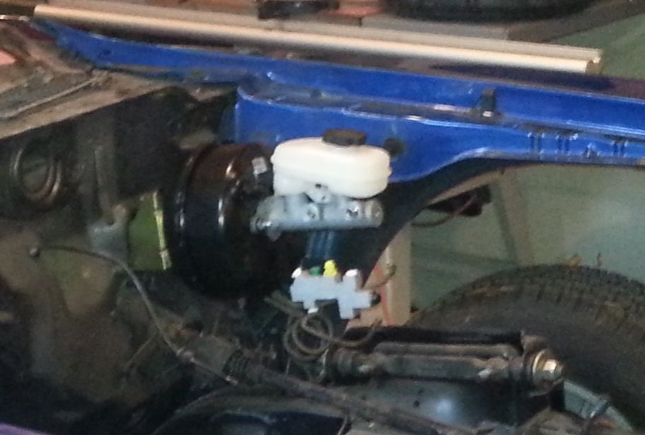

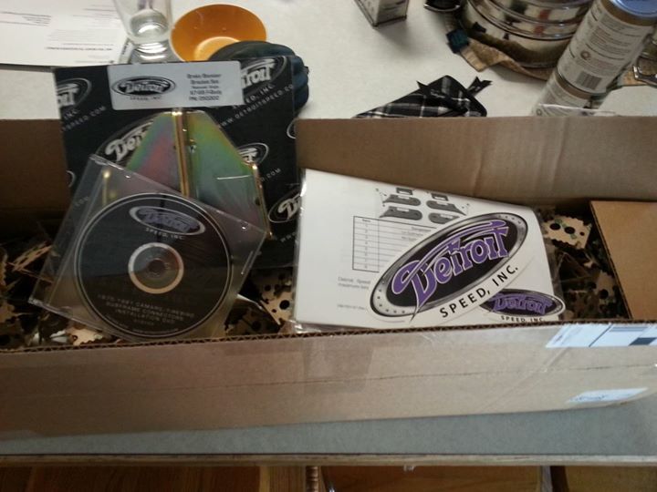

The brake and fuel lines are being bent, I have the firewall modified to accept the C6 booster with DSE bracket, the DSE subframe connectors are going in soon, and the new rear quarters from Goodmark (the new ones with the sail panels) are here are well.

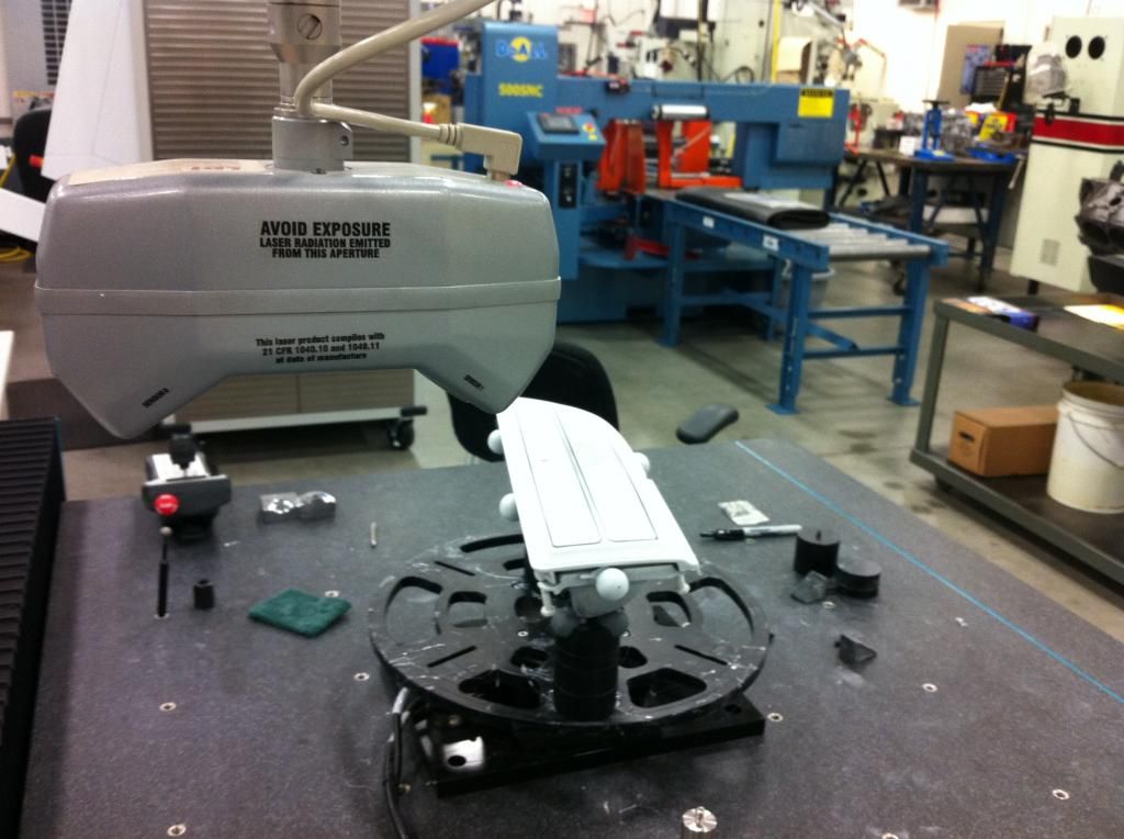

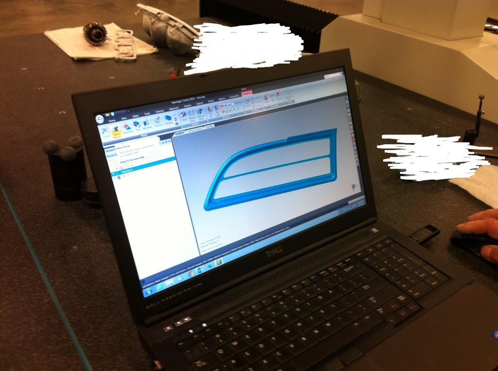

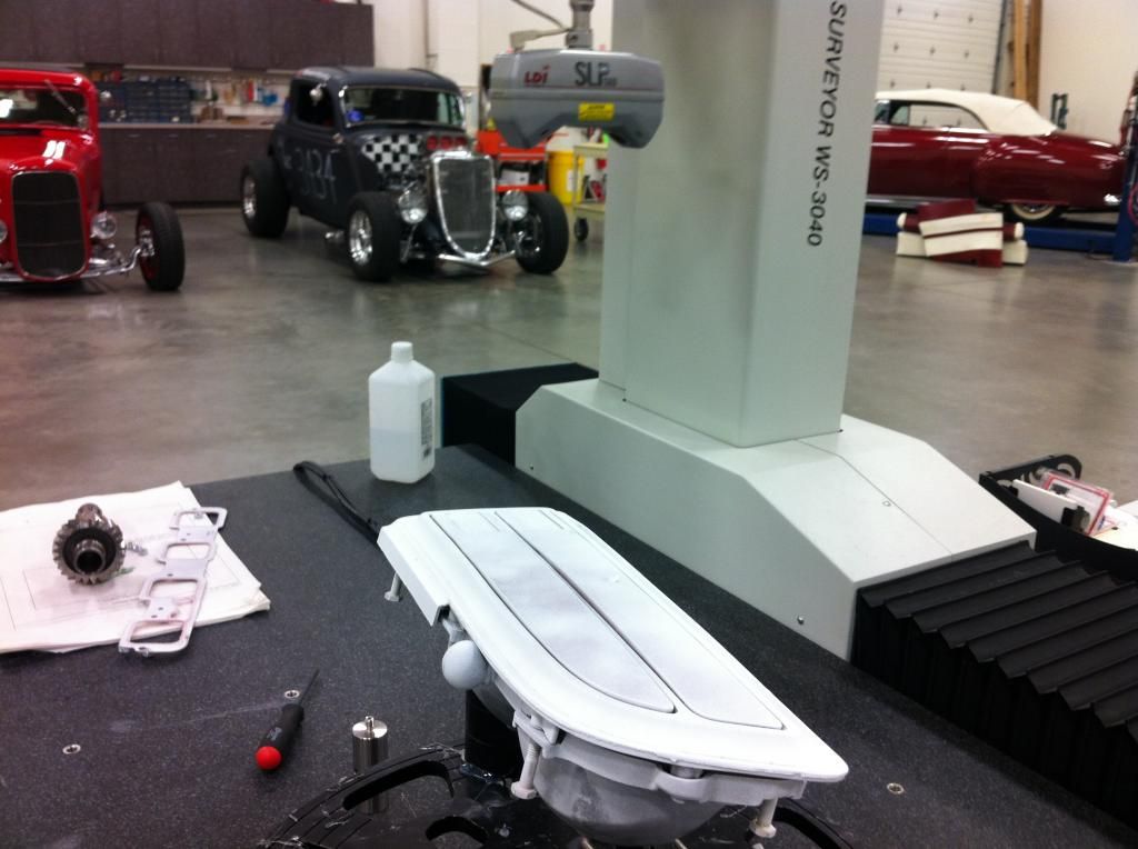

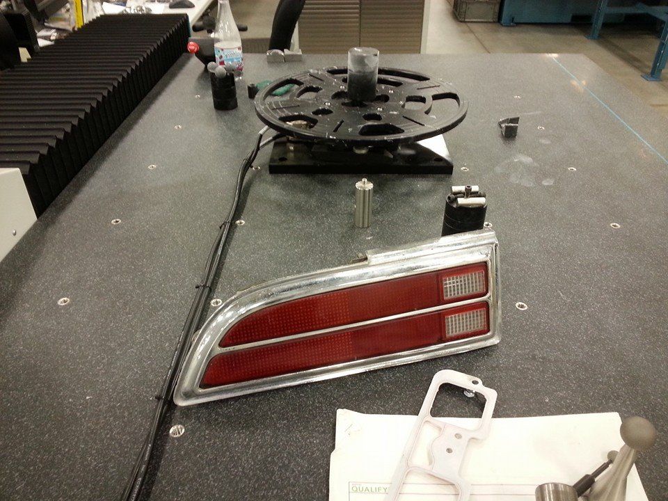

And there are things I've been making for the car, here is one I started today. The tail-lamps on these cars have always struck me as slightly undersized. I've got our LDI scanner mapping the contours and surfaces and I'll transfer those dimensions into solidworks for "customizing", we'll cut the parts and I'll have an LED board and some other unique features coming for it soon.
