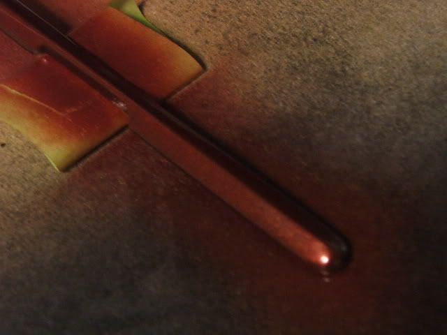

seems like I had heard somewhere that a black base makes pearl and metallic colors POP. A model car paint vendor who sells formulas of auto paint sells a new line they made call fire pearls which are sprayed over a black base. Here are the results...I am EXTREMELY pleased!!!

Well you just proved my point. You painted over black and it is a lot darker than what ours looks like over white. Case closed. Looks great either way but definetly darker over black.

I just realized I should have stated the color more precisely. I was shooting an OE GM color. Sunset Orange pearl I beleive. It is most commonly seen on late model F-bodies. Much darker to begin with than the HoK offering.
