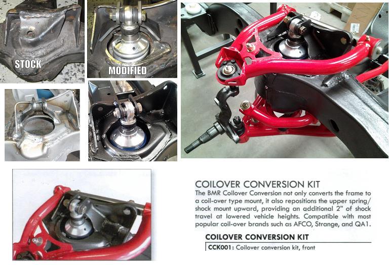

We make a Coilover Conversion Top Kit for A-Bodies & 1st Gen F-Bodies
T.C.
Attachment 43215
DAMN! that's some kinda sexy right there!!!! I will call you guys after this Goodguys road trip, I think I need this for Jane and my other project.....sorry
