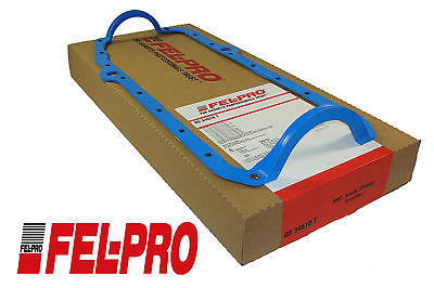

I uses this and don't have any issues with just a little silicone under and on top of the gasket in the corners
the rear part of gasket on the main cap is the same size, it's the front that can be different.
Picture is just for refference
