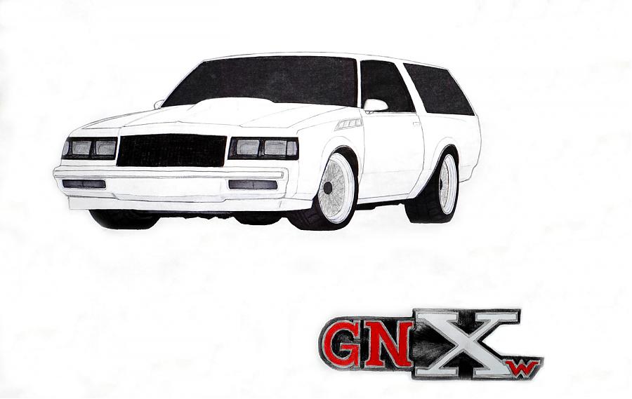

Plans for a project I'll be starting next year. A GNX inspired 2 door wagon. Heres are some of the specs:
4.1L TA heads w/ 70mm BB turbo custom external wastegate downpipe with 2 3/4" dual exhaust
FAST xfi
4l80E w/ paddle shifter
8.5or12bolt custom rearend
Ridetech level 2 airride suspension
BAER 6P pro brakes
Axis OG-San 17" GNX style rims
Custom body mods include but not limited to 2 door, thirdgen mirrors, metal fender louvers, custom inset door handles, custom front bumper and custom rear roll pan/ bumper.
I have not decided on a color yet. Leaning towards white with black accents, typical GNX black or possibly a two tone gloss/satin black.
