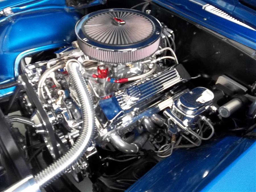

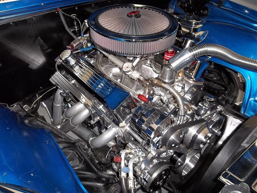

Here is my current engine

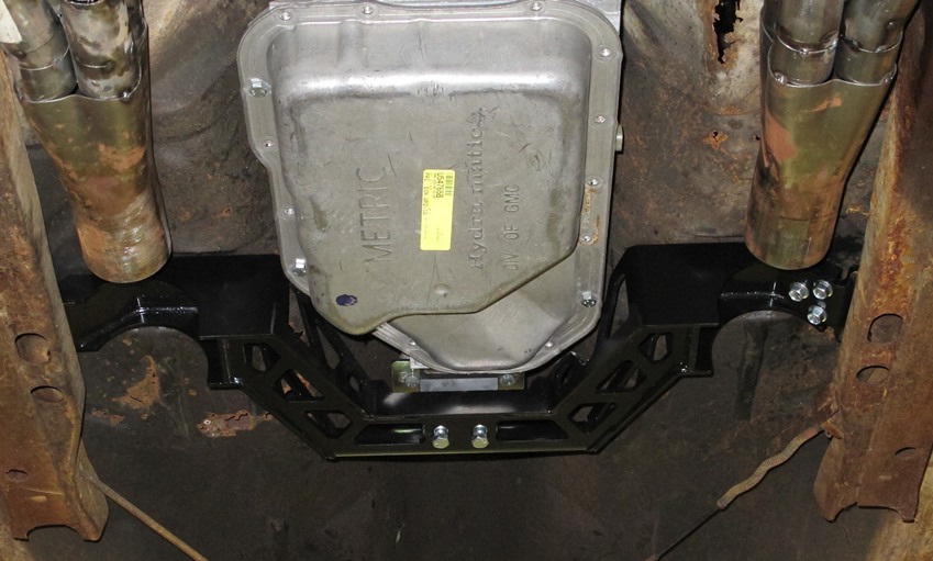

Default 2004R install in a 1st-gen
It's no problem to install/run a 2004R in a 1st-gen behind an LS and parts exist that allow you to do it in a bolt-in fashion, as shown in the attached photo.
