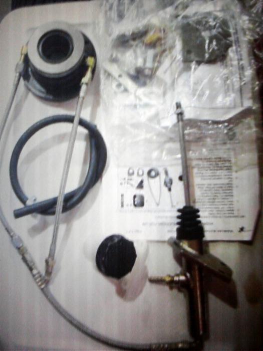

I seen a brand new in package kit for sale unopened from a TKO install that wasn't used, it has the hyd. throwout bearing, master cyl. firewall bracket and braided lines etc.. for a 69 Camaro would you stay away or go another route? Anyone with first hand experience with this kit, I believe it is the first style from 2005.

Here is a pic of the kit, it is different than yours, probably older version. I guess it is good. They have had issues with the throwout bearing on early versions I heard.

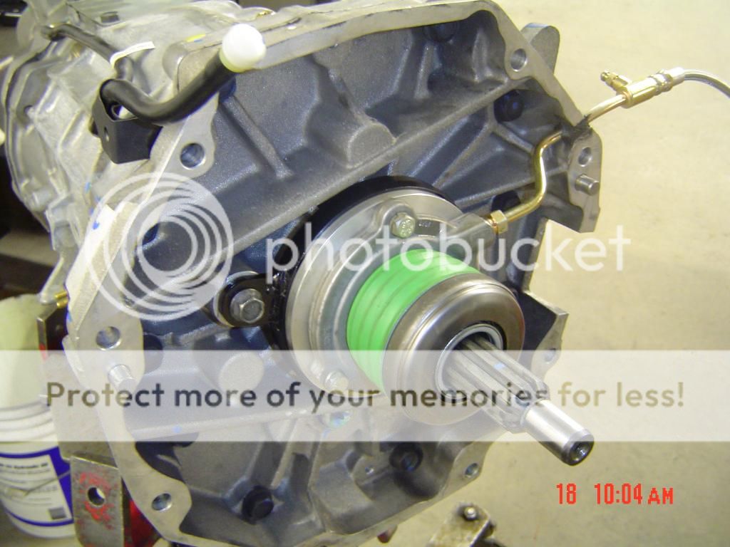

The pic you have is a McCleod clutch slave. Decent I guess if you set it up correctly_ I've seen a lot of them fail but I don't think they were properly installed. You def need to measure your clutch application height and there are different length pistons you can buy to set up the slave to match your clutch specs.
The slaves I've been buying from Keisler since about 08 are these. We custom machine the spacers to set them up on the TKOs and on the T56s we machine the front cover to accept them. They are an OE slave that is bulletproof!

OP, I had the same kit in your pictures.
I did not like it since it put all of the stress on the firewall. That part if the firewall is not very stiff. Mounting the MC on the bracket is IMO superior since it bolts to the pedal hanger and does not stress the firewall. The other problem is that is uses the CNC sourced master that leaks after about 20 minutes.
Mcleod makes a nice kit now that uses a Wilwood MC and uses the bracket.

Easy solution... Build a firewall reinforcement plate. Simple to do with a piece of at least 1/8" steel, a grinder, and a welder. Shape out a nice panel to fit the shape of your firewall where the clutch master mounts... tie in to any structural supports you have nearby, I.e. pedal support... Your choice on whether to paint it up pretty and put it on the outside of the firewall or if you build it into the inside you can weld it into the firewall to make it look more original. You would be surprised how many people do add a hydraulic clutch without some type of reinforcement.
We use a Wilwood 3/4" clutch master with the slave in the pics above and the throw is perfect. With correct pedal leverage you end up with a late model clutch pedal feel.
