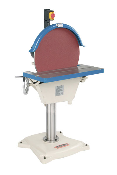

I use the little Jet so much it made sense to upgrade the go-to tool verses adding a specialty saw at my level. If the miters aren't as tight as need the next move may be a 12" to 20" disc grinder as my little 1x42 belt / 8" disc Delta lacks surface area, table size, and has some disc flex.......but it's also a tool that gets used frequently.
This 20" would be a big upgrade.
