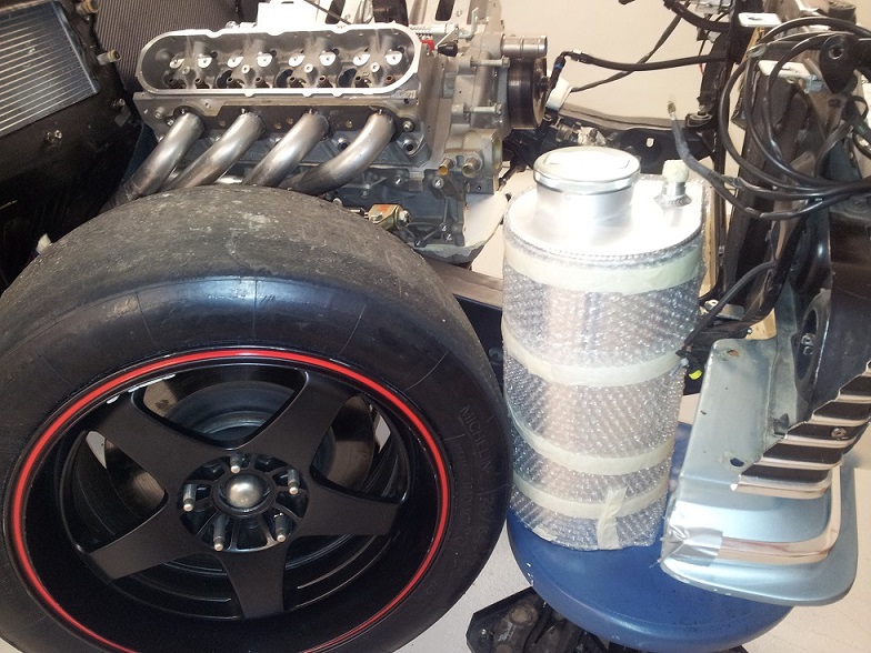

Hello. I have a chevelle -66 with ls1 engine.
LS1 engine should now be replaced with a LS3 Corvette Grand Sport dry sump engine.
Because of lack of space in the engine compartment, I had thoughts about installing dry sump tank in the trunk.
Is it doable?
Is there anything I need to consider?, .... i.e. placement of the tank, length of hoses, etc.
Hope You can help me out.
Pether.

You can put it in the trunk but you need to increase the line size to a -16 or better yet -20 to reduce the restriction, but I bet you won't like the price of the hose and fittings -20 hose ends are like $75 + each. Do not use any forged elbows, use only high flow formed tube elbows, the forged ones are very restrictive. I would also highly recommend that you vent the trunk somehow to exhaust heat that will be generated by the tank, The vent for the tank should also exhaust outside of the trunk and a sealed firewall behind the back seat would be a very good idea should something bad happen you don't want hot oil catching on fire behind the seat. What's the capacity of the tank in the picture? It looks pretty small to me, 2 gallons is the absolute minimum imo, more is better.

Run large lines like Tim said and get enough capacity. Your tank looks like 3 gallons to me. I would use no less than 4.

The tank is a 3gallon Howe Racing Enterprises.
As you can see it gets tight with the tank mounted in the engine compartment.
I will still use the original oil pump, so IŽll try to make it fit in the front.(see pic.)
One more question about placement of the tank.
How important is it that the connections between the oil pan and tank is at the same level?
Pether.

As long as the lines feed down towards the pan you're good.

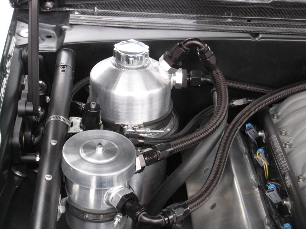

Here is a 2.5 gallon tank in the engine bay of a 1st gen Camaro. Dang tight in there.
