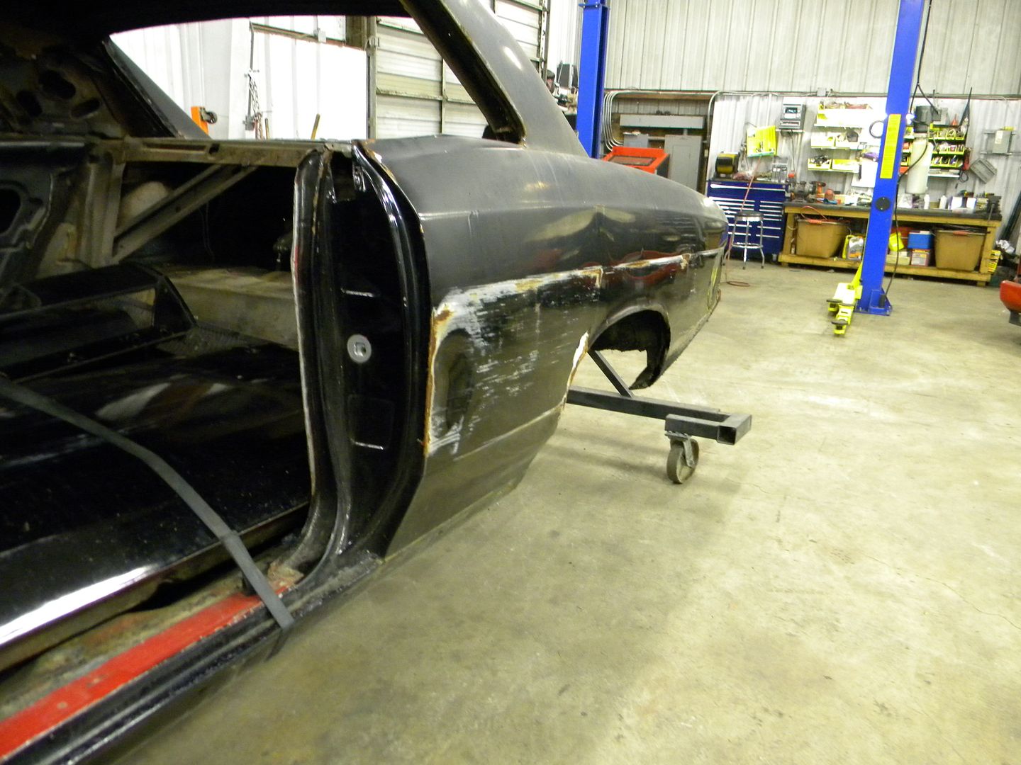

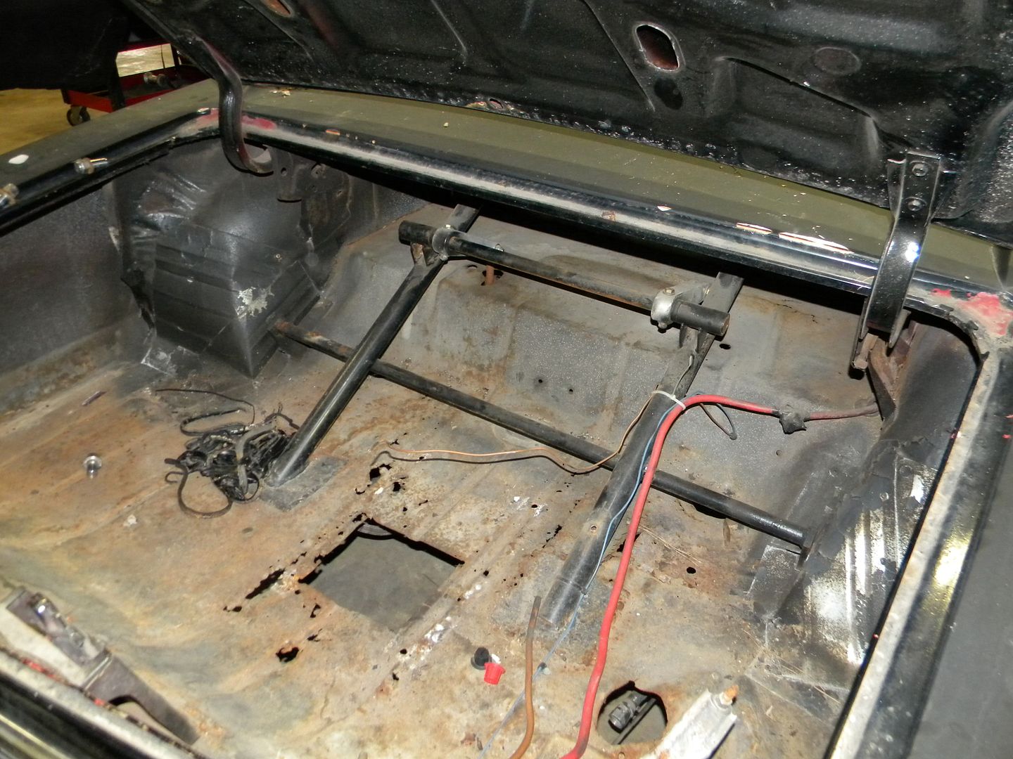

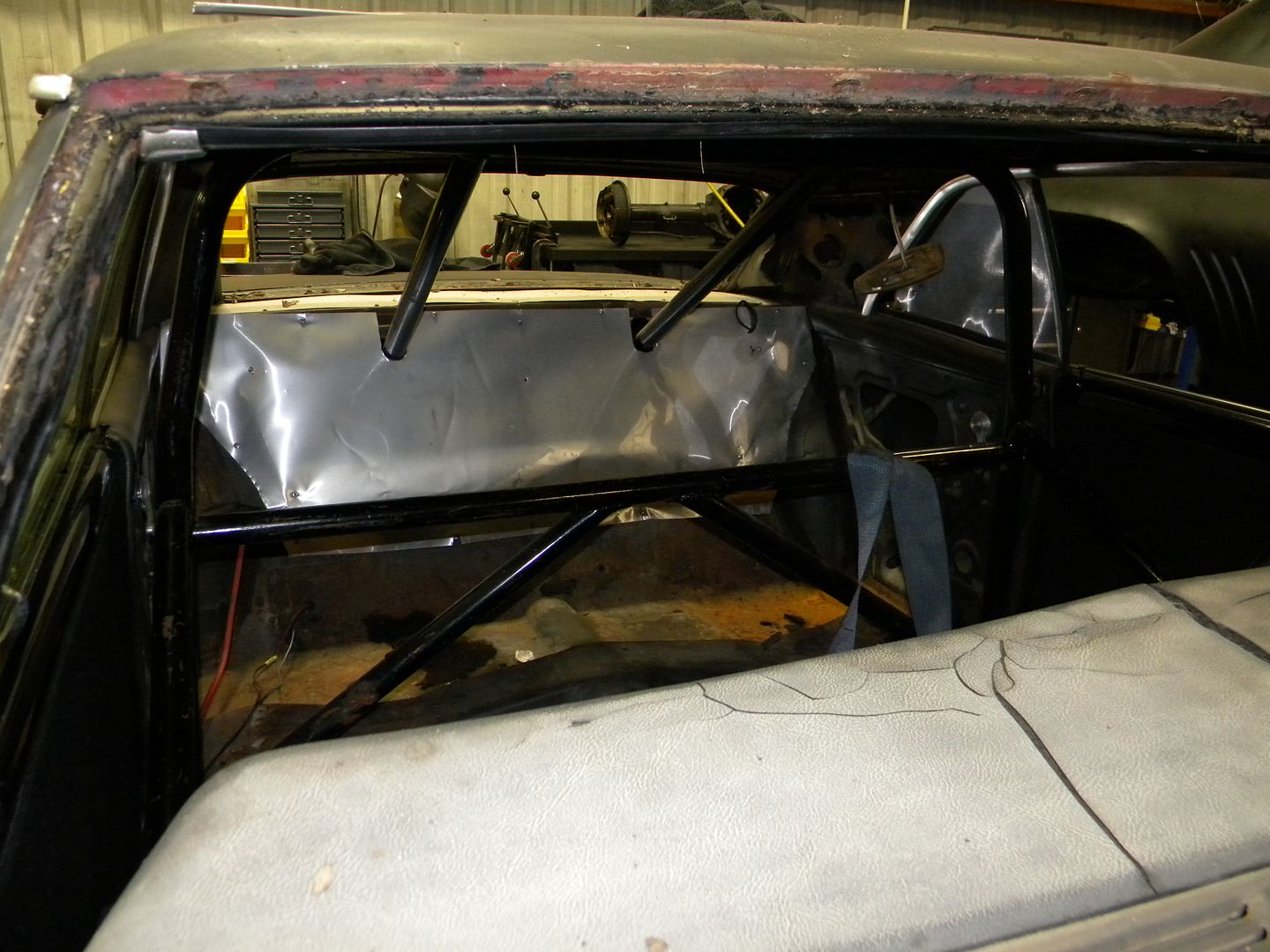

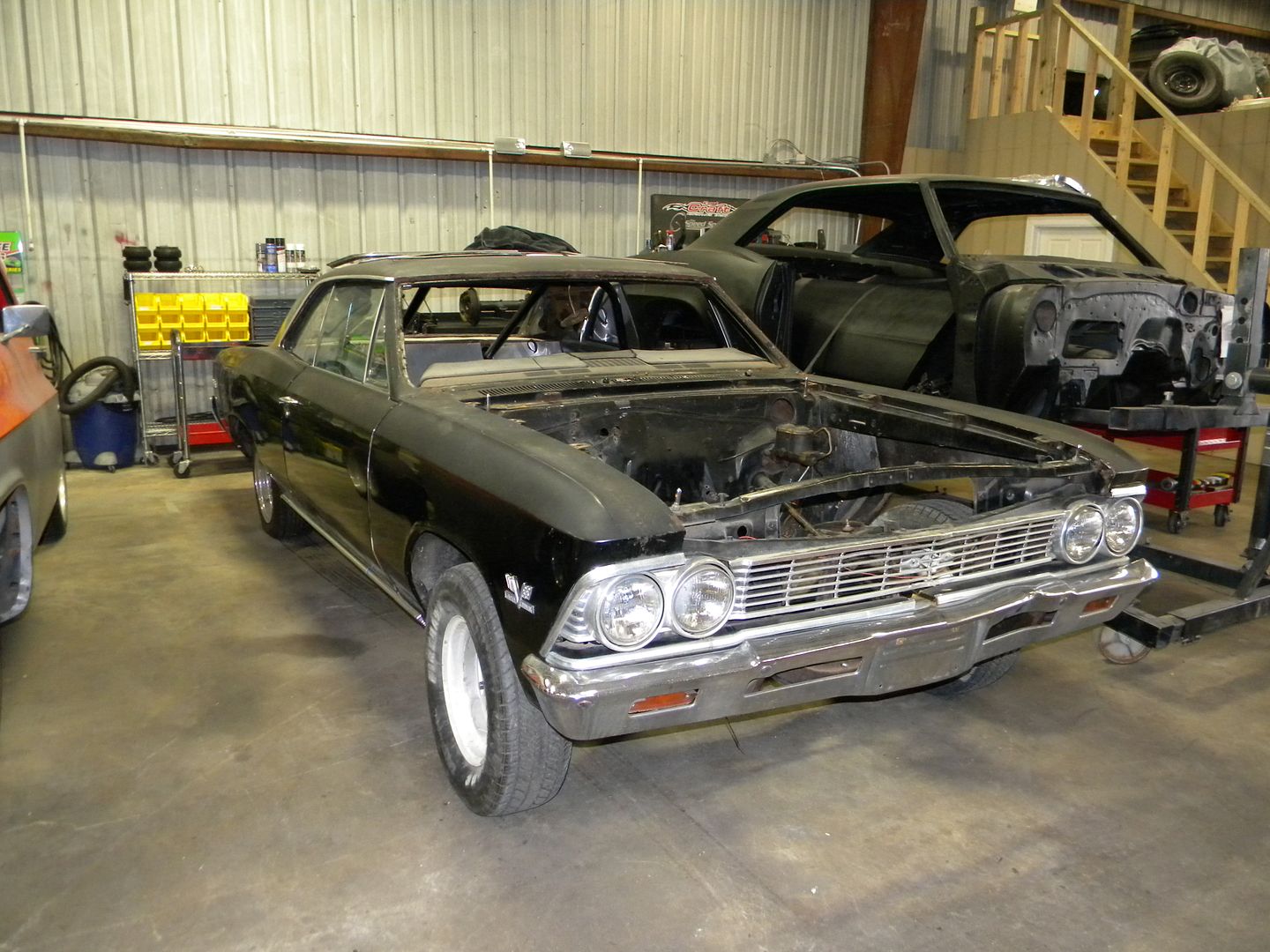

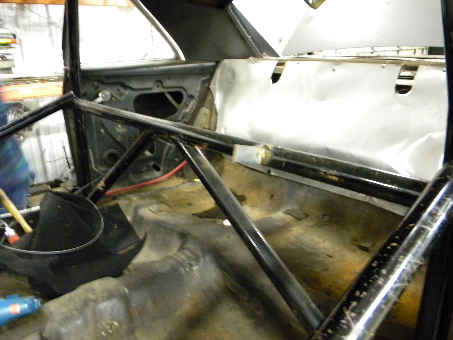

This is what we started with, a retired race car

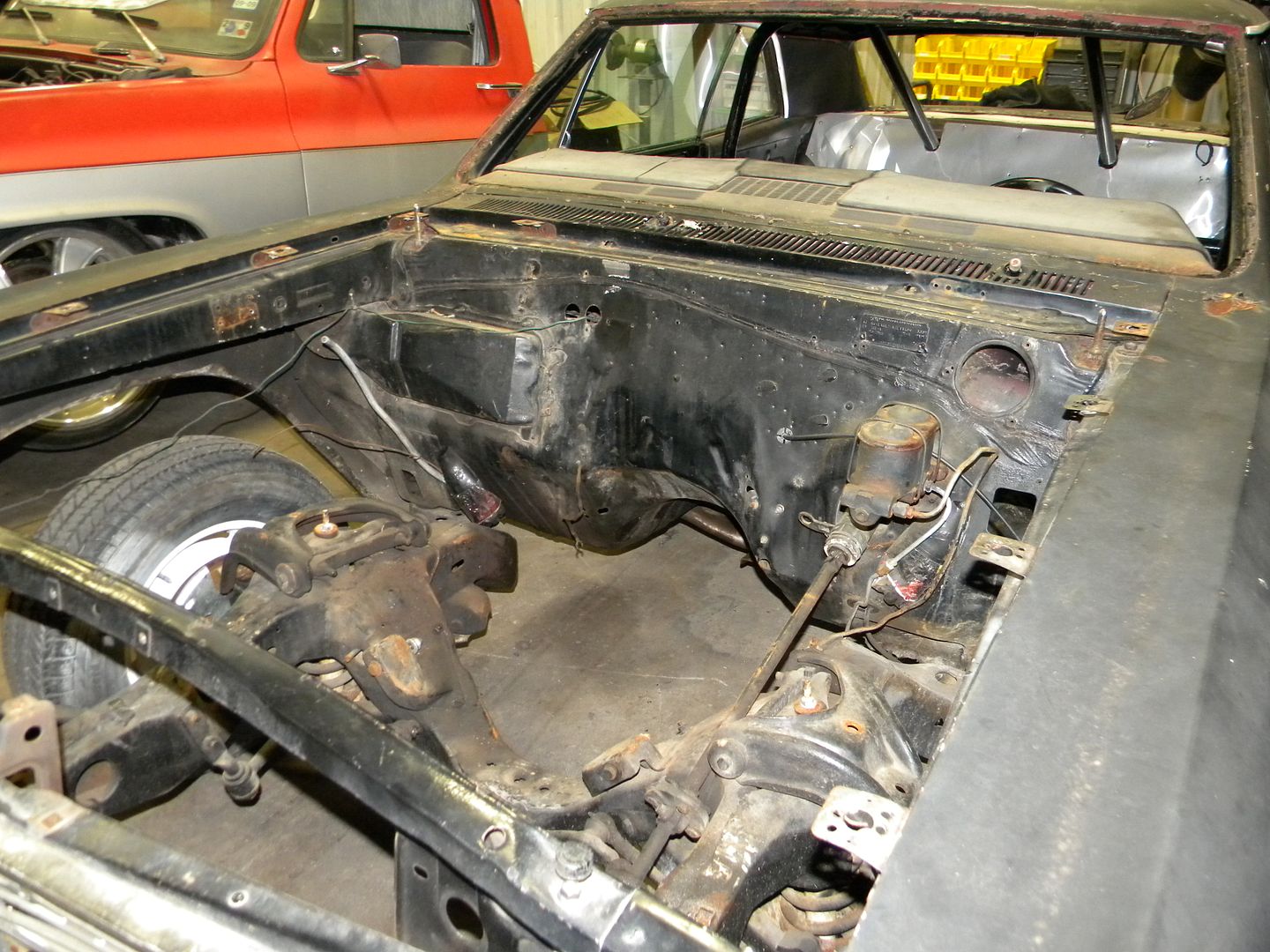

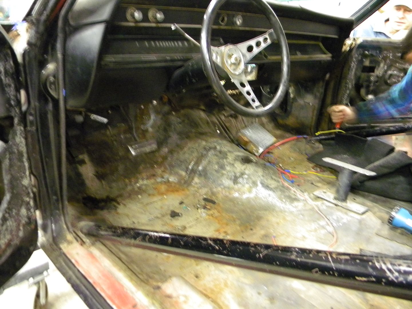

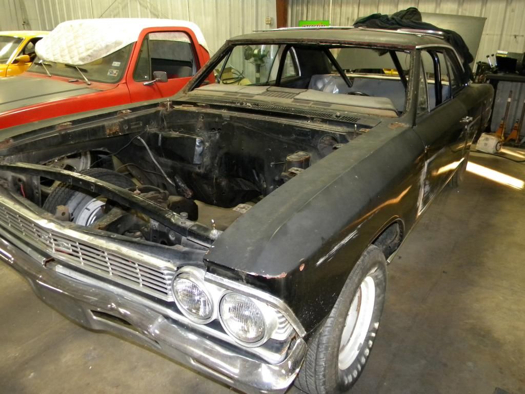

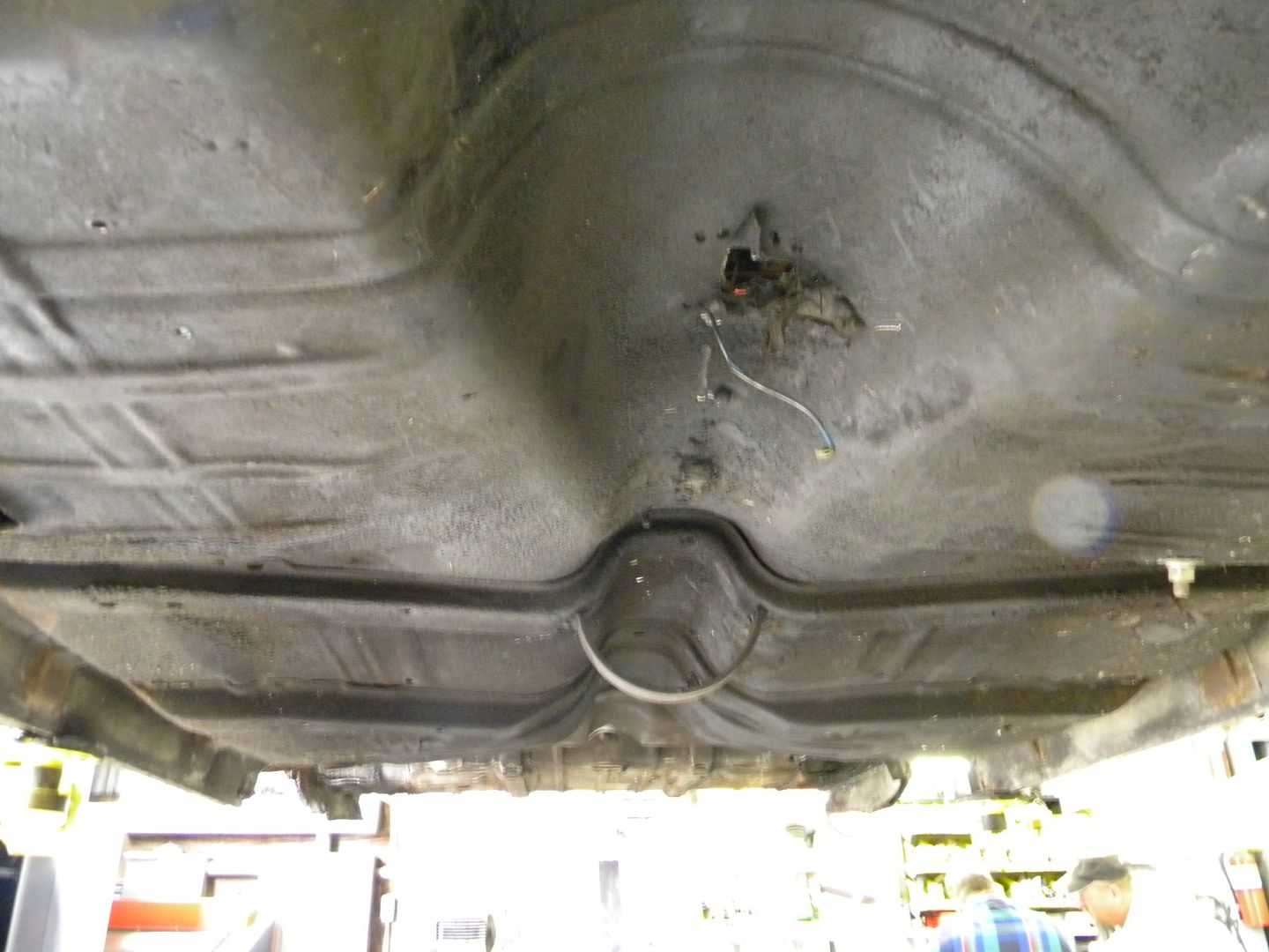

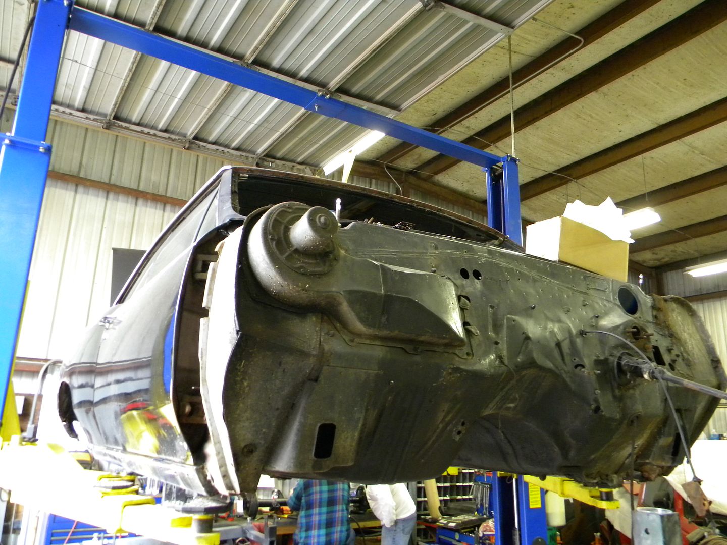

The tear down

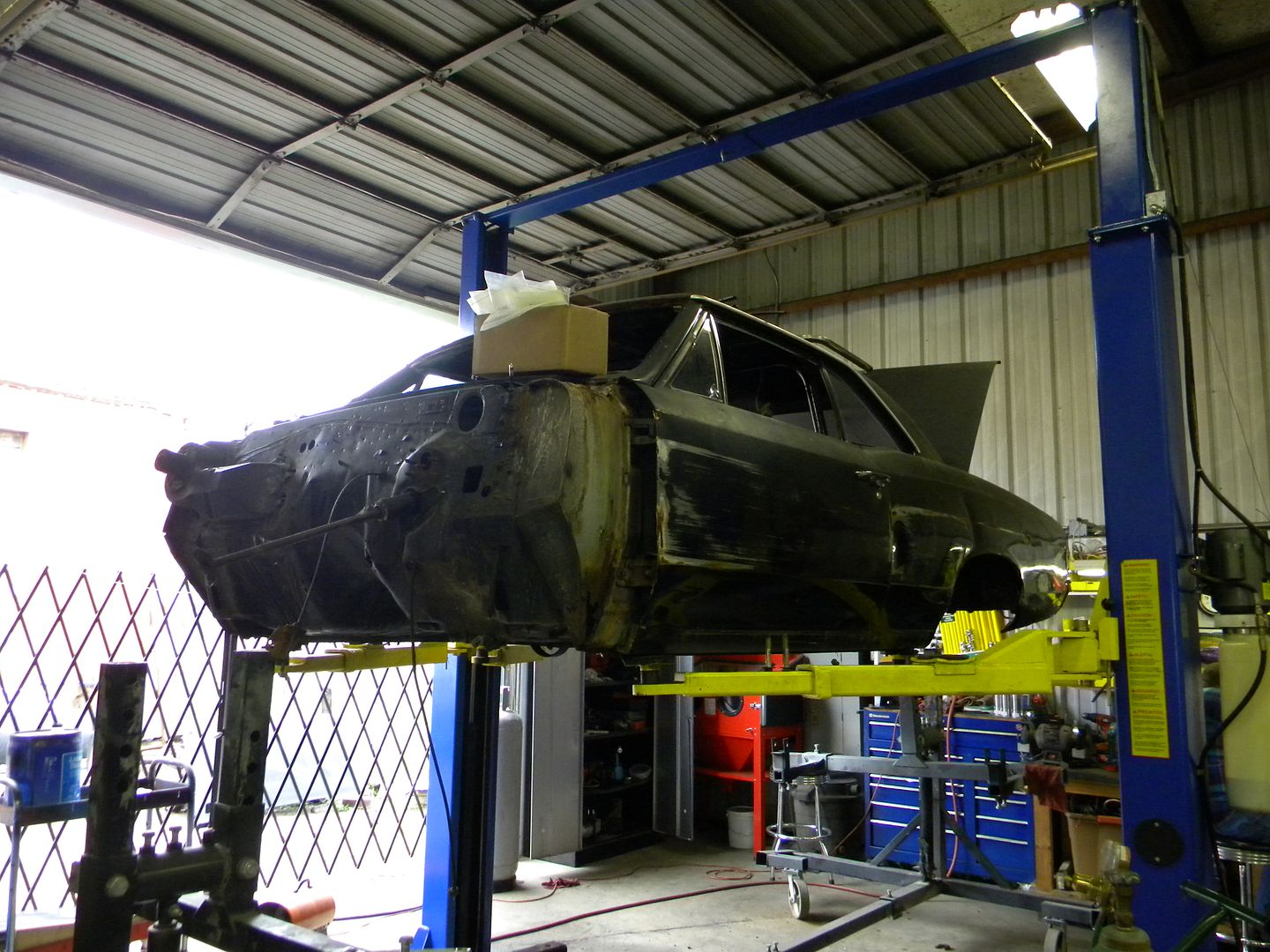

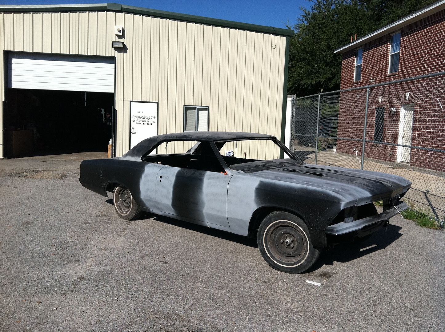

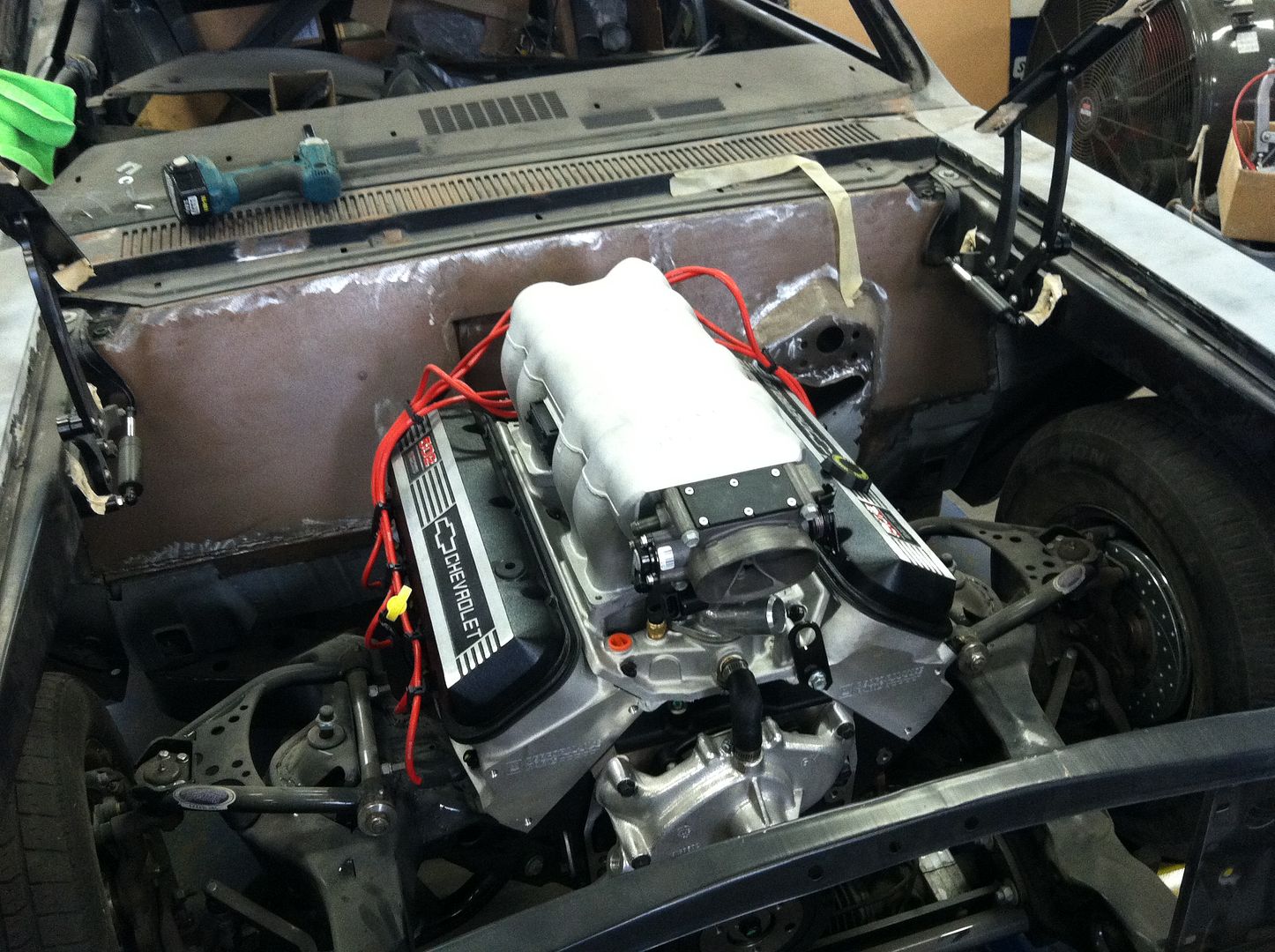

We ended up having the car media blasted. Then we replaced the entire floor, trunk, both doors, fenders, hood, and built custom wheels tubs.
This is it once it was back on the original chassis
First plan was to run a blown LS motor. So now that we finally decided on the BBC we are going to redo the firewall.

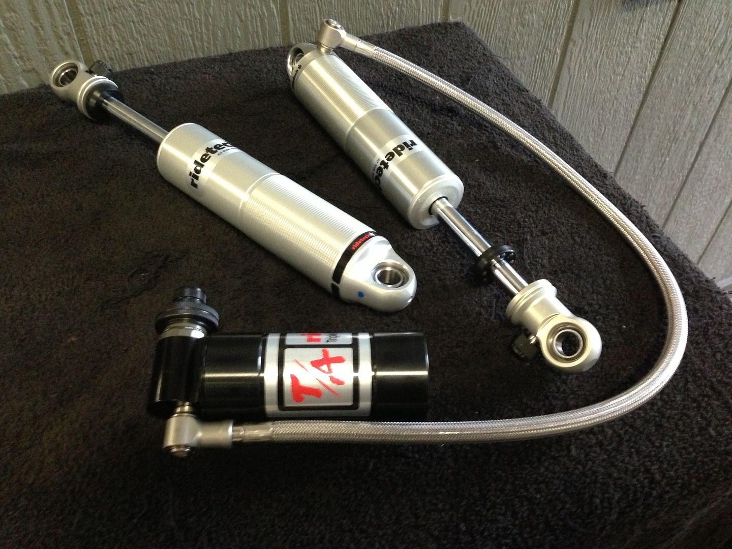

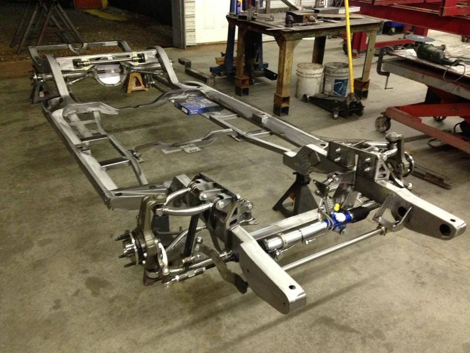

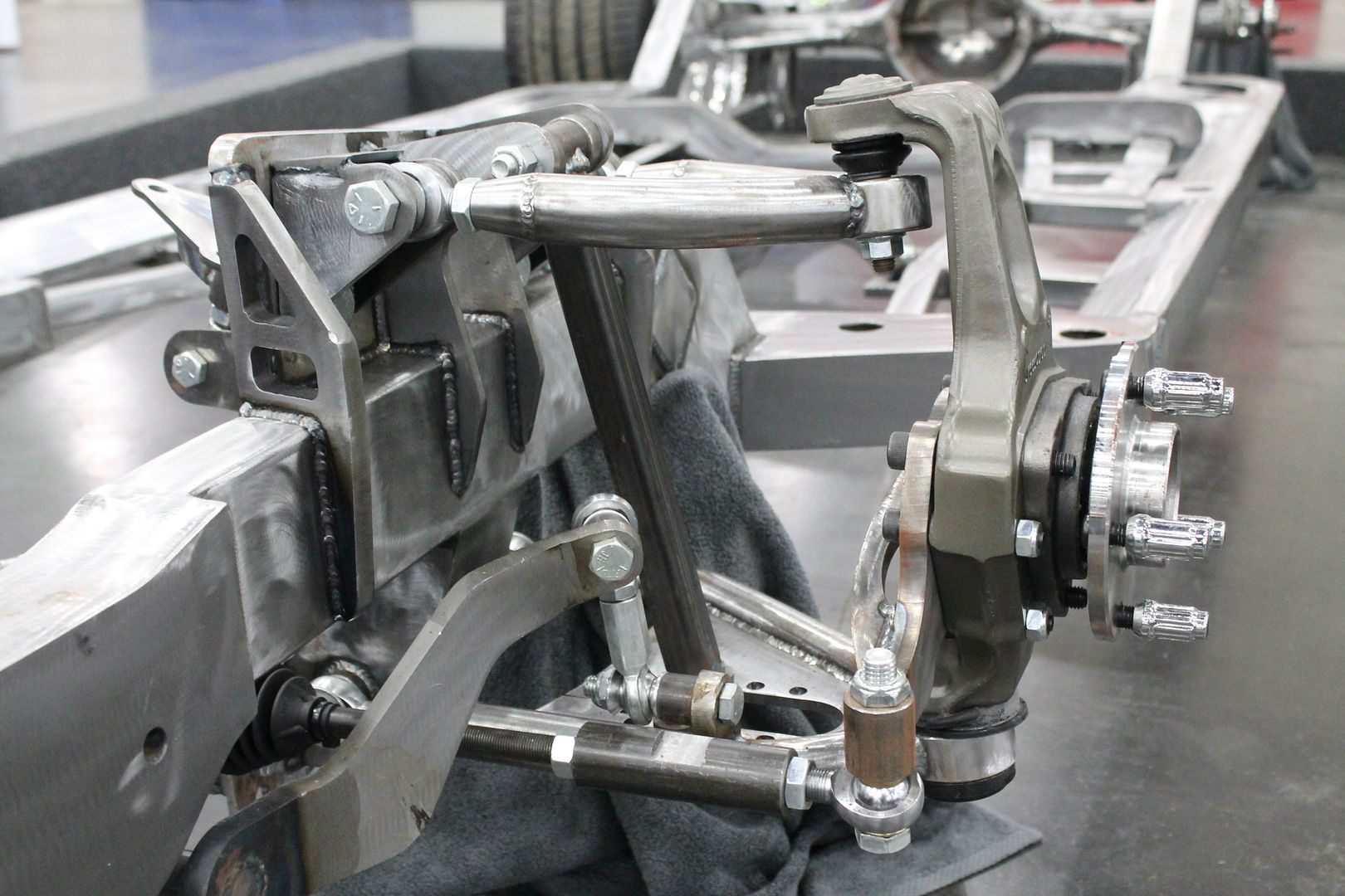

This is the Chassis that Street Rod Garage built for us. The rear frame rails have been moved in to allow for the larger tire. We used their Evolution front suspension and a triangulated 4 bar on the rear.
We also will be running the Ride Tech Remote reservoir triple adjustable coil overs
