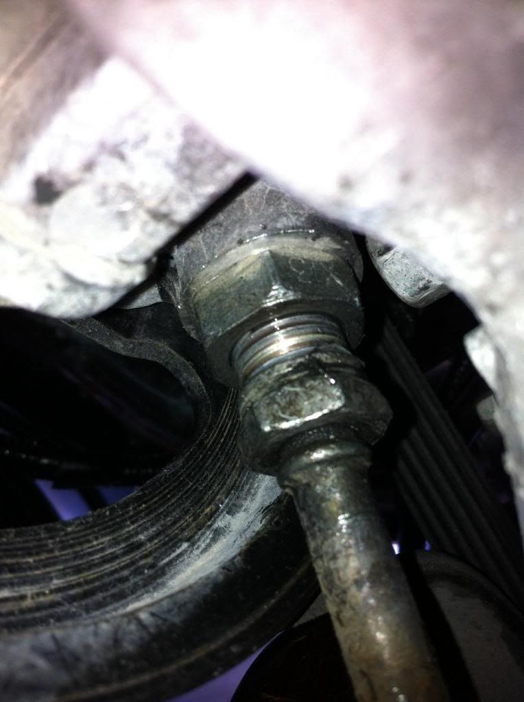

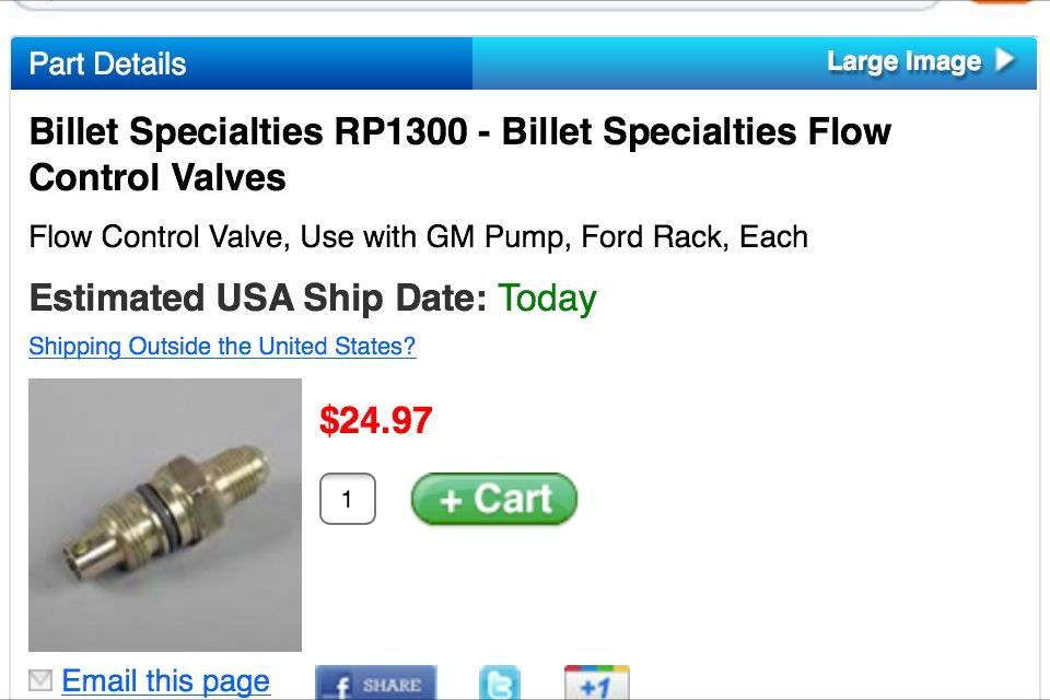

I received the Billet Specialities 2 GPM flow control valve , and yesterday spent a couples of hours trying to install the fitting. I started to untighten the high pressure Power steering line fitting and noticed it was a male flaring fitting that is connected to the GM control valve,which is different than the Billet Specialities that has the threaded male connection.
Does this mean that I need to change the male flaring fitting on the presssure line or the BS valve I ordered was not the right valve for the application since it has a different arrangement than the existing one I have?
I am totally confused and appreciate your input guys.

I guess I ordered the wrong flow control valve. I should have ordered the Detroit Speed flow control valve instead of the Billet Specialities one

Most of the aftermarket outlet fittings like what you bought are -6 AN fittings. Hydraulic shops call them JIC fittings. The flare angle is 37 degrees. Normal automotive fittings are 45 degrees.
The DSE fitting is likely to be a -6 AN, same as what you have.
What pump are you using? Is this for a Mustang Rack?
