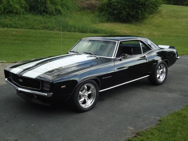

I've recently just bought (spur of the moment purchase) a 98 vette LS1 with 21k miles on it complete with front accessories for a future swap in my 69 Camaro. It currently has a GMPP fast burn 385 with 5 spd TKO 600 and a moser 12 bolt posi with 3:73's
I've been reading so much on these boards I'm abit overwhelmed
I have LS overload....is there someone on here that I could refer to via text or phone? someone that knows exactly what needs to be bought that works in a 69 Camaro? I mean the only thing I know for sure is that a tanksinc tank set up works fine (around $550 total shipped)....and I'm going to use a cable throttle body to keep it simple....and a 411 computer for easy tunablilty, besides those things, I'm lost
my motor has two fuel lines coming from the fuel rails, and perimeter valve covers, so its a bit of a bastard year I guess....just my luck
here's a few pics of what I got
