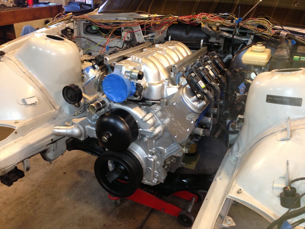

79 Camaro 79 Camaro is offline
Join Date: Apr 2008
Posts: 143
Thanked 7 Times in 4 Posts
Resized pic
Old 03-06-2014, 06:37 PM
Join Date: Apr 2008
Posts: 143
First fit.
