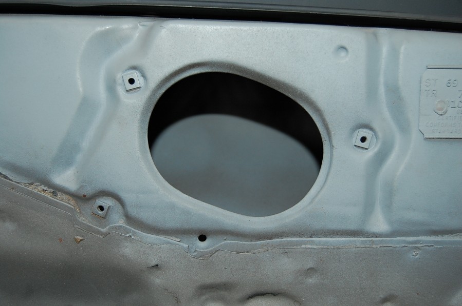

67 has a different mountint pad on the fire than 68-69. I think the only difference in 68 and 69 as far as the kits go is the headlight knobs that come with them. more interesting the the 69 Firebird also carries a specific part number as well.

Not saying your wrong about the mount because I only have a 68 in front of me, but could you verify that for me? I have access to a DSE 67 kit and don't understand the reason for 3 different motors unless it is due to the wiring. Some 67's have three wire and others have four. I can get this one at a really good deal and would love to be able to snatch it up

Guess the real question is, can the 67 kit be used on a 68.

The hole in the firewall on a 67 is a different shape than 68-9

Okay. The hole is different but is the bolt pattern the same. With a DSE kit the plate just bolts up and the face of the motor makes no difference because the actual motor they use is the same for all

hole and bolt pattern is different
