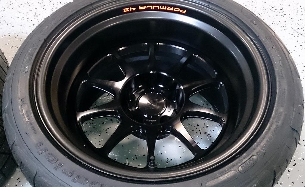

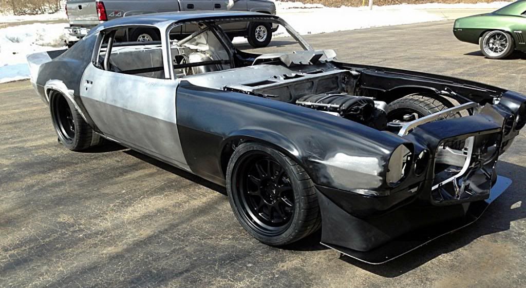

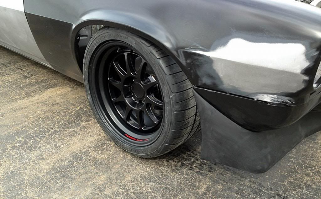

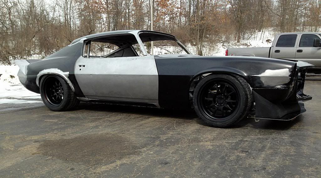

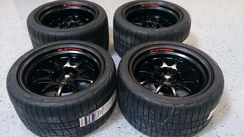

Joe and Paul at Dutchboys Hot Rods have been busy this winter building PT cars. Here are a few photos of Paul's new 2nd Camaro project he started last fall after selling his Chevy II. FORMULA 43 worked with Paul on a very aggressive tire and wheel package.
Front = 11.0X18, w/ 315/30-18 BFGoodrich Rival
Rear = 12.5X18, w/ 335/30-18 tires BFGoodrich Rival
Wheel Style = RAD 10
Finish = Black anodized center sections with powder coated autobahn satin black outer and inner rims with F43 red reflective race decals.
Paul is going to build custom inner fenders on the front and also add a small flare front and rear to help fully clear and cover these monster steam rollers.
Looking forward to seeing this Camaro finished and on the track!

Wheels are great as usual. I love that front splitter.

We built a 6.25" front and a 5.75" rear. This wheel and tire fitment requires extensive modifications to properly fit.
