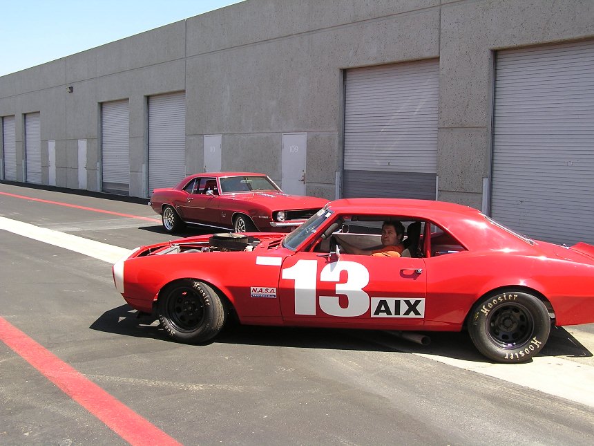

Real quick, a couple of fun pics...
Yes, I am wearing an EZ Wider shirt in that picture. Most appropriate for the amount of smoking that went on about 10 seconds later!
Bonus points if ayone can identify the red '69 in the background and the location of the photos.
