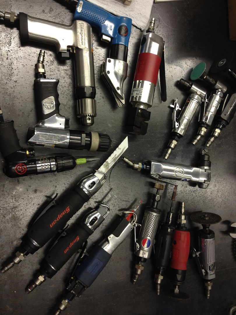

So I went out to look at my air tools and see if I could not only help you - but anyone else reading this stuff....
I have quite a variety as it turns out! Brands and where made! USA - Taiwan - China - Japan.... the order of QUALITY? USA - JAPAN - TAIWAN - CHINA

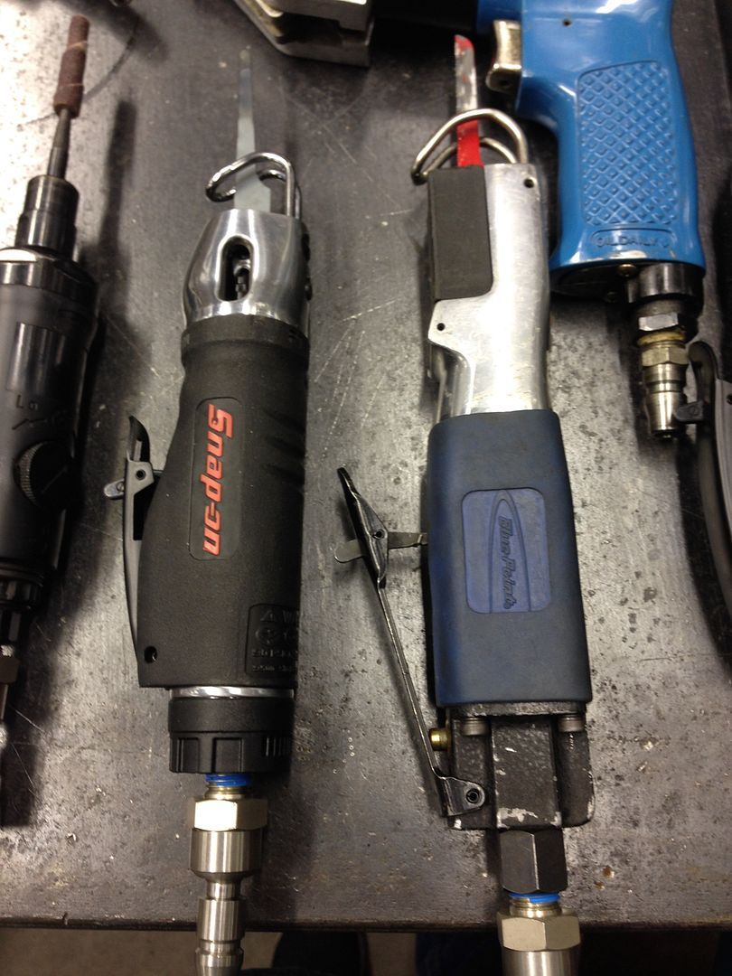

NOTE THE THREE BODY SAWS ----- ONE IS JUNK ---- THAT WOULD BE THE BLUE POINT from Snap On. This is a tool that requires some torque... the BP has NONE.
The Snap On is three times the tool for 50% more on the price!

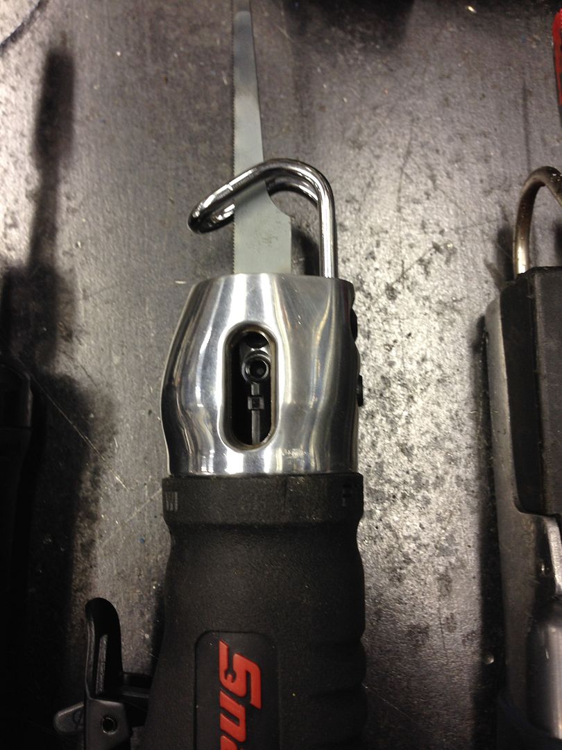

Here's the OTHER HUGE DIFFERENCE --- The BP tool requires a screwdriver to first undo the cover flap --- with a little teeny tiny POS screw that always falls on the floor where I then have to find it! FT! --- NOTE the SNAP ON tool has side access directly to the blade for changes. You change these blades A LOT!

Some are cheap ass junk and the most used version would be the SNAP ON.

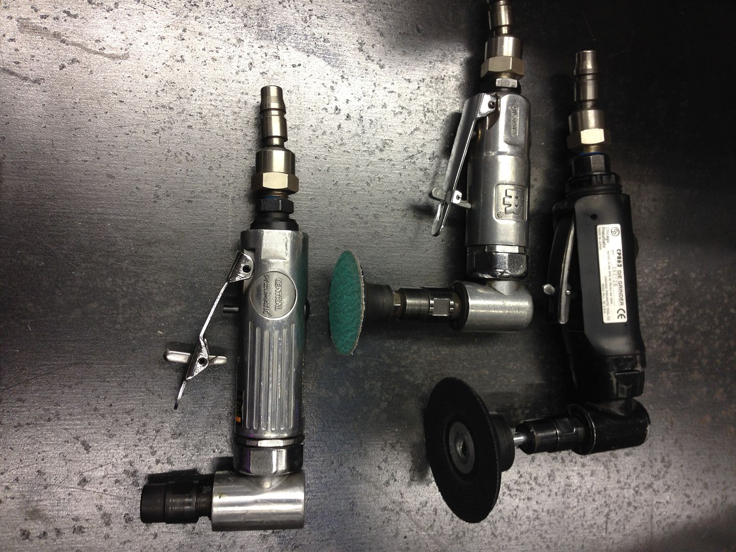

There is a cheap ass HARBOR FREIGHT angle there --- note that it has no arbor in it... I own like 4 of these... they're $14 a piece! Use it - toss it if it quits working. NOTE there are 2" arbor for the disc and 3" ---- you need both. Easier to buy a cheap HF tool and have them set up with different arbors.

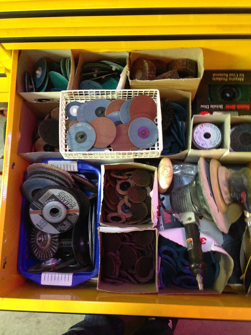

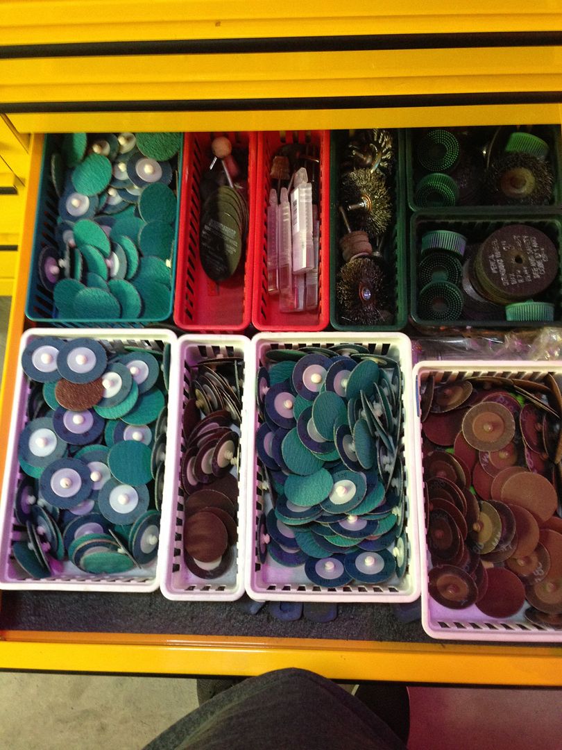

BUY THE CONSUMABLES IN BULK!!! This stuff is meant to be used up! Don't waste your time and effort trying to get another 5 minutes out of the disc! Toss it and grab a new one!

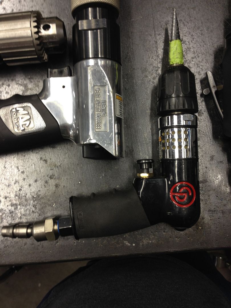

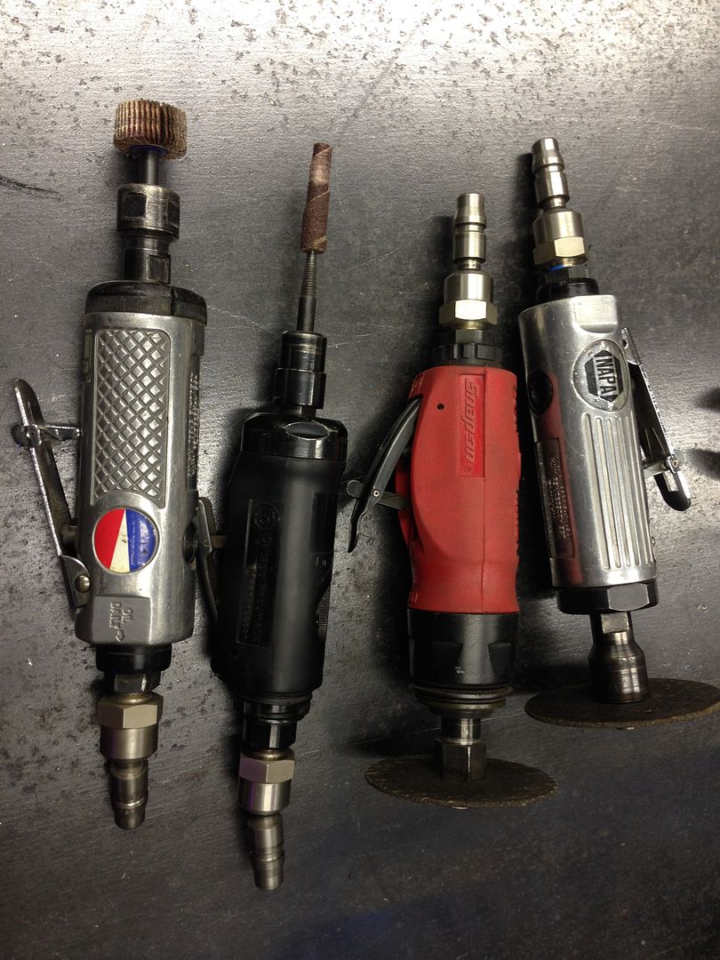

THE HANDIEST TOOL NEXT TO THE CUT OFF WHEELS!!!
This handy dandy little air drill (reversible!) motor.... Quick change collet... fast - efficient - gets into tight places...
