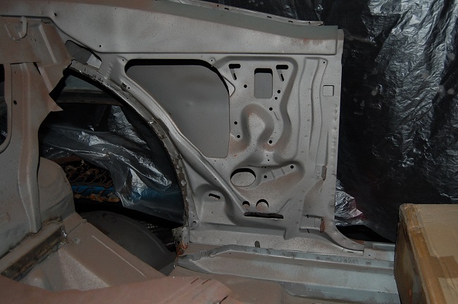

Does anyone know of a place that makes or sells replacement sheet metal for the rear window regulator area. Someone proceeded to cut out this area on my car and i need a replacement.
Below is a shot of the perfect passenger side that I have. The driver side is the one cut out.
I was able to find a complete piece like the one in the link below but paying 400 for just that piece seems really steep.
http://www.heartbeatcitycamaro.com/s...967-1968-1969/

put up a picture of the drivers side section, we are gutting a 69 right now and you may be in luck.

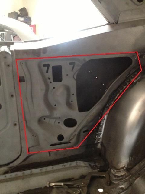

Hi Vince
Here's a picture of what were missing let me know if you have any parts that would work.

on the door jam, is that all the way to the lip?
you can weld right?
i'll take a picture of what i can get you.
vince
you can weld right?
vince
Yeahs it's to the lip.
My car is at a shop right now getting welded and he's really good. Originally he wanted to do a flat close out panel and pin the windows but I want more function than that. The hardest part is all the grooving for the regulator mounts.
Let me know what you have.

this is what i have but i'll have to leave some room for the bonding strips for the differential cooler mounts.
