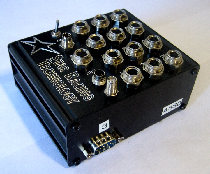

I am a big fan of the Race Technology Data AcQuistion systems. When we shopped for DAQ (Data AcQuistion) systems for my race teams at the end of 2005 ... we looked at all the brands. Budget was a concern, but functionality was tops. We for sure wanted a GPS satellite based system. After comparing over a dozen brands, we narrowed it down to Race Rechnology & Racepak (owned by MSD). I bought several RT DL-1's to install in our race cars back for 2006. (See first photo at bottom of page.)
We loved the software, loved the system functionality
... hated the way the sensors wired to the brain box. For our purposes ... and we were running the systems at the track 40-50 days a year ... the wiring connections wouldn't hold up. They kept breaking & failing. We loved having data ... hated not having data when the wiring connections broke. We would send them back to be repaired ... which they did for free ... but we were racing without the units.
So my engineers designed a new box (see 2nd box with our Star Racing Technology brand on it below) ... with high end sensor connections ... and we bought motherboards & software from Race Technology. Worked excellent. No more failed sensor wiring connections. The RT software & brain were already top notch.

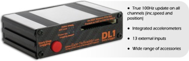

Race Technology has upgraded the sensor connections in new models. I have not run the new version, but it looks to me like they solved the connector issue. You can see where they made the improvement HERE.
Pros:
I feel the Race Technology DAQ systems provide all the data you need ... with fast processing speed & robust memory ... in a software that is easy to read & tailor ... in a VERY affordable package.
Now they have better connectors and should trouble free for the life of the unit for most users. Other updates include syncing with your GoPro camera to show video side-by-side with the data. See it HERE.
Cons:
If you want to add sensors ... like throttle, brake, steering, shock travel, etc ... you need to wire them up yourself. Not a big deal, but you need to get the wire, attach connectors, etc. Also of note, we did not have good success (inaccurate & inconsistent results) with their shock sensor. We switched to Penny & Giles linear potentiometers (shock travel sensor) and had great accuracy & repeatability.
The tech support is ok. The US importer Al Siem is a good guy, helpful & knowledgeable about the product. IMHO Al has minimal field experience using DAQ with racers & race teams. So don't expect him to guide you on what the data means for you.
